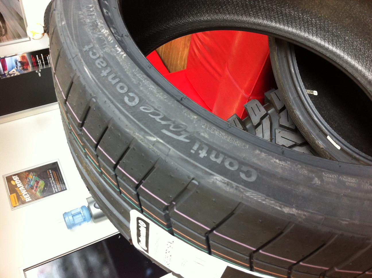

I went with Conti DWS 255/35 and 275/35 and shipped to Australia was $1100. The wet weather grip was phenomenal and during the deluge on 2014 German Car Day I was able to drive the car through puddles confidently while a couple of AMG were fishtailing. Amazing! Since I have two sets the DWS are mainly winter tires and I have just swapped on to my OEM 18 for the summer. 255 and 275 on competition wheels have no rubbing issues with stock suspension.
<a href="/beta/attachment.php?attachmentid=1100253" class="lightbox-trigger" aria-label="View Attachment"><img src="/beta/attachment.php?attachmentid=1100253" attachmentid="1100253" alt="Attached image" class="attachment_image" loading="lazy" /></a>
speak of Contis....
those apparently arent too bad also. Conti Force Contact, available locally in australia.

I run these on my GT3. I get about 9,000kms out of the rears without a track day and the fronts have done about 13,000 with a track day on them and still have about 1/3 life left, so I expect they will all wear out together now.
I think they do heat cycle out a bit, when new the grip was phenomenal but after a while they didn't feel quite a good, more like a normal road tyre.
They are a good tyre though for a Semi-slick, with a UTG rating of 80. I think I will try the new Michelin Pilot Sport Cup 2 next time though as they are still a semi-slick, but have a higher wear rating of 180.
