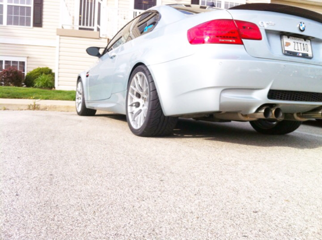

you got any pics? thanks! :thumbsup:
here u go, I'm currently on my winter sets.
Zzhou wrote
I use AD08 295/30/19 for my rear ZCP. went though 3 sets already, perfect looking and awesome grip on the track. AD08 has a 90 degree side wall which will not stick out like PSS IMO.
What do you mean when you say they won't stick out like the PSS? It's hard to tell from the pics but it seems the AD08s are more square and 90 degree as you mentioned. I always thought the PSS would stretch in slightly.. I have no experience with either tire/size but I'm looking into PSS in that size so I was wondering.

For me, I like the look of the 90 degree side wall. And I do drive this to the track. If your main use is for the street, go get pss, Ad08 sucks in the rain
