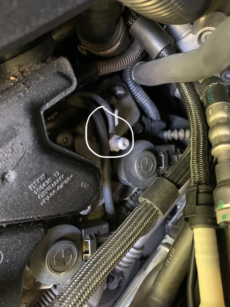

How do you remove this part? Driver side
Just wrench it and turn??
Mimmer wroteYes, box wrench or deep socket.How do you remove this part? Driver side
