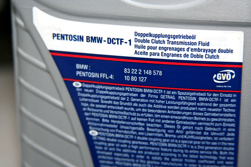

BzsBimmer wroteYes, factory fill is Pentosin FFL4. You don't need to use the BMW stuff -- they just have Pentosin slap a different label on the FFL4 bottles and double the price.Isn't the Pentosin what BMW uses?

If in doubt, just check the spec sheet and make sure it says that it meets/exceeds BMW DCTF-1. The specs on all of the above oils I listed are virtually identical to OEM, though Red Line is about 15-20% thicker.
I know for a fact you can get Pentosin FFL4 from auto parts stores, they just have to special order it. The Motul stuff is fairly easy to get from speed/tuner shops too.

roastbeef wroteNo you won't. All of the aftermarket fluids are basically identical to the factory Pentosin stuff (viscosity is within a few %, as I mentioned above). The transmission and computer won't know the difference.The M-DCT is also self-adjusting and doesn't need to be recalibrated all of the time like the older SMGs did.i knowredpriest is using non-oem fluid. i forget which.
