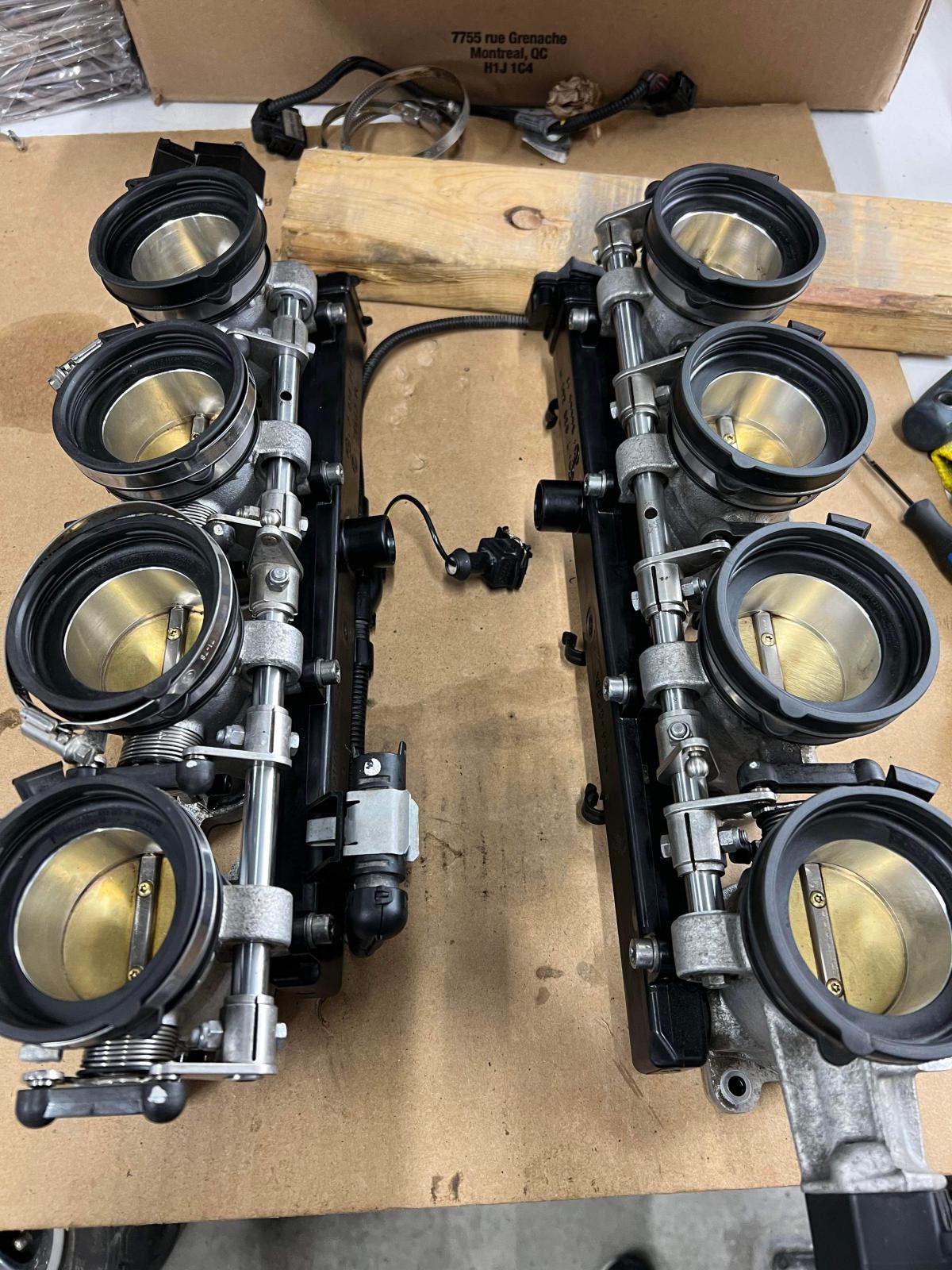

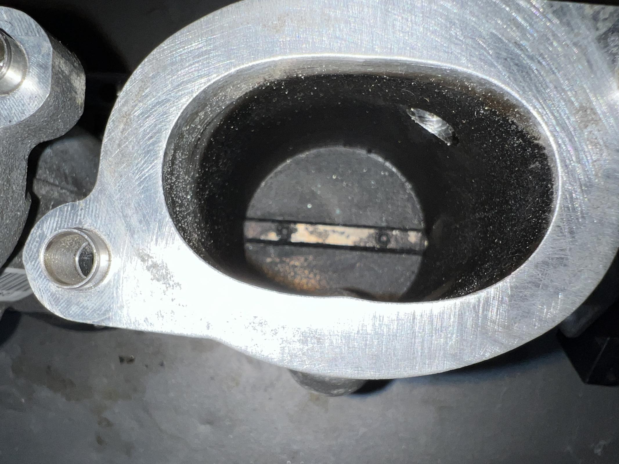

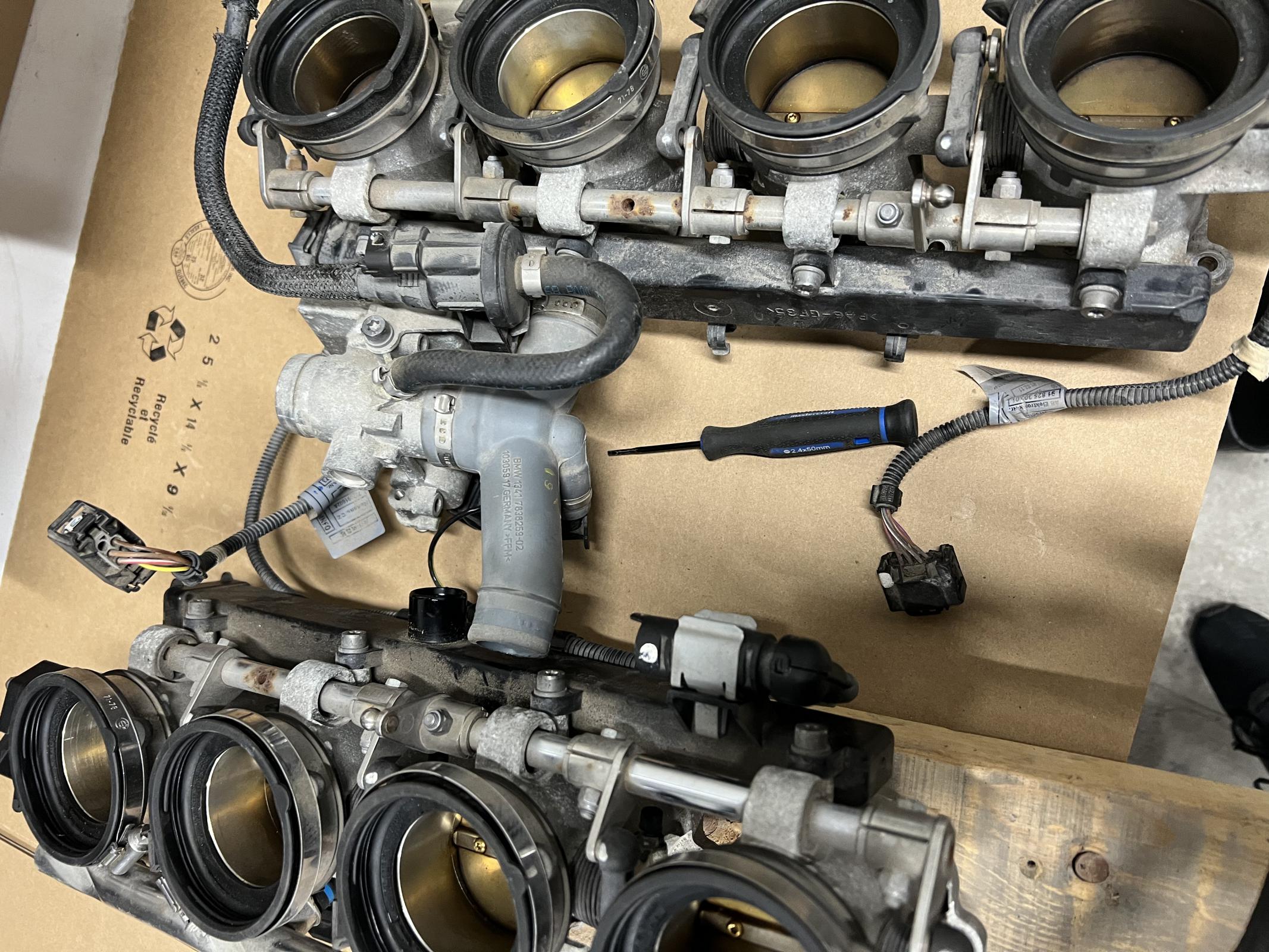

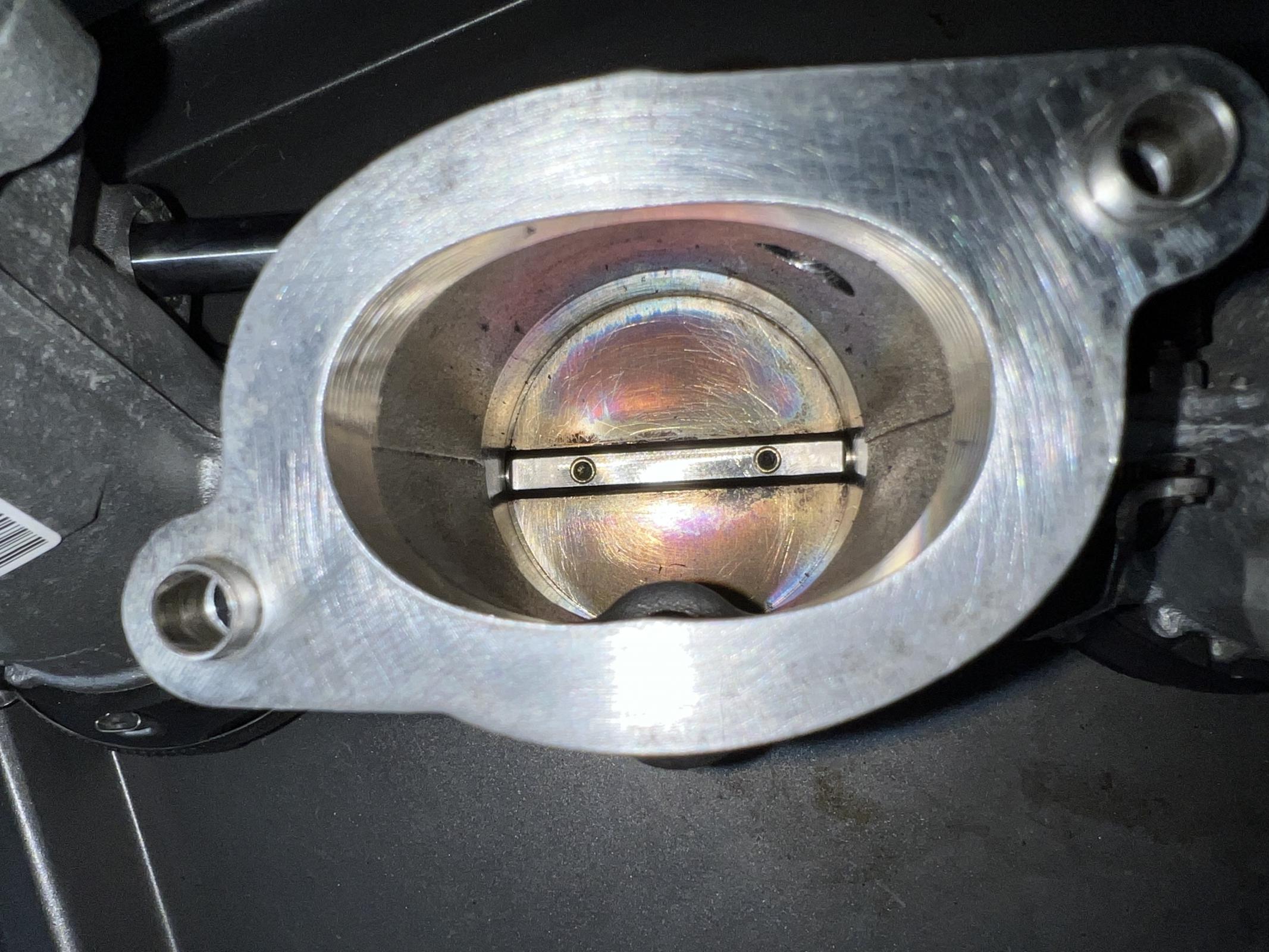

Mines since my engine is on the rebuild side. Before and after
