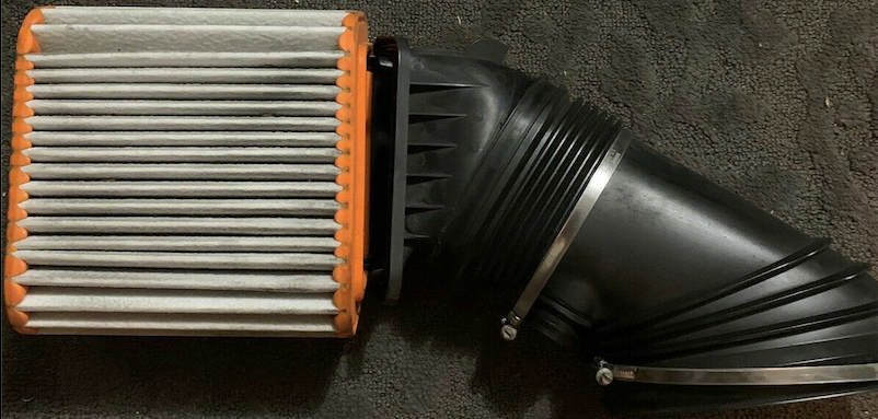

Looking for a few weights if anyone has them or has a postage scale handy. I like to keep a spreadsheet to track every little weight loss or gain down to the fraction of a pound mostly because I just enjoy the process. Unfortunately my M3 came modded so I am missing these parts to weigh and I'm hoping to avoid buying stock stuff just to weigh. To pay it forward I'll also share some weights I've taken.
Need weights on:
- Stock intake elbow complete with hose clamps all the way to the filter itself (as pictured)
