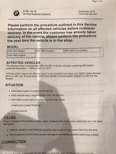

It is not an official recall so it doesn't show up in the system as such. And it is limited to production dates from December '09 to April '11. This is the SIB my dealer showed me covering my Sept '10 car...
Thanks for uploading the bulletin.
I am not affected (2013 MY). This looks like it would also cause faster discharge of the battery. The battery Power management and monitoring IC will detect the short and disconnect momentarily but never instantly, this could hurt battery life.

My E90 was built during those dates. I'll call the dealer tomorrow.
