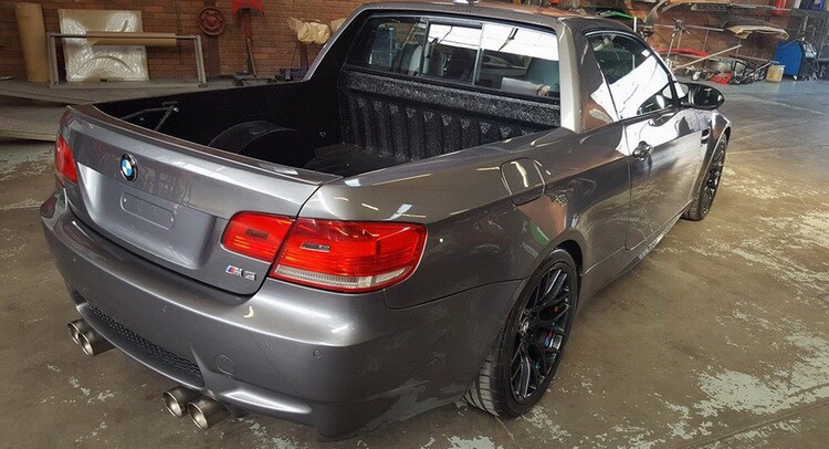

SYT_Shadow wroteSpeaking of which, member ChrisChan just loaded this photo of his car on his bumper thread. Seeing is believing...DSilk wroteDefinitely... but that opens the world up for awesome things like a E91 M3!!!True, but you would wind up spending a lot more than a factory-built M3 would cost, not necessarily have the same reliability, and certainly not have the same market value.
BOOF-M3 wroteI remember in an interview bmw would use that as a truck to hauls parts aroundSpeaking of which, member ChrisChan just loaded this photo of his car on his bumper thread. Seeing is believing...
Munichm3 wroteThat was then, this is now. ChrisChan got himself a hold of that baby. And after all doesn't everyone believe everything they see on the internet? I do.BOOF-M3 wroteI remember in an interview bmw would use that as a truck to hauls parts aroundSpeaking of which, member ChrisChan just loaded this photo of his car on his bumper thread. Seeing is believing...
