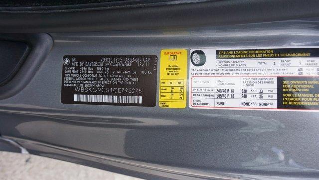

Does anyone know what the recommended tire pressure for 255/40/18 Square is?
The OE Pressure for the factory 245/40/18 is 33 PSI and the OE Pressure for the 265/40/18 is 35 PSI as seen on the door jamb picture, below. I imagine running 35 PSI would be perfectly fine.
I run a good old 35 on all my street cars, front and rear. May not be ideal but it's close to correct and very easy to remember
Thanks, my doorjam only showed 19" PSI that's why I didn't know what the 18" pressures were.
