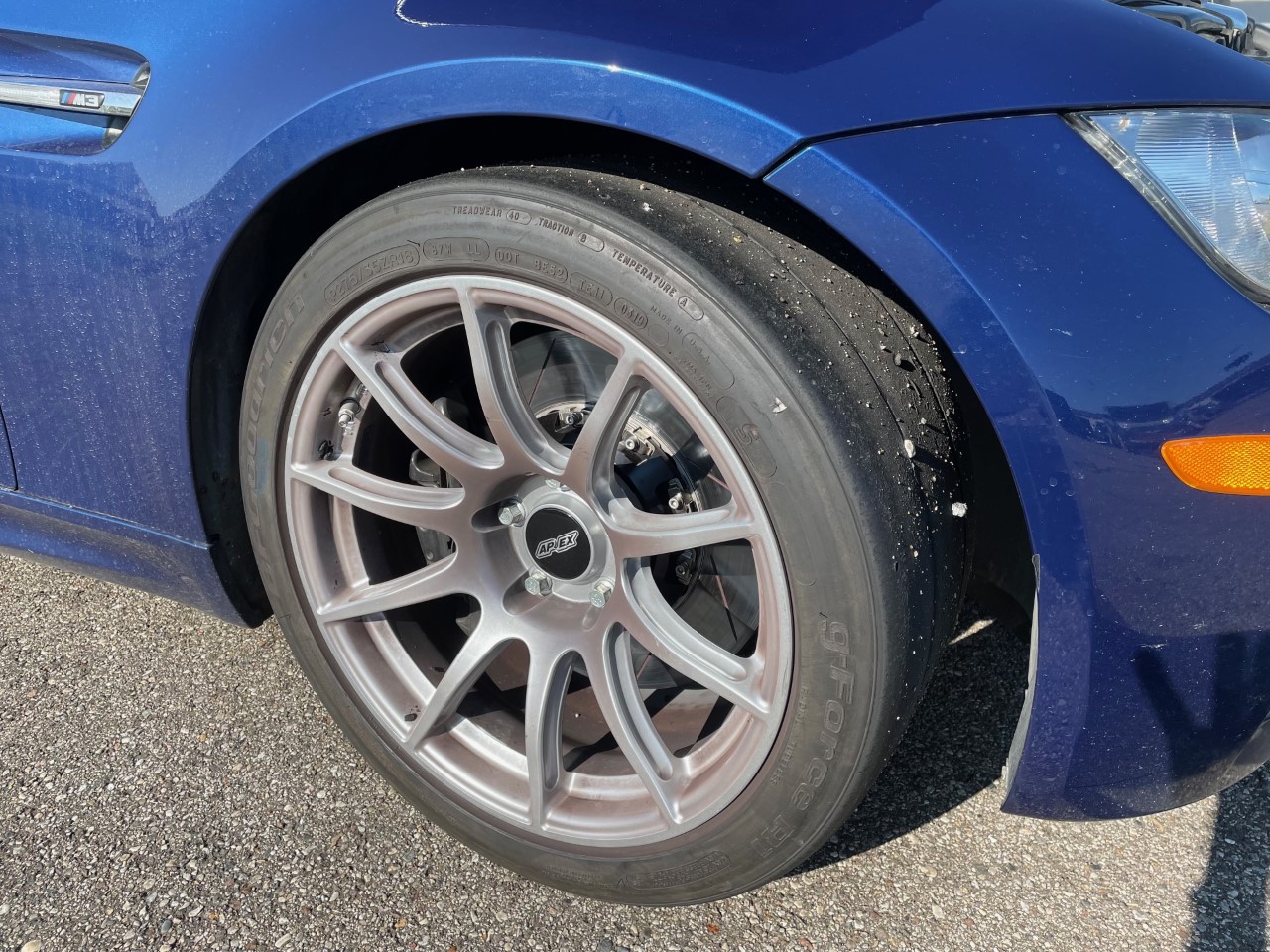

I have the FC conversion on my E90 track car paired with M14 Bimmerworld race studs.

For a quick update, I received the F80 hubs. The 8 bolts I ordered are only for F80 spindles and the original bolts are wrong thread. The original are M12x1.50x60mm and these hubs require extra fine M12x1.25 bolts. Therefore I bought top quality 10.9 hardness bolts at my local HW store which specializes in bolts.
In short, for two F80 hubs on E92 spindles you need 8x M12x1.25x60mm bolts, with 10.9 hardness highly suggested. Perhaps BMW sources such a bolt, but I don't have the part number nor even the application.

For the front, just the OEM hubs and the bolts I mentioned are needed. There was nothing to drill or modify. Neither the stock nor the Turner Motorsport rotors had to be drilled.
There is no change to the wheel offset that I noticed. For the track I have the Apex SM10 18"x10" ET25 wheels with 275/35-18 tires and they fit with no rubbing. I think that is about the max size you can put on these cars with stock suspension.
Certainly no change to the rotor offset and therefore no change to the caliper location. Brand new pads fit fine.
