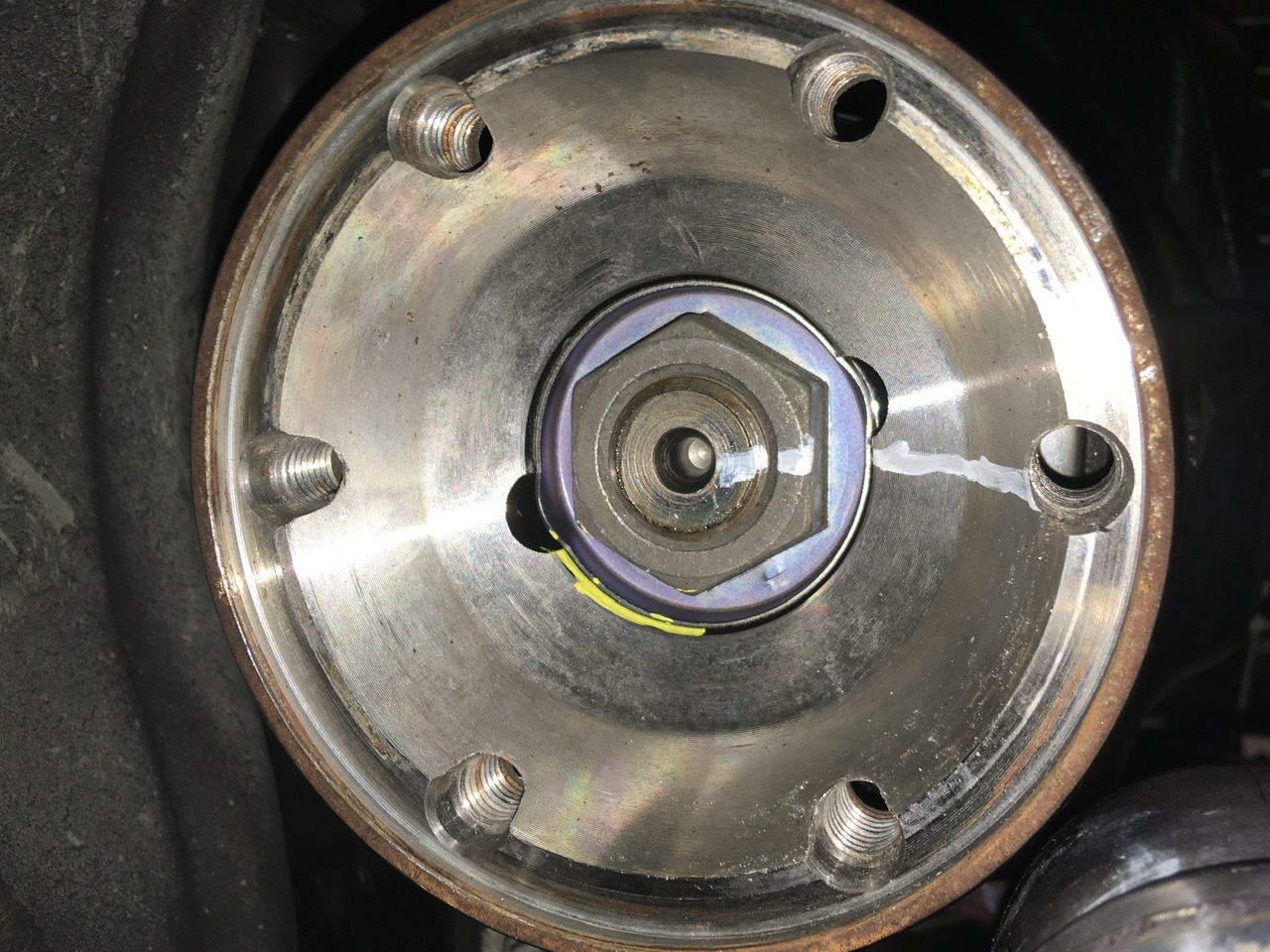

After the bearing job, the pinion seal swap shouldn’t take you much time at all. I replaced the seal while waiting for oil pick up tube bolts. Get a seal puller and a Miller Pinion Seal Installer 8891 (Bought one for $10 on eBay). Mark the flange nut and a new pinion nut retainer.

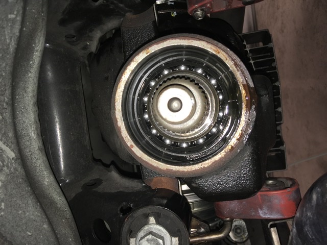

Nice pictures, Bubbles, thanks.
Thanks for reminding me of the DIY, pbonsalb, along with M43S7RO who posted it before.
