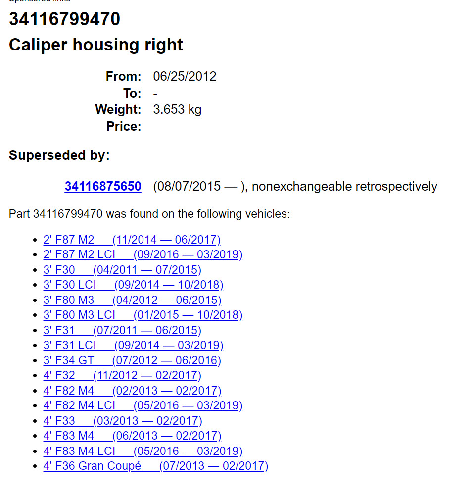

I have the opportunity to purchase the below front calipers off of a 340i owner for $600 for the set. Owner says they are 370mm variant. I have read elsewhere on the forum that these can be retrofitted to the e9x platform relatively easily. Does anyone have experience with this? What parts/rotors will be needed? Is the increase in braking power worth the effort?

The calipers are the same as F80 ones.
I believe it's only the pads the are different that allows the use of f80 380mm front rotors.
