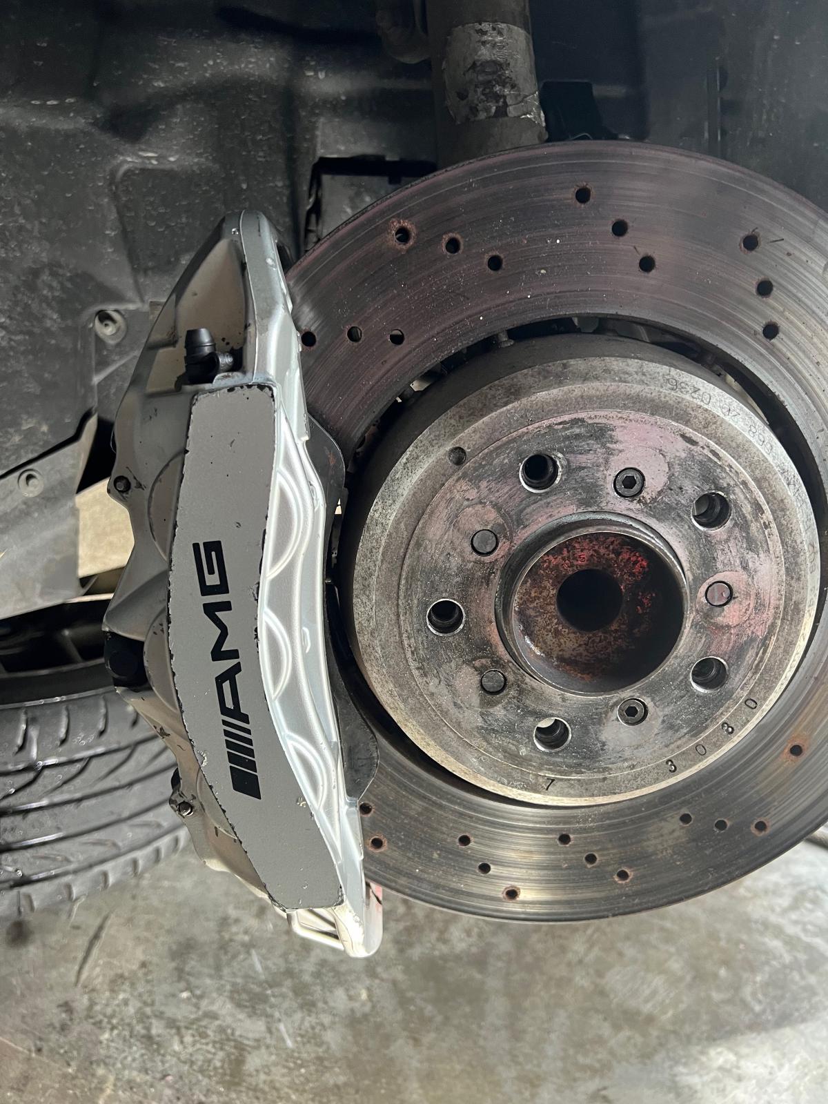

You can do the freaky brakes Brembo caliper upgrade as I mentioned in another thread. Paired with OEM rotors, it adds significant cooling ability. At under $1k, it is a good budget upgrade.
Can I ask how a caliper upgrade adds cooling? All of the cooling is done by the rotor which isn't changing.

Heat capacity is your friend too, my friend. max 20-30min for a HPED section the brembos and stock rotors can take it all . You can also upgrade to tge f80 rotors
Girodisc rotors with oem calipers is a better upgrade.

The rotor does most of it for sure, but not all of it. Some heat rejection is done through the caliper. Pads get hot, too, and some of that heat ends up in the caliper. Bigger caliper means more mass to absorb heat (less temp variation in the pads) and/or more surface area to reject heat.
AFAIK, heat capacity/rejection is the main reason optional carbon ceramic brakes often have bigger calipers than non-ceramics; the rotor doesn't absorb as much heat as a metal one would, so the caliper has to pick up some of the slack. It's also why brake fluid heat tolerance matters; if all the heat rejection were done by the rotor, it's hard to imagine why anyone would need more than DOT3.
Can't imagine swapping in bigger calipers on the same brakes would be a game changer heat-wise, but it ought to help a little.

As others have said, heat is dissipated by the caliper as well. Pads get hot which transfer to the pistons and into the caliper body. Pads and brake fluid overheat which causes brake pad deposits, warp rotors and brake fade on track. The caliper acts as a giant heatsink. That is why a lot of high performance brake calipers are so big while the actual pads and pistons are not as big.
The stock rotors last for years of track use with proper pads and cooling. I only need to replace them once every dozen track days or so even with stock calipers. I don't know what you're doing to fry rotors as much as you are.
