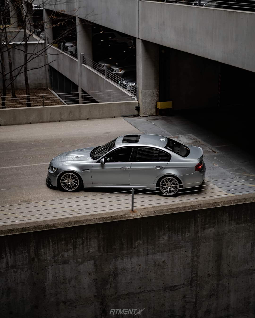

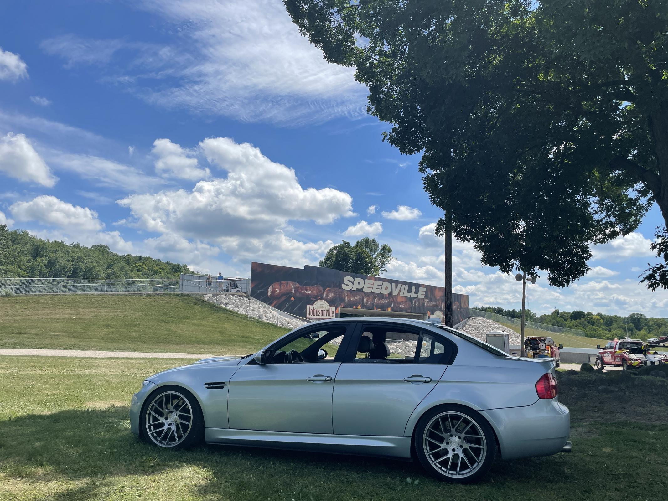

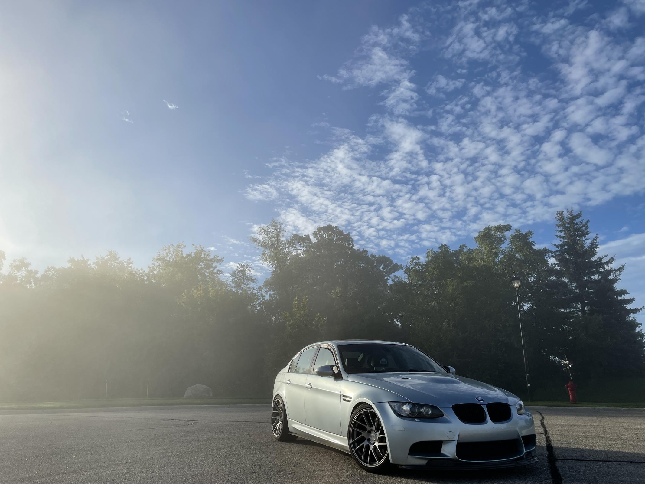

Sorry for the delay! Looks like I don't get notified when I get tagged. I've put about 6,000 miles on these coilovers and I absolutely love them!
I had the car corner balanced earlier this spring and after I got it back I did a little tweaking to the recommended low/high speed compression. I have it set on the lower end of the recommended height range and had some low speed compression scrub on my test road. Taking a mid-sweeping right turn there is a dip in the corner so with the left side loaded up I was getting the wheels hitting the fender liners for a brief moment. Adjusted my low speed compression a few clicks stiffer and fixed it! I also have the high speed set about 2-3 clicks stiffer. Rebound is at the recommended setting.
With all that I can say that these coilovers are phenomenal! My wife doesn't complain about the ride and I've convinced a few friends and co-workers to buy ST after going for a ride in my car. It's more comfortable than stock and gives me more confidence than stock/stock+H&R springs. Over the warmer months I'll frequently drive the car up to our offices in Appleton, WI which is about 230 miles round trip with a mix of highway, backroad and county highways and I couldn't say enough good things about the car. Expansion joints that have made me cringe in the past aren't even an issue.
We have some roundabouts near the house and the car corners flat through them with the tires (and public safety) being the only limiting factor to my confidence in handling.
Feel free to reach out directly if you've got any other questions!
Here's some rolling video with the coilovers on
And here's some photo's
