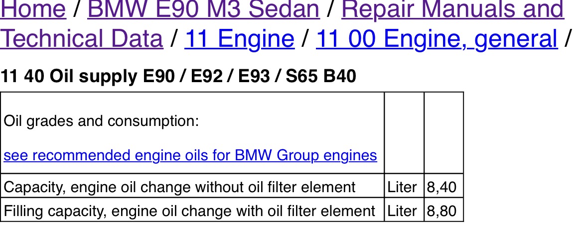

Oil fill according to TIS
8.8L if changing out oil filter
msan wroteThanks! Guess it makes sense that 9L (9.5qt) was perfect since I removed the residual in the filter housing...which from what I've read is .2L.Oil fill according to TIS
much appreciated. thanks!
