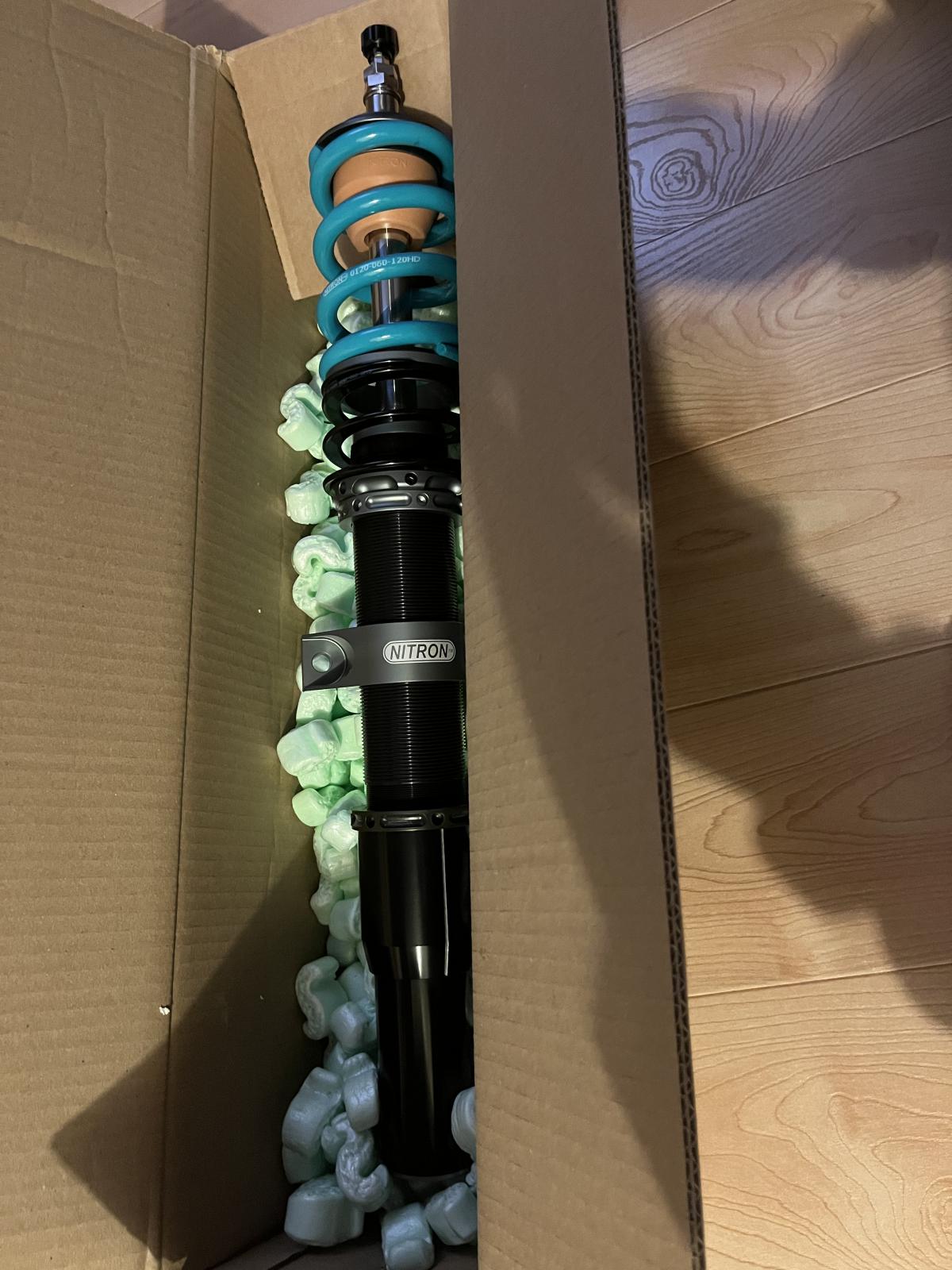

MaximusB wroteThank you very much for the feedback! Glad they worked out so well for both of you on the track - and then you were still able to enjoy the ride home!My friend (M2 Competition) and I (E92 M3) purchased our R1 kit from Jason atOG Shark early this year. I just want to provide an update and a more detail review now that we both have put some street mileage and track use on our Nitron R1 kits.
Car Background
My car - 2013 E92 with EDC. Previous suspension setup was all stock EDC with only Ground Control camber plates. My car is not a daily. At time of coil over install it had 88,000km and about 15 track days in intermediate group.
My friend's M2C - It is a daily car. Previous suspension setup was just H&R springs. Roughly 30,000km but have done over 30 track days in mostly advanced group. His stock suspension was actually on the way out. Rear shocks were blown and bump stops were falling apart in pieces.
Unboxing
Upon unboxing our kits, we immediately could feel the quality of Nitron. Everything is milled out of solid aluminum, so nothing is joint or welded together. The finishing on all the components are of a high quality as well. They're so nice that one might want to display them on a wall than putting it on the car.
Installation
Very straight forward - nothing special or different about them than any other coil over kits made for our respective cars. Everything you needed to complete the install are included in the kit. 100% turnkey solution. We did however, opted to purchase new fasteners from BMW for our install.
Street Use
OG Shark recommended to set the dampers at 4 clicks from full soft. So we both set ours to that as a baseline. On my car, they are more comfortable than my old stock EDC setup. Very compliance, rides very smooth over uneven roads and the odd bumps here and there. Still very stable on spirited drives and on highway. Overall the ride quality is firm, but not crashy or jarring at all. Also there are zero NVH added despite everything is on solid mounts.
On the M2C, my friend said it is also very comfortable for a daily car. He did find that turning up the dampening from 4 to 7 clicks from full soft made the car more comfortable.
On Track
Not sure where to begin, but in short. THEY ARE F**KING AMAZING. My friend shaved a full 6 seconds off his previous personal best. I shaved off 4 seconds. We both did that in only the 3rd session of the day. The only change we both did to our cars since last year was Nitron coilovers. Other than that we used same tires as last year, same everything.
The Nitrons completely transformed the car. We both were able to carry more speed into corners and take tighter lines. Both our cars did things it couldn't in previous years. I had to spend the first 2 sessions of the day just to relearn my car and what it could do now.
My friend is a much faster and experienced driver than me. His M2C is stock other than pads and coilovers. This past weekend, he was keeping with all the Porsche GT cars and was near the top of group A time wise. A lot of people in our A run group complimented him on his driving and were all surprised to learned his M2C is 6 speed manual with only coilovers and pads done to it.
After our track day, we simply turned the dials to soften up dampening and made a 5 hour drive back home in comfort. No fuss or anything.
Over all, very very impressed. Zero regrets with this purchase.
Thank you again Jason for the recommendations and answering all my questions. Would 100% recommend your Nitron kits to others.

Was able to install this past weekend, replaced a set of KW CS that I was running previously. Immediately felt a night and day difference, the comfort level is amazing compared to what the KWs felt like. Canyon performance is fantastic too, I still am going to dial in what settings I'd like to run, but already loving the car even more now.
Jason was great in helping throughout the process, and helped me through every question I had!
