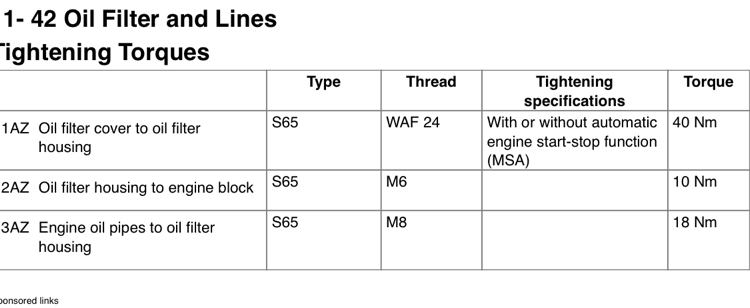

Maintenant, j'ai besoin d'aide pour trouver divers numéros de couple. Quels sont les boulons qui maintiennent le boîtier du filtre à huile pour bloquer le couple? Il y a 3 boulons différents. Quelqu'un a-t-il un modèle de couple aussi?

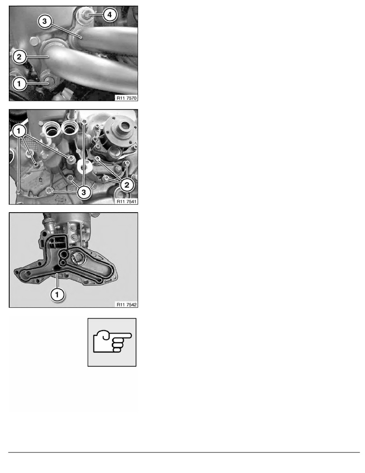

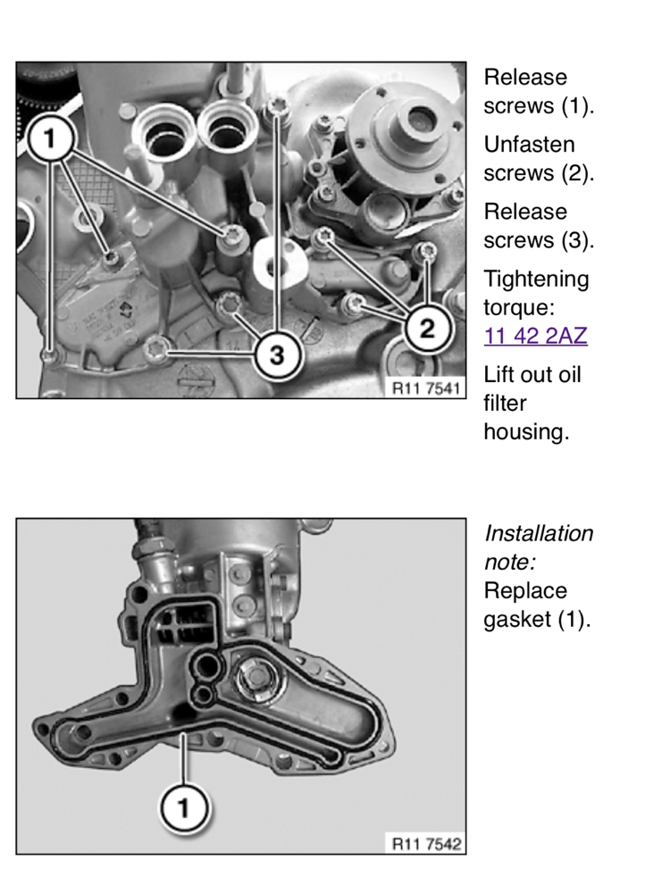

See images
Bmwdoubles_ wroteThank you very much! Where would one need to subscribe/pay to in order to get access to such manuals?See images
Bmwdoubles_ wroteDo you also happen to have torque pattern for the housing bolts? Thank you!See images

If you don't mind that the first torque is different lol
NiBe wroteThat makes sense that Torque numbers are different, since there are two types of bolts M6 and M8 style. Although there are 6 different part numbers for all of the 10 bolts, they are either M6 or M8!You can look here:
