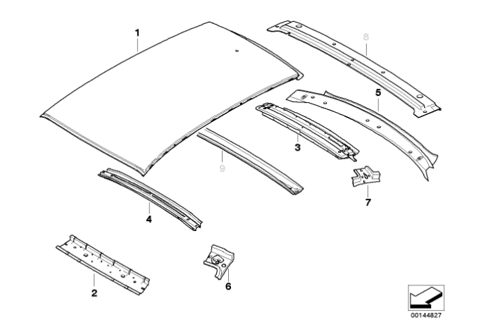

IF your car has a carbon fiber roof the noise 'might' be coming from it. By this I mean the roof is bonded (glued) to the car body roof side rails, the front windshield top spar and the rear glass upper spar. If the adhesive has come unstuck (very rare) then body flexing, or thermal expansion might cause a pop , click or bang sound IMO. Moreover, IF the carbon fiber has a crack the same thing could happen. Has your car ever been in accident? Has the windshield been replaced recently? All of this is just food for thought. If your car doesn't have a carbon fiber roof then I'm at a loss to think what might be causing such a loud noise "from above your head [the roof]"..
https://www.realoem.com/bmw/enUS/showparts?id=WD93-USA-08-2009-E92-BMW-M3&diagId=41_1601
