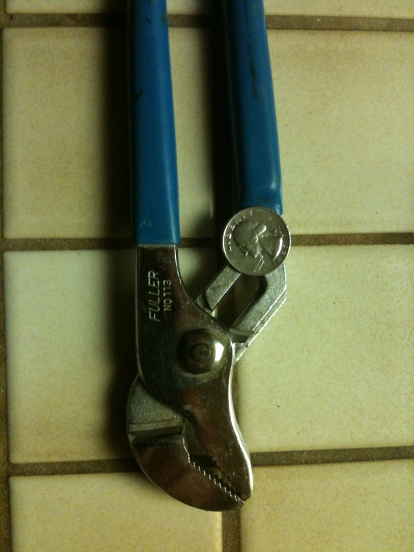

farbarg wroteCan you post a pic of the pliers you used? I want to see how large is large. Thanks.Finally, I second the recommendation to use a large pair of pliers to remove the clips. Wrap them so they don't scratch the brakes, and it makes removal very easy.

A pair of channel-lock pliers. Here they are. I just wrapped the jaws with a few paper towels.

farbarg wroteI have changed the pads on all my BMWs for a many years and have always followed a procedure similar to Lucid's.First, thanks Lucid, for this DIY. I had my dealer put my XP10's on (didn't have time or a jack before my track day), but saved a lot of money by removing them myself. Made me feel like I was mechanically inclined.
Second, my Carbotech's also had excess material in the space where the wear sensor goes. Just had to zip tie the sensor out of the way.

I am unsure why you need a large pair of pliers to remove the retaining clips. I find them extremely easy to remove with a simple semi-large flat head screwdriver: Just place the flat head under the middle section of the clip and push the clip outboard. Comes right off.

FrenchBoy wroteI am unsure why you need a large pair of pliers to remove the retaining clipsQUOTE]
I was the poster that suggested the big pliers. Later on in life, I realized that you could do it with just your fingers. The springs aren't actually that strong (or maybe I just have strong fingers).
In any case, I stopped using tools of any kind to remove and re-install the anti-rattle springs on my stock brakes. Much easier on the paint.

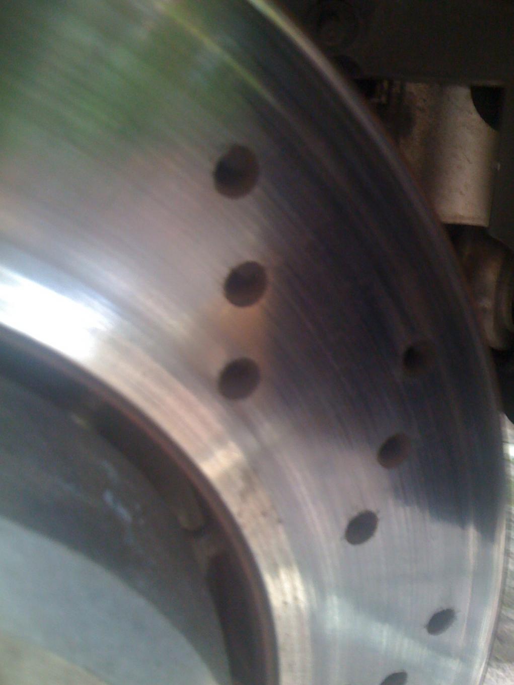

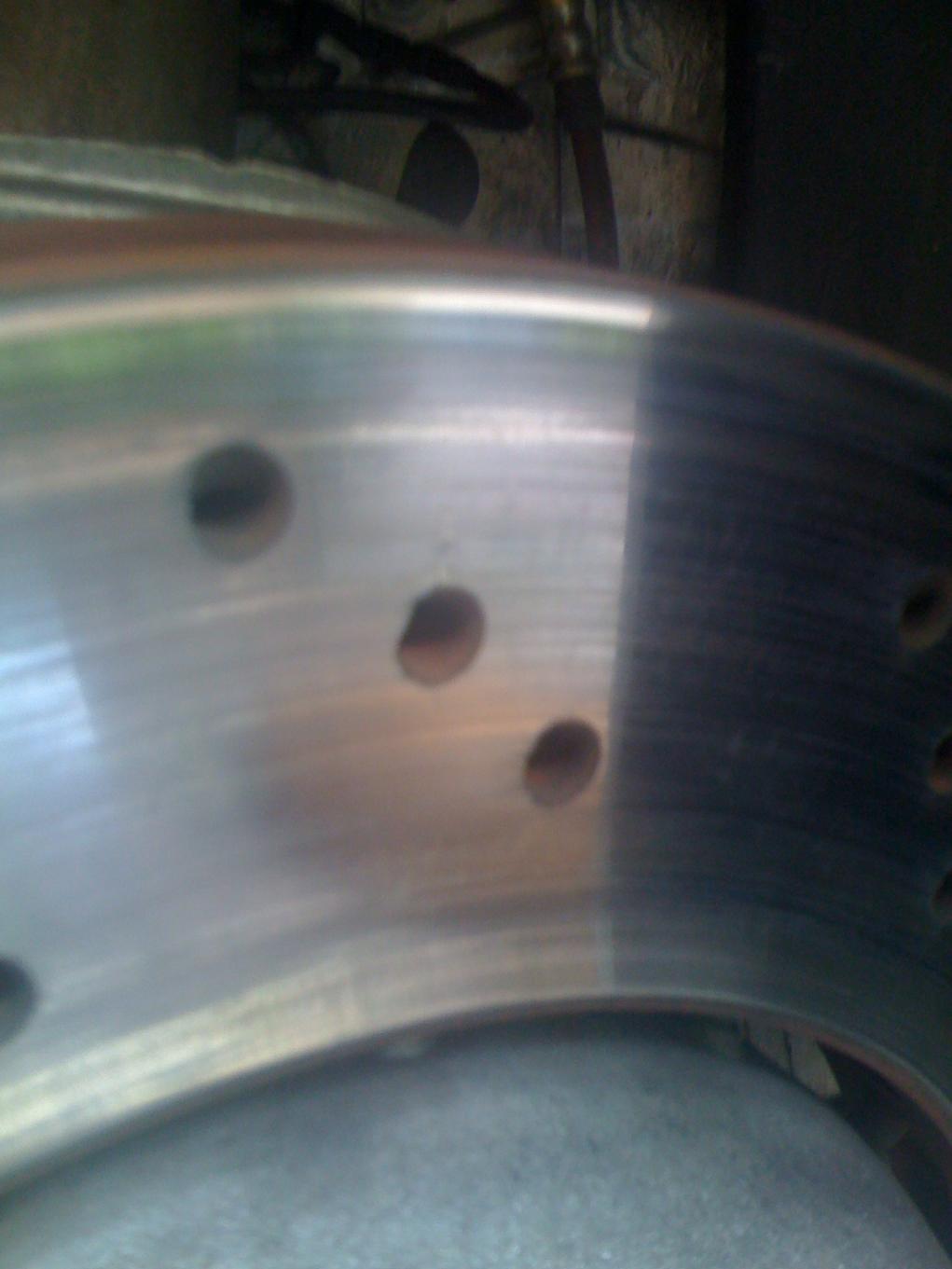

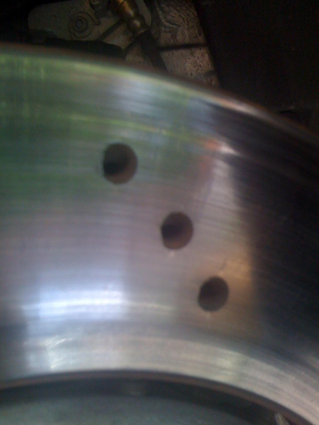

I am attaching a pic of the cracks. They are not deep and I cannot feel a difference in the disc surface with my finger. Rotor depth seems to be ok, a lip is developing but not very deep yet though I have no way to measure exactly.
Having said that, I have had this rotors on the car since new and it has done 6 track days (1 street tires, 5 R-comps) of about 100-140 miles each (on HT-10s first then Pagids) and 6,000 street miles (on stock pads). I am pleasantly surprised at rotor/pad durability so far.
These pics are of my front rotors. I only use track pads on the front, I have found that the rears hold up fine with stock pads and I don't really feel any balance issues.
BMW M Power Mexico wroteThat rotor looks fine to me. The cracks seem small and localized. My rotor looked much worse when I had it replaced. I think you'll get another 4-5 track days on them. Of course, you should do what you think is safe. Just my 2 cents...Thank you as always.
