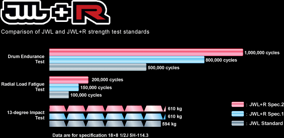

Recently I came across a page on Rays Wheels. Below is a figure illustrating how Rays developed their own standards (JWL+R) on top of JWL.
For example, fatigue testing cycles have been drastically increased. And in addition to the JWL-standard 13 deg. impact test, JWL+R drops a 2200lb weight at a 90 deg. angle from ~5.5". And then the same wheel is used for an additional near 1 million cycles of radial endurance testing :bow:
http://www.rays-msc.com/html/jwl.html

Great info. Ray's JWL+R mimics what most JDM OEMs do already as a minimum. Impressive for an aftermarket wheel company to pony up and do the extended testing. This is a good example on how OEM requirements compare to aftermarket.
