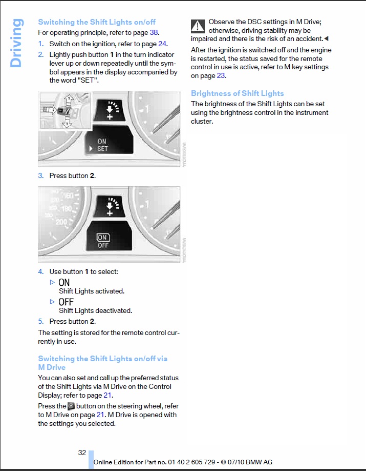

With a DCT car could you get the shift lights to work all the time, just not in M mode? I miss that from my E46 M
Great Question. I miss that in my E46 as well. I see about a half a dozen cryptic settings related to the shift lights in the Cluster ECU. If I figure it out or find a solution I will update the thread. I would like to see it permanently on as well. To my knowledge it has not be cracked yet.

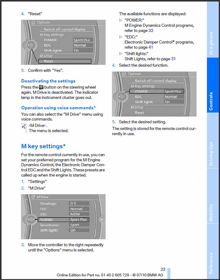

If you have iDrive, you can with the key setting, try this :
http://www.m3post.com/forums/showthread.php?t=458434
shift lights can be turned on regardless via iDrive via m key settings, you just really need to step on the throttle as the shift lights are responsive to which gear you are in and the throttle pressure/speed of rpm build up....
even without idrive, you should be able to simply just active the shift lights with the obc stalk...
Shift Lights
Found it in the Supplementary owners manual. This is the shift light setup via the stalk to change it on the fly. You have to set the M Key setting in the iDrive M Drive menu if you want it on all of the time.
