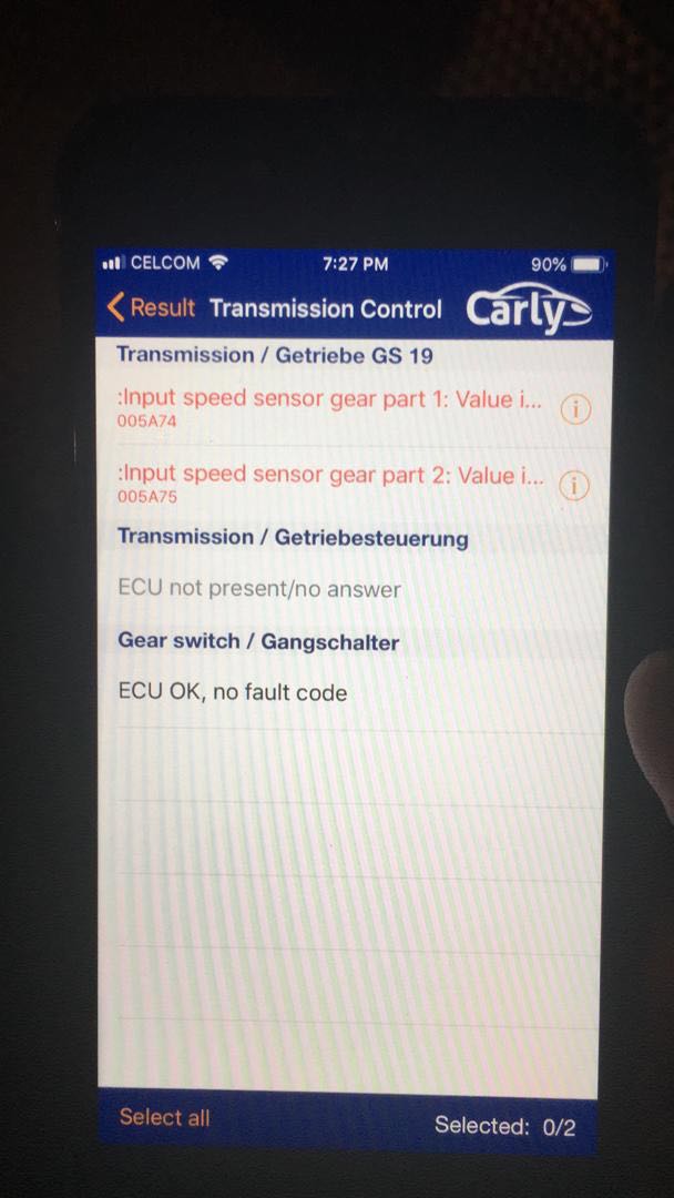

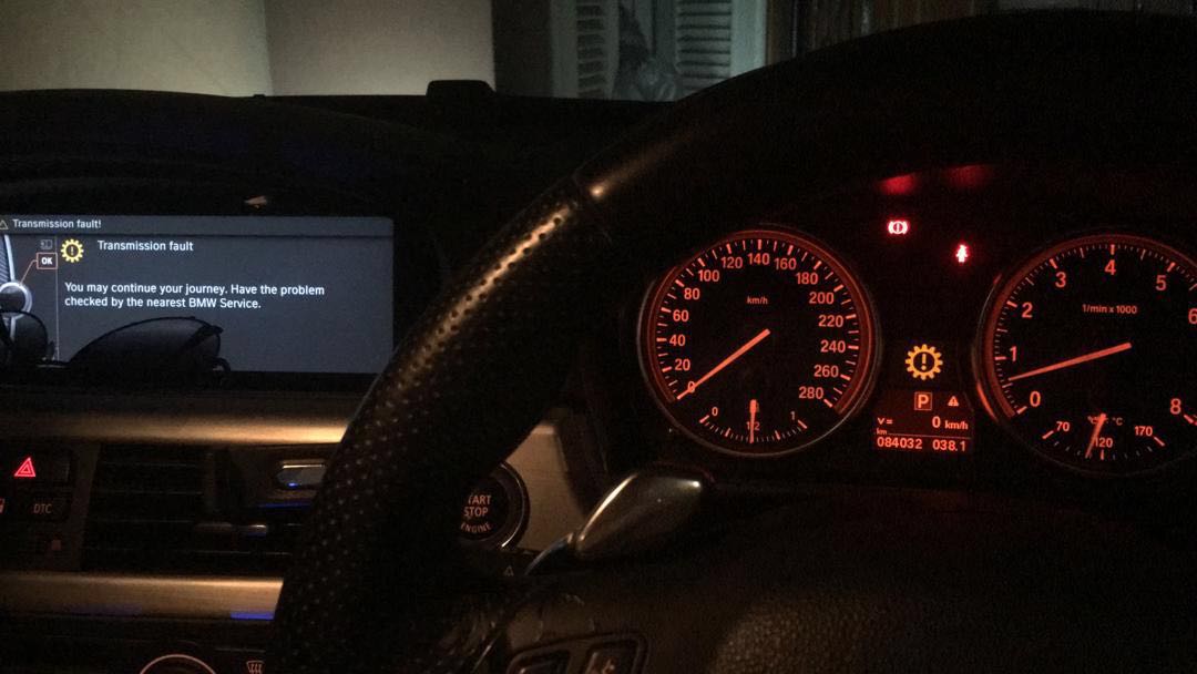

I just did my DCT transmission oil change. Drove for about 10km to get back, when I reached home. This error came up. Car jerked and went into neutral. Was wondering if any of you had encountered such issues before?
Had something similar. Needed a new alternator and battery.
