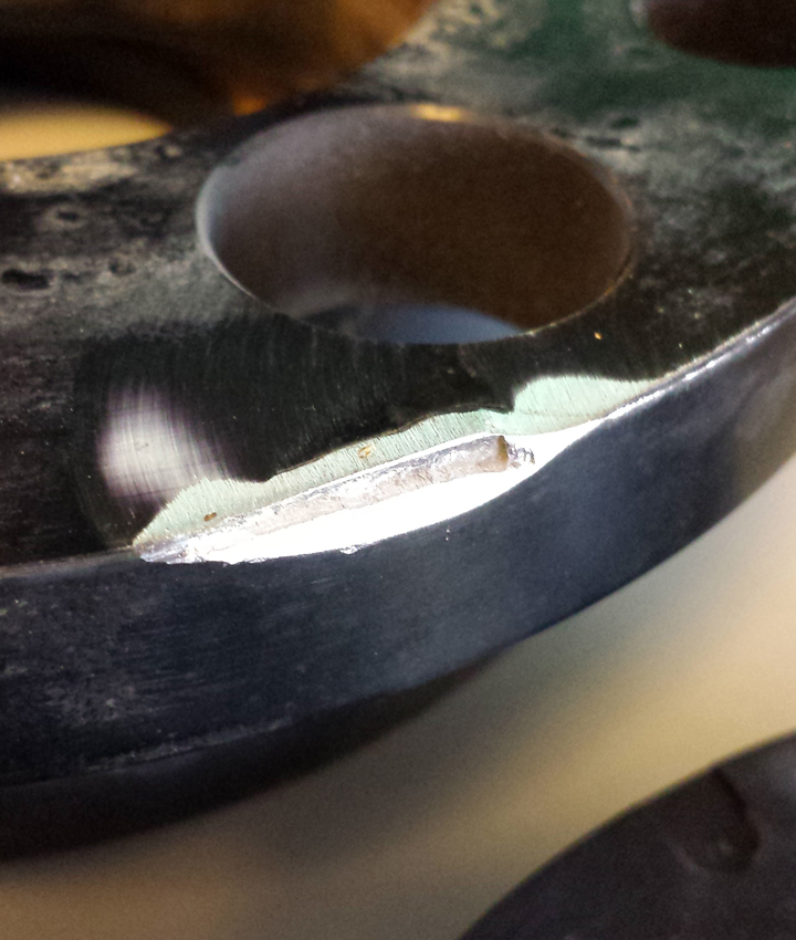

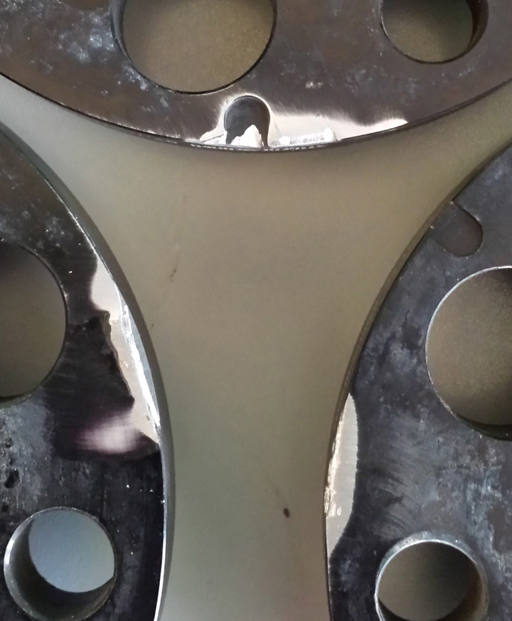

I bought these 15mm verstrabe spacers from a local yesterday and I noticed cleaning them today, bottom one has a small bend. But they still sit flush and smooth with the spacer on top of it to mimic the wheel hub. Opinions? Is it a big deal? I have a stud conversion and I'll remove the spacer if there's vibration common sense.

Route 16 wroteI have some Macht Schnell spacers (15 front 12 rear) I have used for two seasons on OEM 19" and winter OEM 18" wheels.I bought these 15mm verstrabe spacers from a local yesterday and I noticed cleaning them today, bottom one has a small bend. But they still sit flush and smooth with the spacer on top of it to mimic the wheel hub. Opinions? Is it a big deal? I have a stud conversion and I'll remove the spacer if there's vibration common sense.
I changed them myself until last fall when I let the dealer do it. The dealer indicated he could not get them to work with the 18" even though I had with no problem.
Getting my summers put on tomorrow and thought I would clean the spacers.
I opened the box and they all seem to have been gouged. I am assuming the damage was done removing them.
I am also assuming they are no longer safe. Looks like someone hacked away with a screw driver.
Guess I will go back to doing them myself.
TTSam wroteI've actually driven with all 4 spacers in those similar conditions. It wasn't a question of how well it held up on the outside. My worries were always toward the hub area.I have some Macht Schnell spacers (15 front 12 rear) I have used for two seasons on OEM 19" and winter OEM 18" wheels.
I have had no problems with spacers as long as they were installed correctly and were compatible with my wheels. The compatibility issues that I would caution are: I have found that some 10mm spacers don't work with some wheels due to the spacer's chamfer and the wheel hub interference (spacer won't fit flush against the wheel). I have also found that some wheels (BBS Motorsports E88 and E05) have a large hub chamfer which makes 10mm spacers fit nicely but 5mm spacers unusable because the wheel no longer interfaces with the hub protrusion.
I'm a big fan of Turner Motorsports spacers. They are higher quality than most of the other options. 12.5 mm and 15 mm don't have the compatibility issues I described above.
Route 16 wroteSo - do you figure they are OK to use?I've actually driven with all 4 spacers in those similar conditions. It wasn't a question of how well it held up on the outside. My worries were always toward the hub area.
On closer inspection there seems to also be a rub line past the gouging. Maybe it wasn't caused by the removal process?
TTSam wroteI'd go with slicer's advice but I was confident riding on those spacers for another 10k miles til I found a light Weight design I liked.So - do you figure they are OK to use?
TTSam wroteUnfortunately some gouging is going to happen when removing spacers. The spacers are made out of soft aluminum and applying force to it will damage it. They get really stuck to the hub when you leave it on the car which makes removal hard and force is necessary.So - do you figure they are OK to use?
As long as the hub centric portion is fine and the spacer is not warped, it is fine to use.
