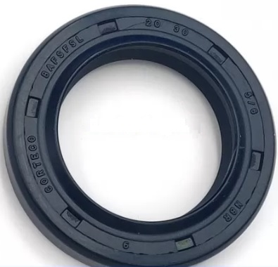

For anyone that's curious, the pinion seal for the power steering dimensions are 20-30-5/6 that correspond to 20mm ID, 30mm OD, with the inner and outer lip being 5 and 6 respectively.
P/N: CORTECO 01016544B
For the ZF racks: ZF 0770080273, 0770198130 (maybe others, too)

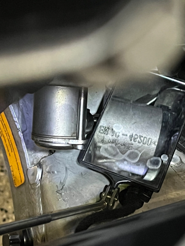

Small mirror to see the back of the pinion shaft housing.

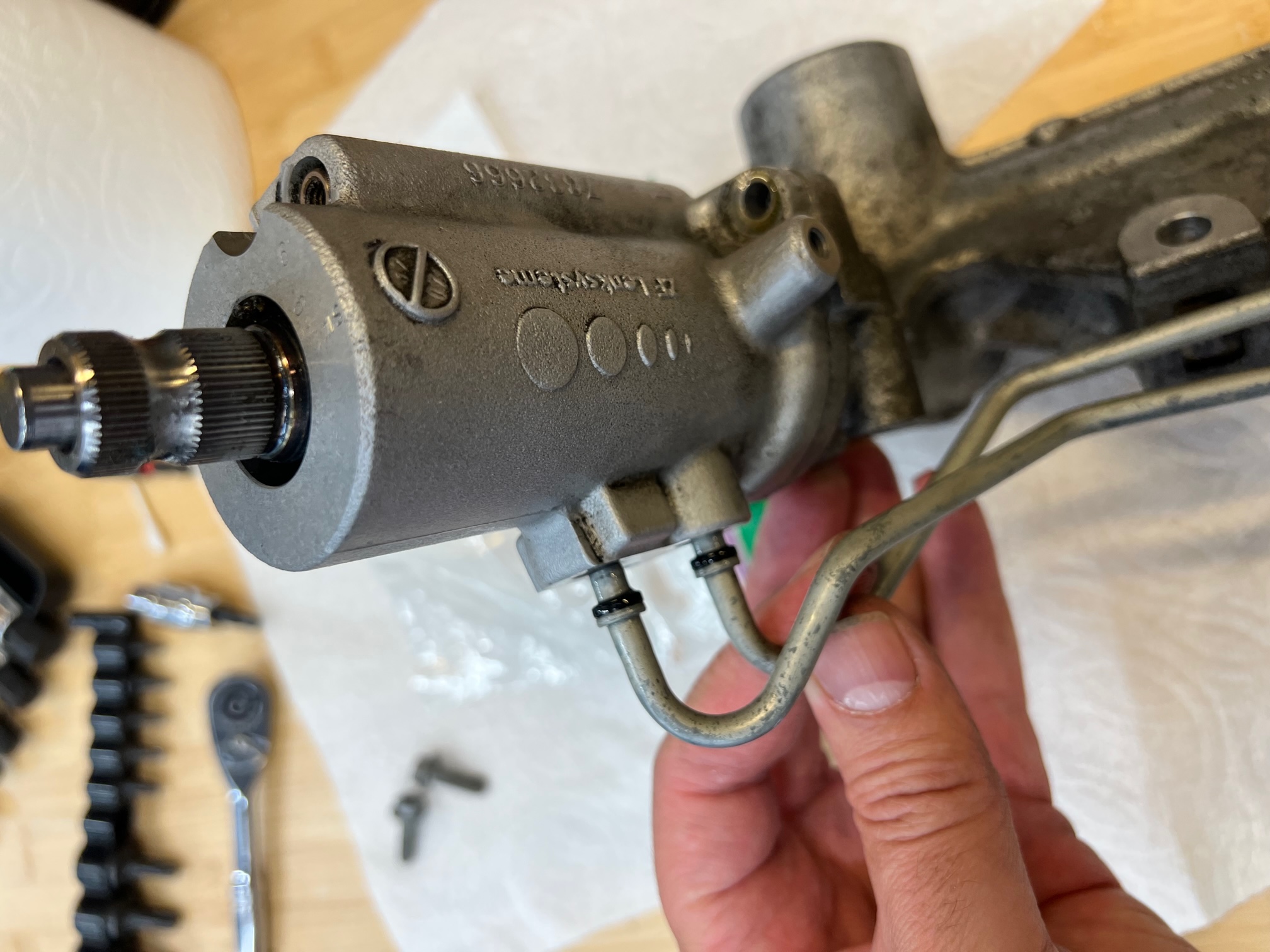

Quick question, did anyone reuse the orings for the two hard lines? I’m pretty sure my leak is from the spindle but I am thinking the hard line o rings should be replaced since they are out.
Does the solenoid have to be removed when removing the cover to replace the spline seal? In the YouTube video he does not remove the solenoid but a shop I spoke to said the solenoid has to be removed.

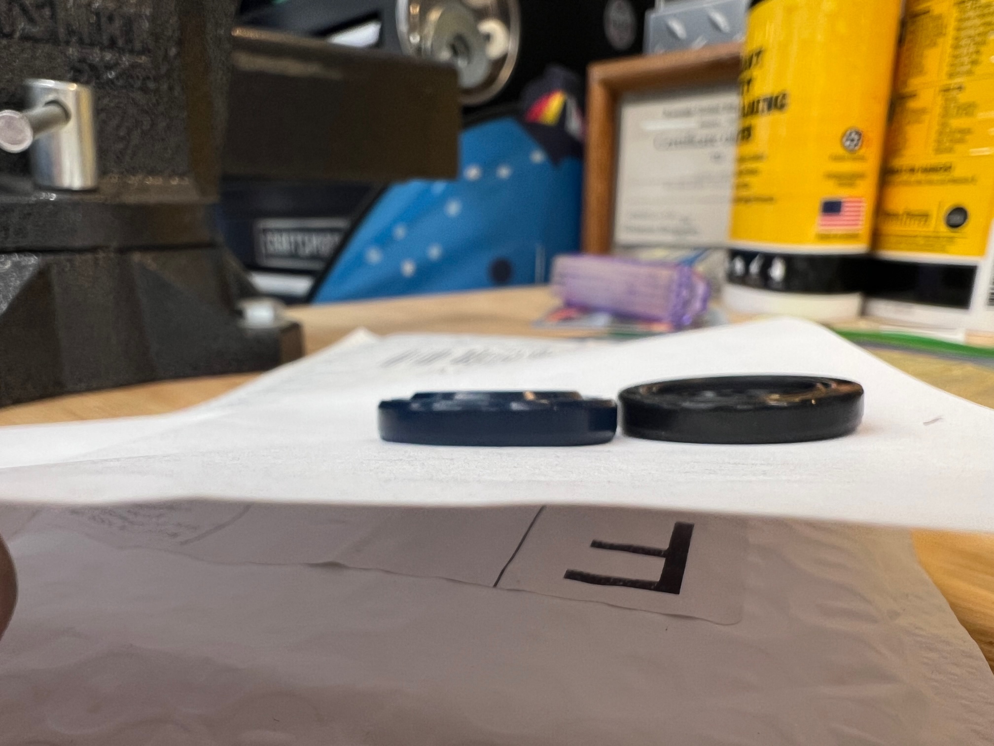

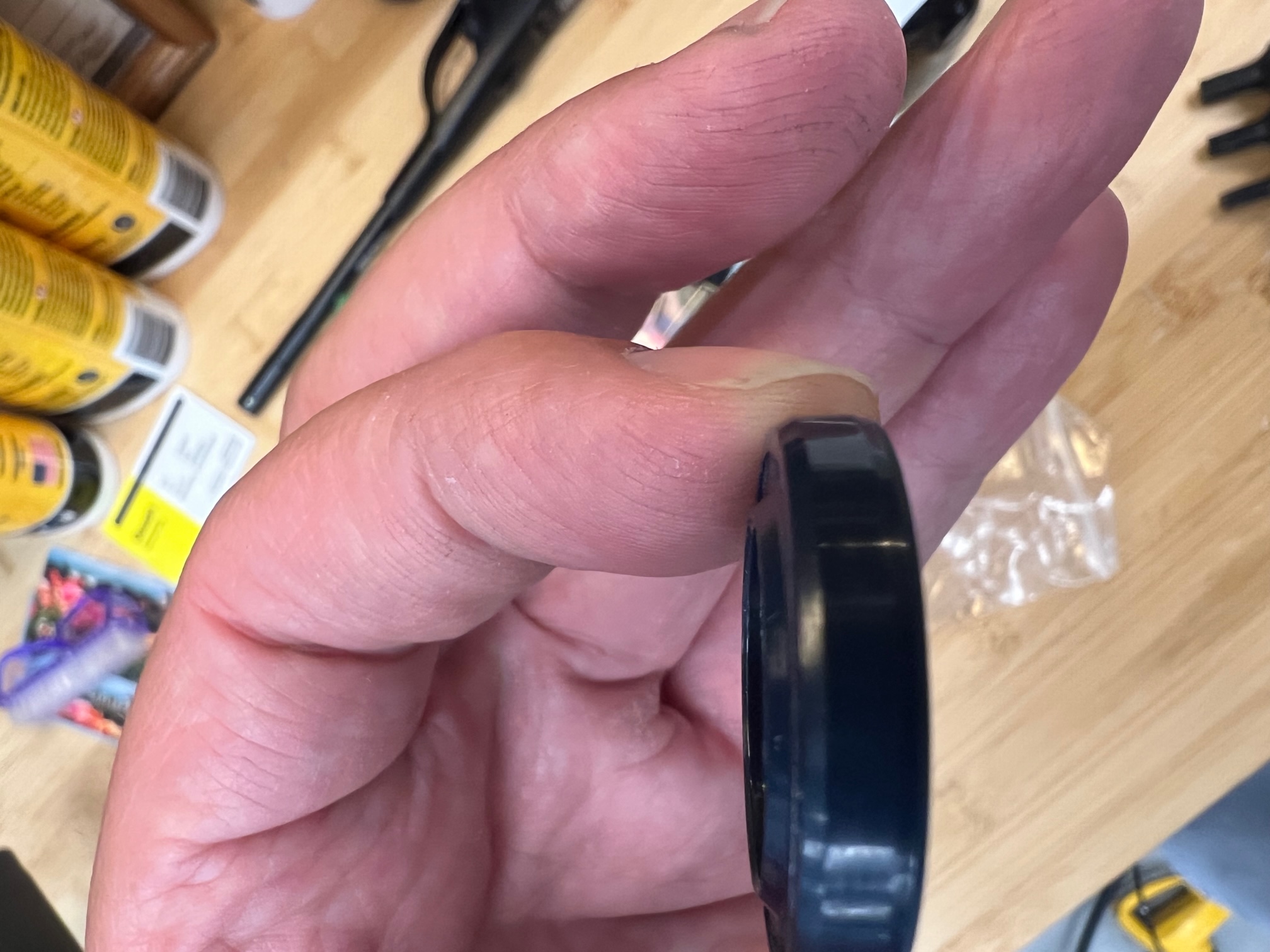

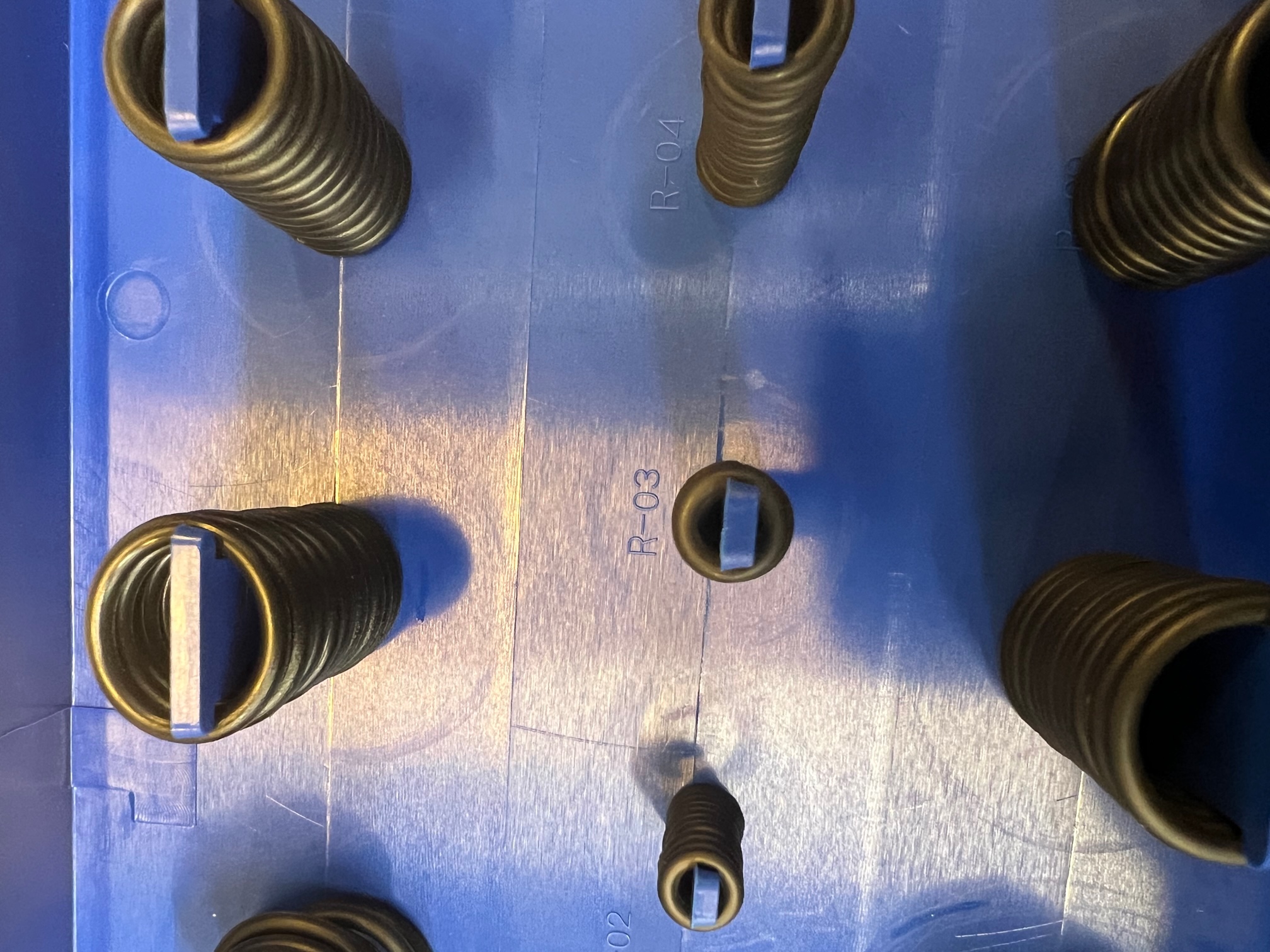

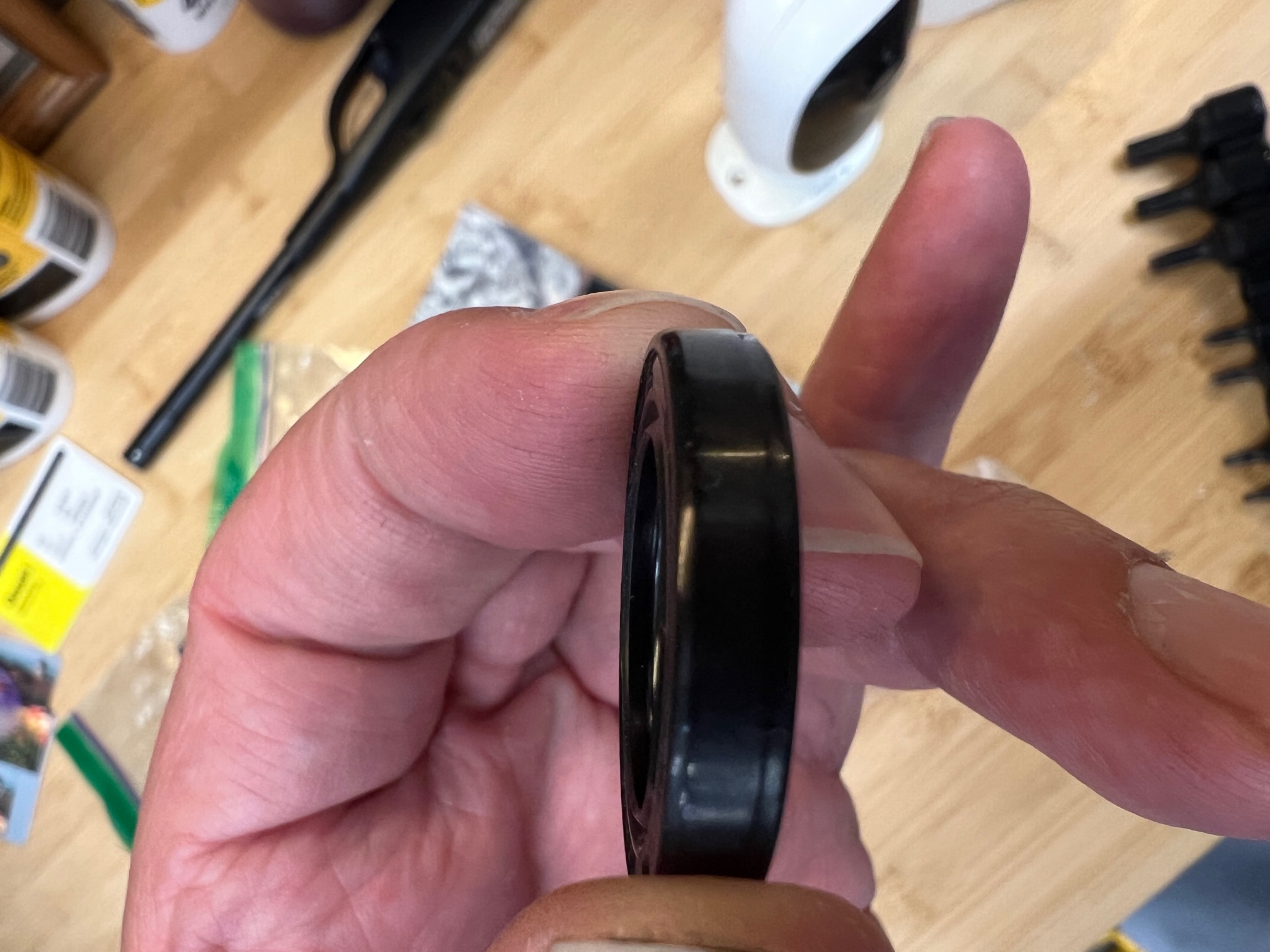

Update 06JUL2023:
It's fixed!!!! So glad it worked out.

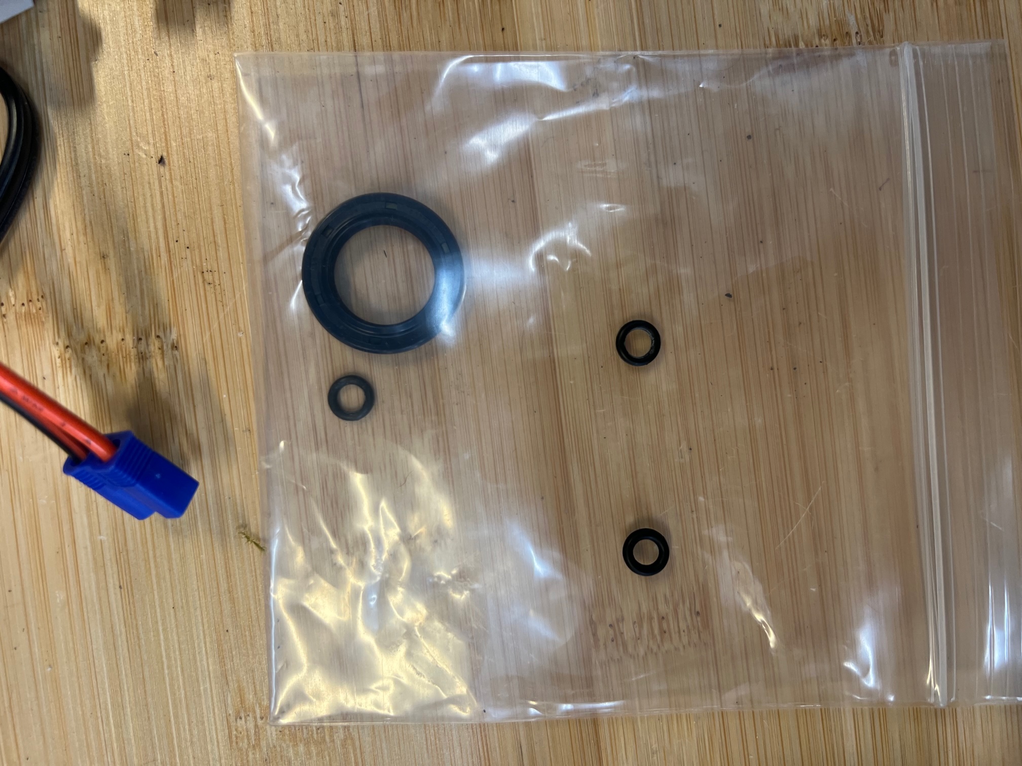

So i ended up ordering the spline seal and hard line o-rings from woodward motorsport in addition to the o-ring kit and EAI seal from amazon.
Once everything arrived I compared everything. The EAI spindle seal probably would have worked, but I noticed the Corteco seal I got from Woodward had a raised lip on the inner hole which matched the OE seal, so I decided to use the Corteco seal. Others have used the EAI seal so that should work, but EAI could not confirm. Link to the EAI seal: https://www.amazon.com/20X30X5-EAI-S...s%2C132&sr=8-1

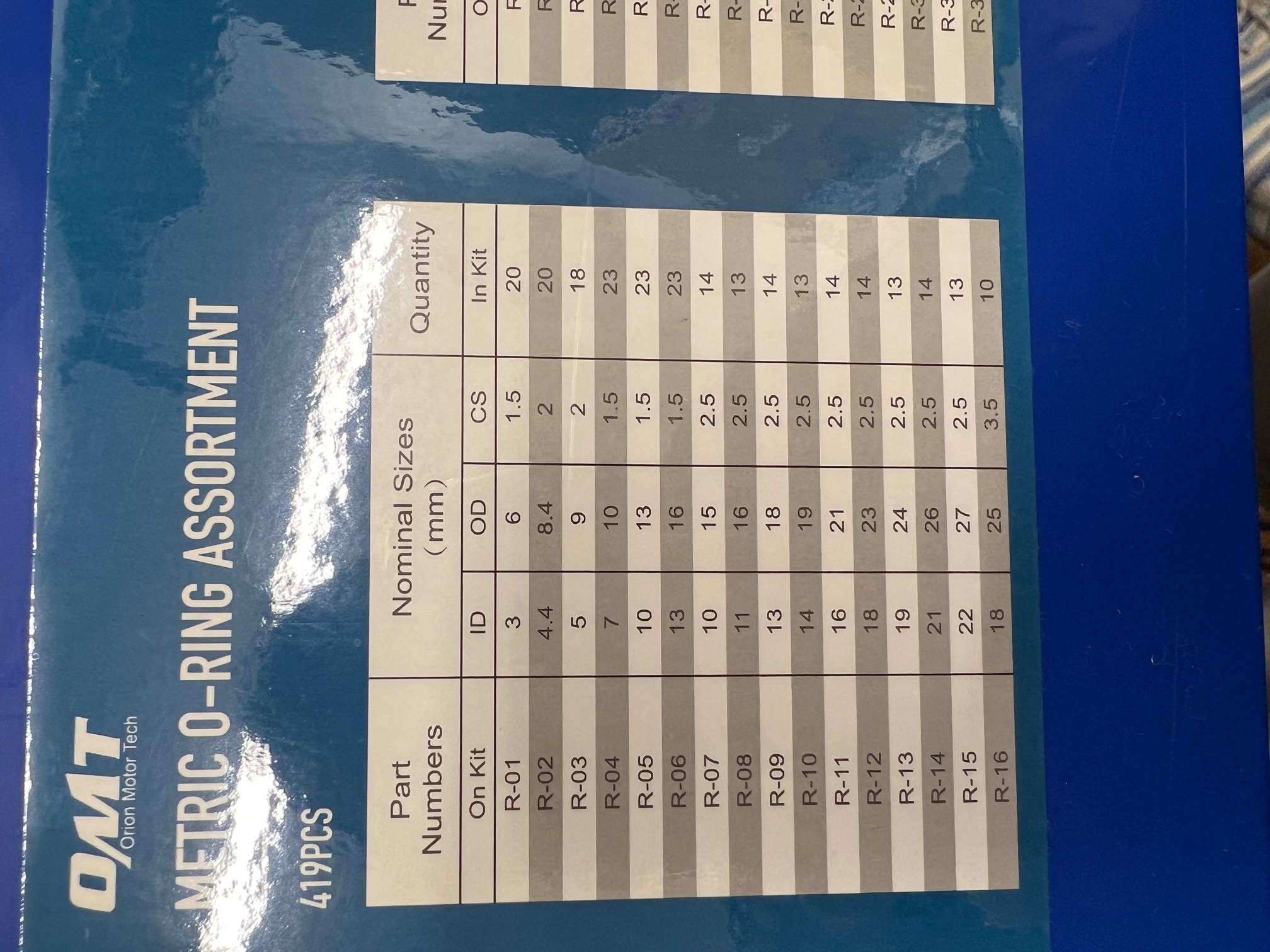

WRT the hard line o-rings, there was a size in the universal kit (R-03) that matched the woodward part, but the universal o-ring was slightly thicker, and the OE o-ring was more smiliar to the woodward part, so that's what I ended up using. Again, others have used the o-ring from the universal kit and I do think it would have worked as well.
Finally, I was hoping the uiversal o-ring kit would have the correct size to replace the seal between the spindle cover and the rack. It had the correct size diameter, but the seal was too thick unfortunately. The OE seal is really thin so I reused the original. So far so good.
Below are some additional pictures of some of the items discussed.
