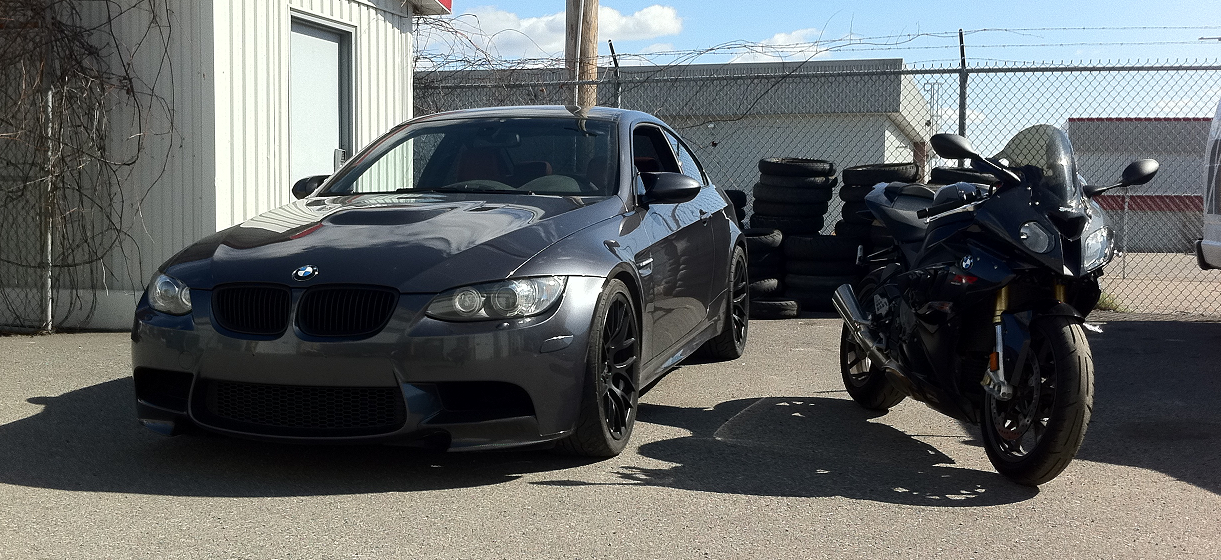

I have been running Michelin PSS 295/30 R19 on ZCP wheels for over a year, and never been happier... all the threads I read about not going above GTS, not having this, not having that, and I'm glad i just took the plunge.
http://www.m3post.com/forums/showpost.php?p=15215156&postcount=17
Drives perfect and much more stable in aggressive curves or during an Apex at the track. No rubbing whatsoever, and the looks of a million bucks.
The fronts are 255's, but I'll be going to 265's soon, as I'm getting a little oversteer with them on aggressive turns.
pics:

a 295 rear tire will look absolutely ridiculous
really? how so? do you have pics to show this?
please entertain me on this... :rolleyes:
actually, don't...I'll post them for you:
ghost4blind wrote
it will stick out way too far past the rim itself and just look silly.
welp, looks like my guess was right: you have absolutely no clue what you are talking about and have ZERO experience using a PSS 295/30 with ZCP rims.
but hey, please continue your fabulous and very objective "opinions"... we need good comedy around here :thumbsup:

You Sir have a SiK! Ride!! :bow: :bulge:
thank you...it does ok! :happyanim:
this is my favorite shot:
Image hosted on: farm3.staticflickr.com

Sweet! Do you not rub in the rear? I'm lowered on B&G springs and my rear passenger side rubs briefly on dips in the road. I'm running 285/30/19 cont. DW

nope. I'm running eibach's and all is well... However, I can only attest to Michelin PSS's, as I've read that tires such as the AD08's or RE-11's run MUCH wider, and surely will rub.
