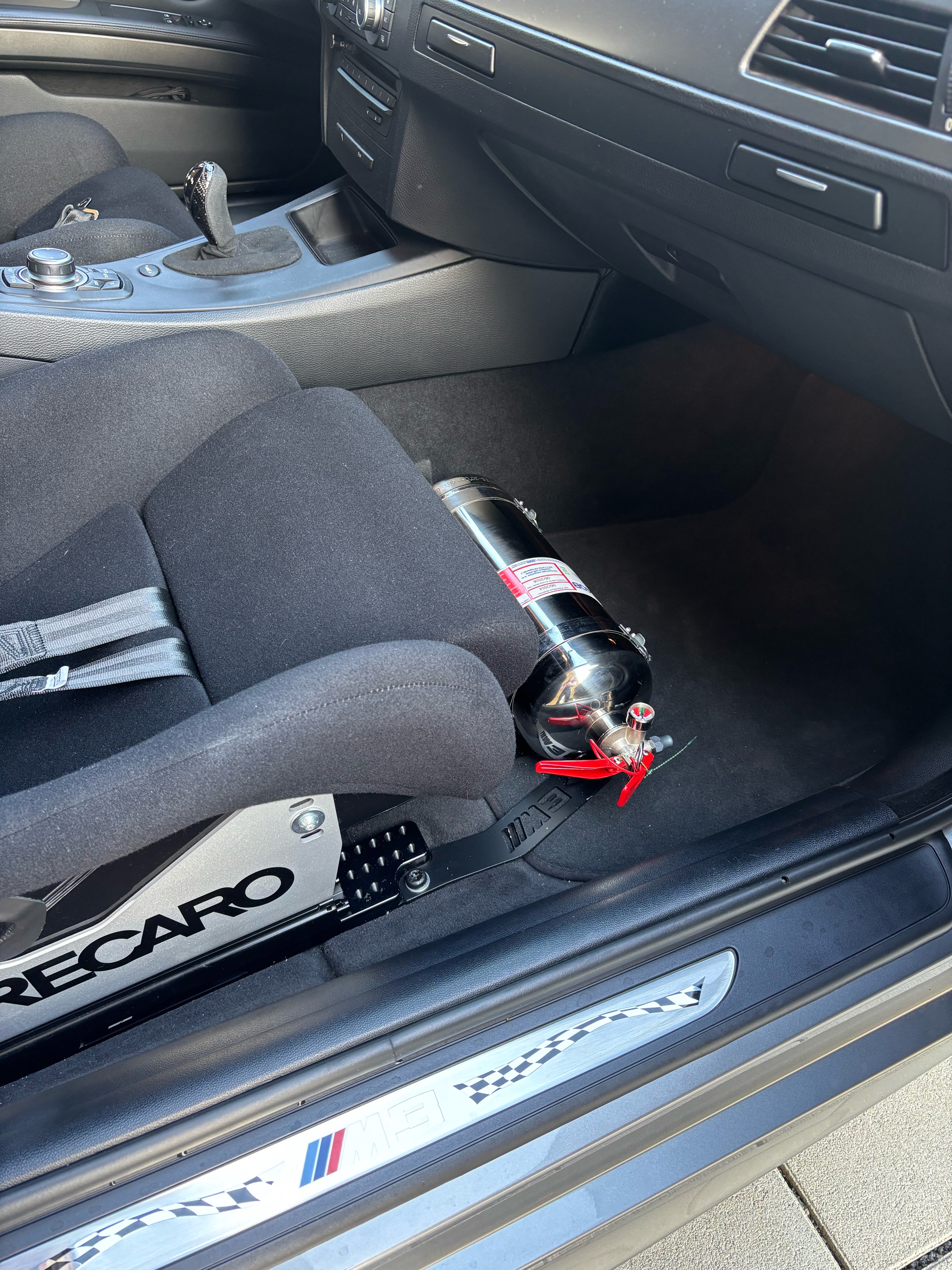

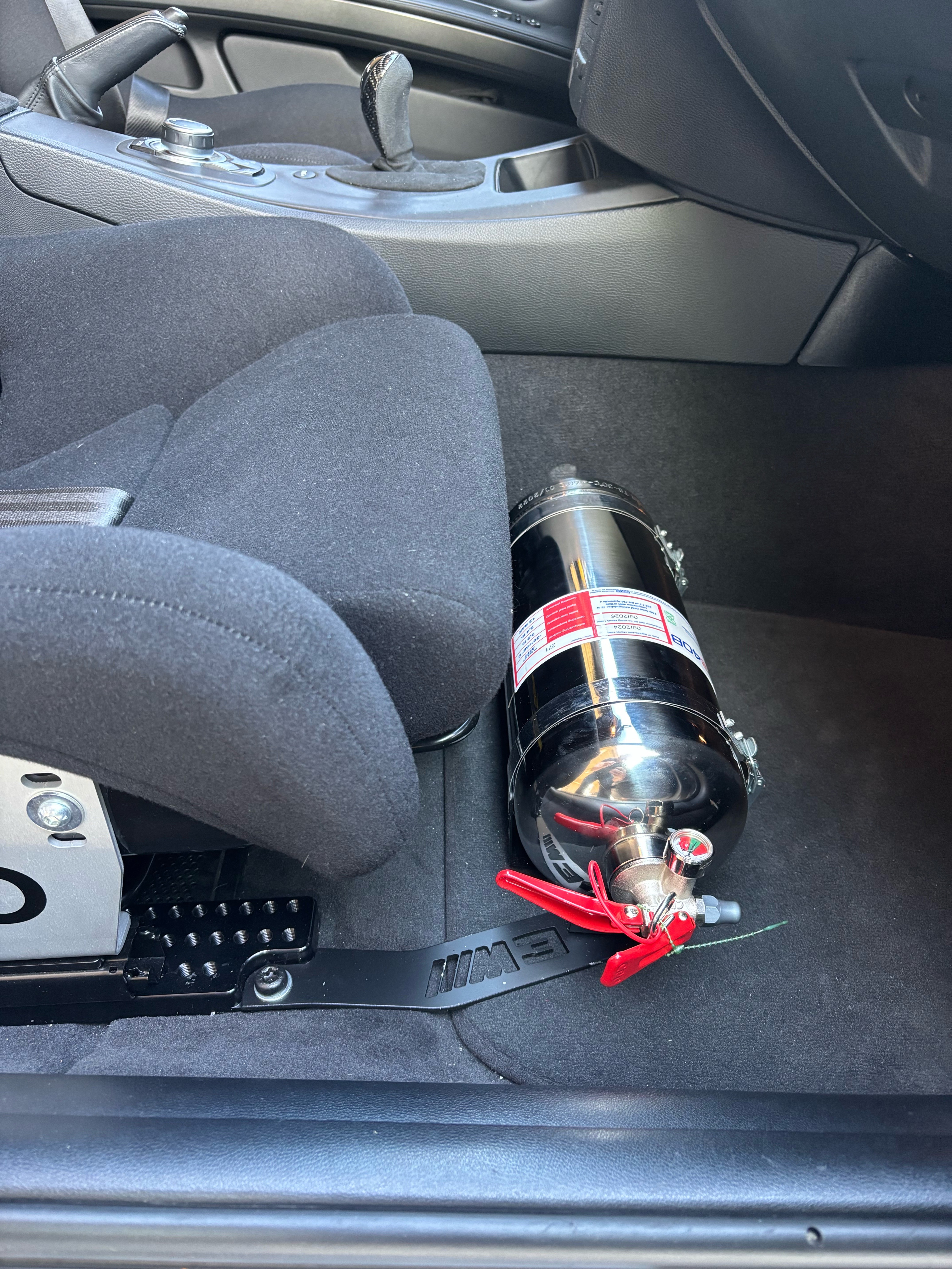

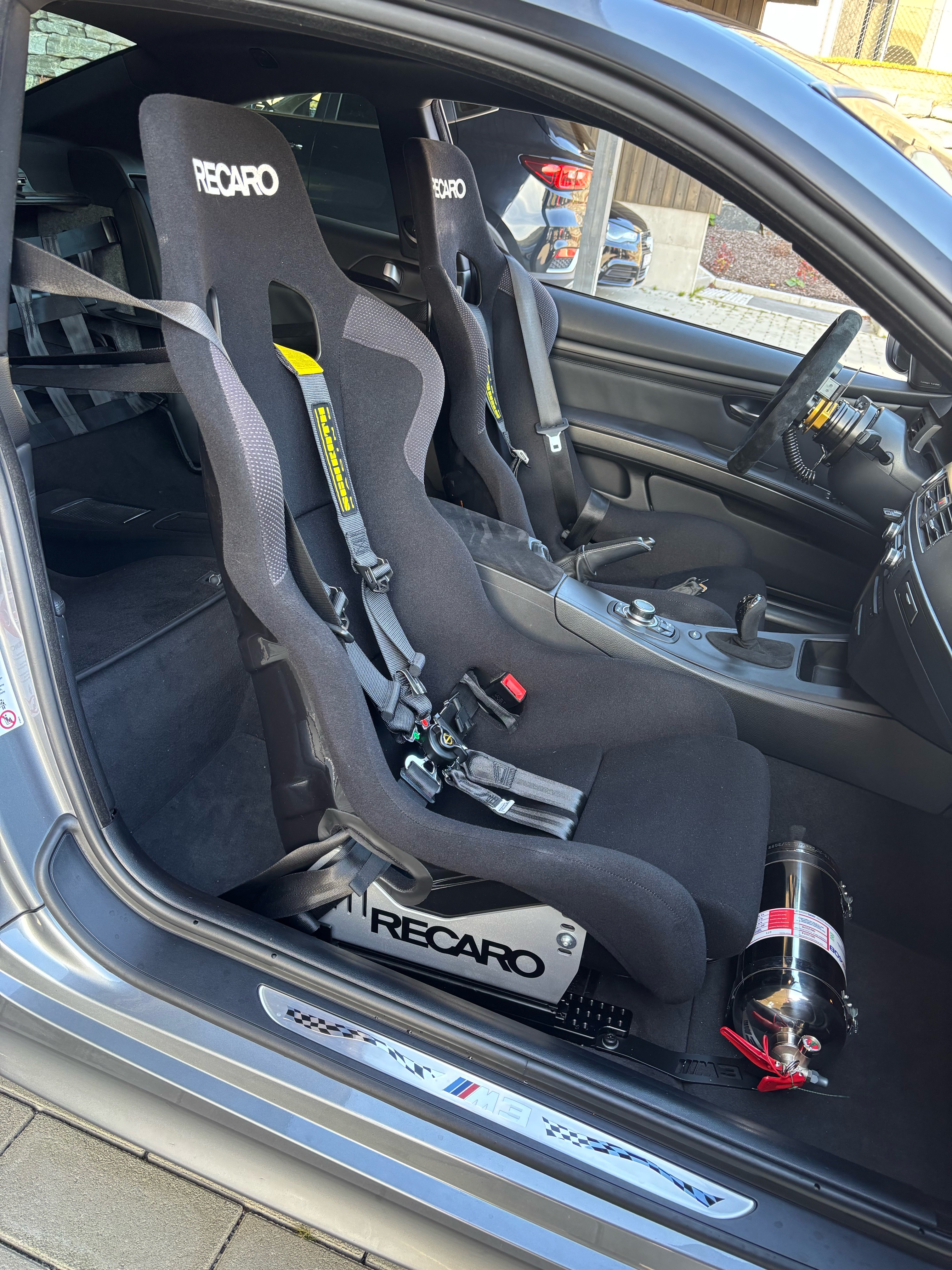

Home made Sparco fire extinguisher project 🏎️🧯

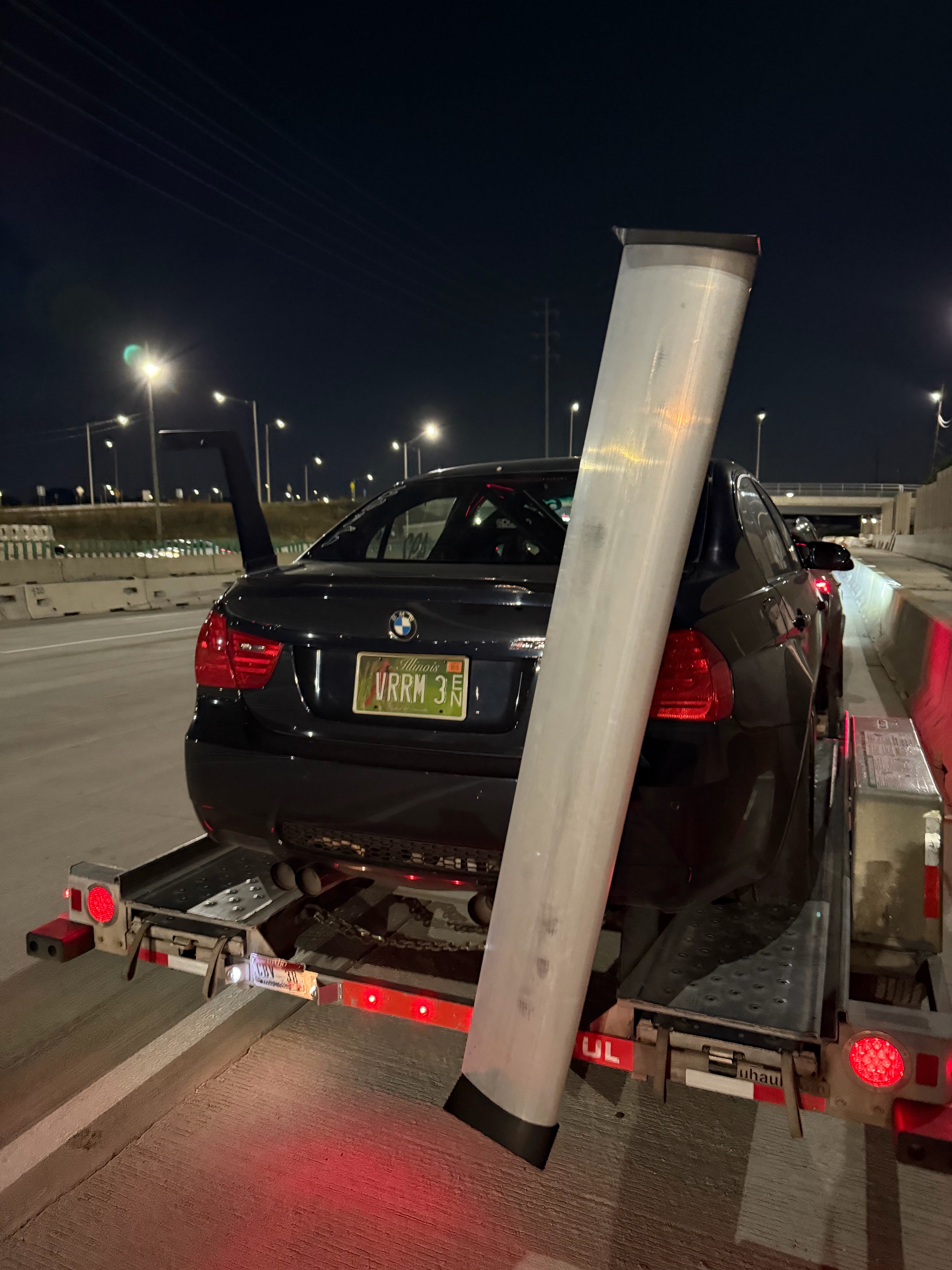

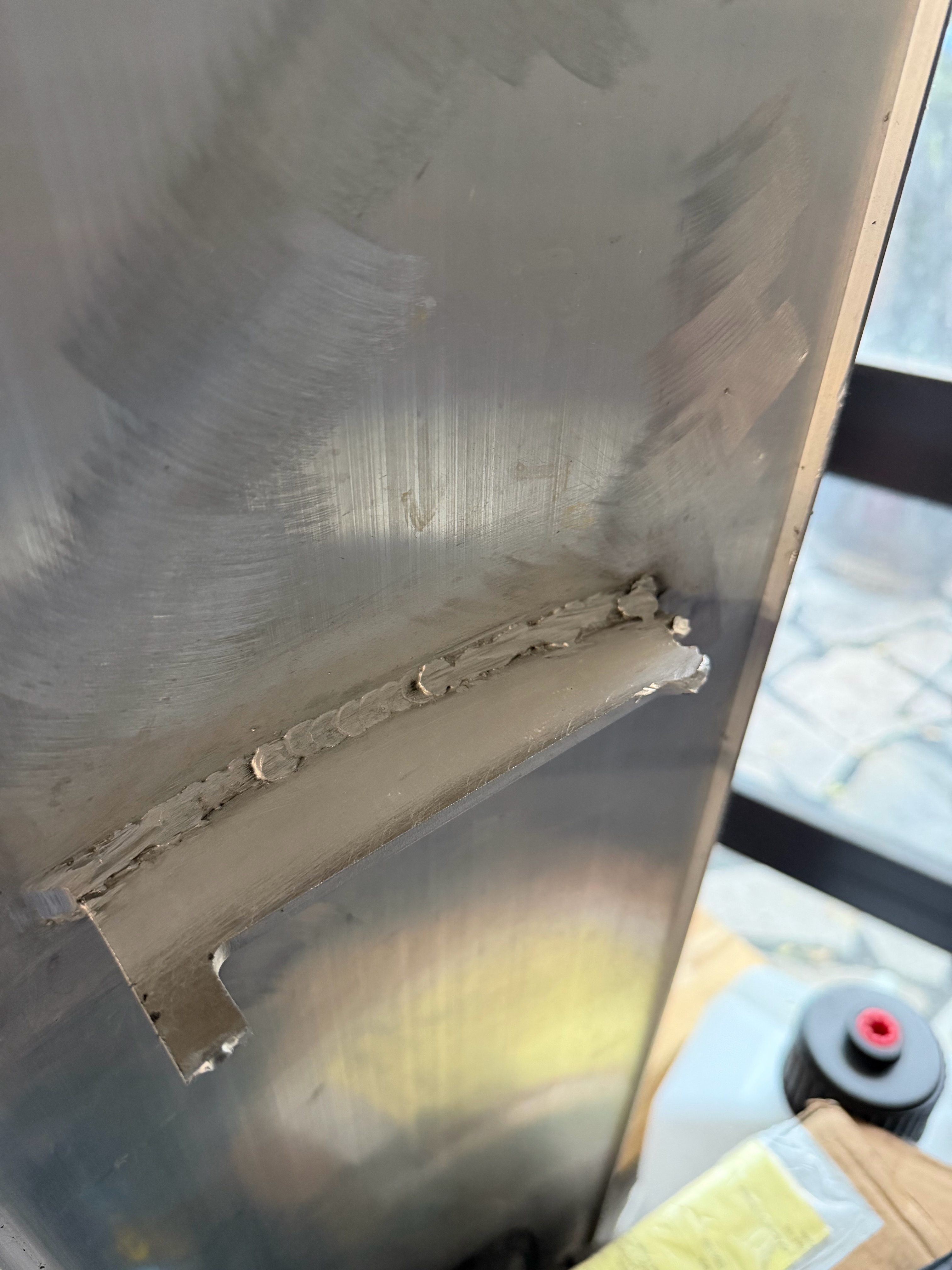

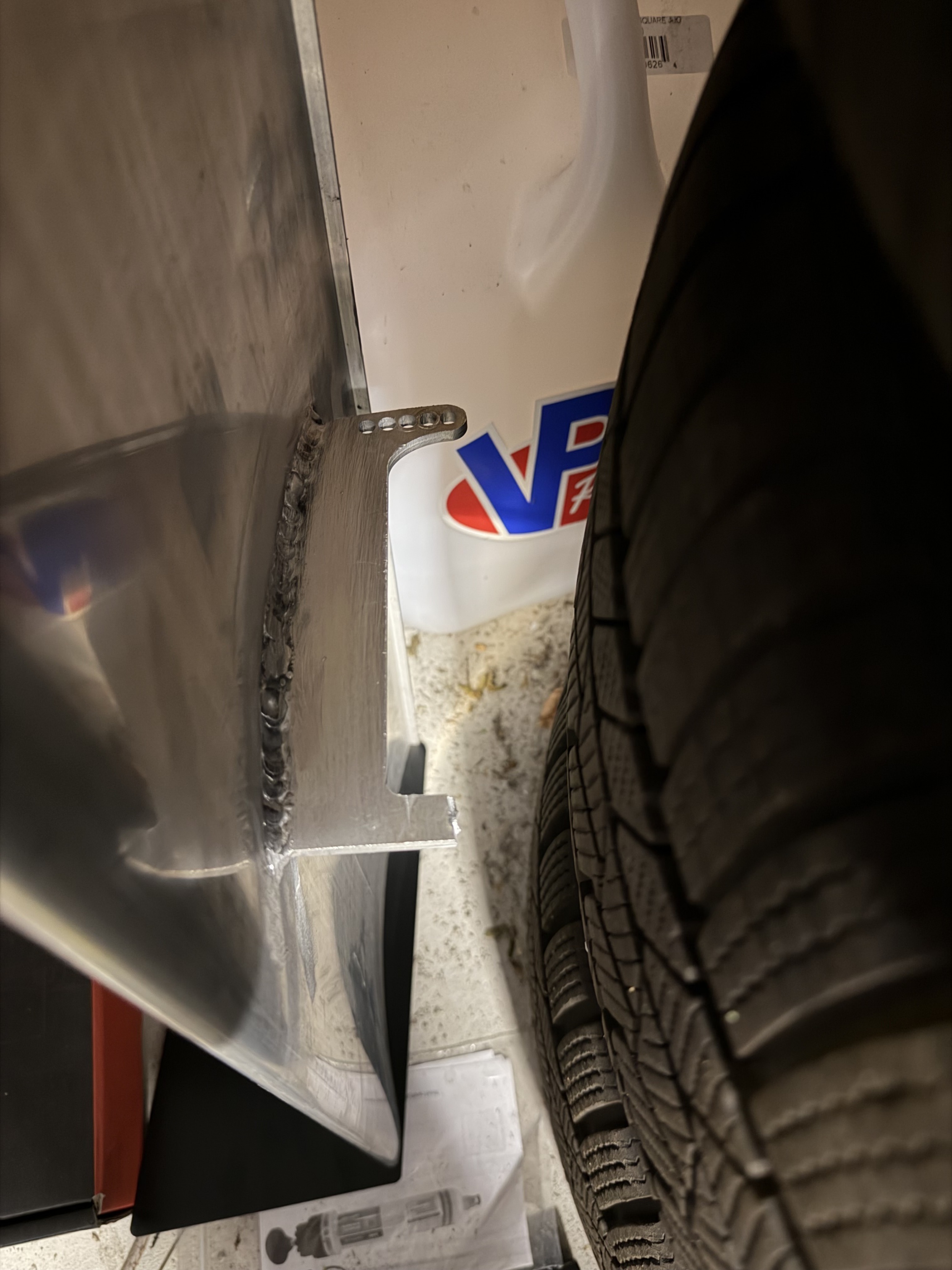

I’ll go — here’s what happens when you design your own wing mount, and under size it. The side with both ears missing is the side that failed first.
Failed at speed? Looks like the pins held (?)

While towing, so yes but not on track thankfully. Pulling it down while on the shoulder of a busy highway was not particularly fun though.
Maybe they weren’t truly undersized… just not designed for following closely from an elevated position for an extended period of time. ;-)

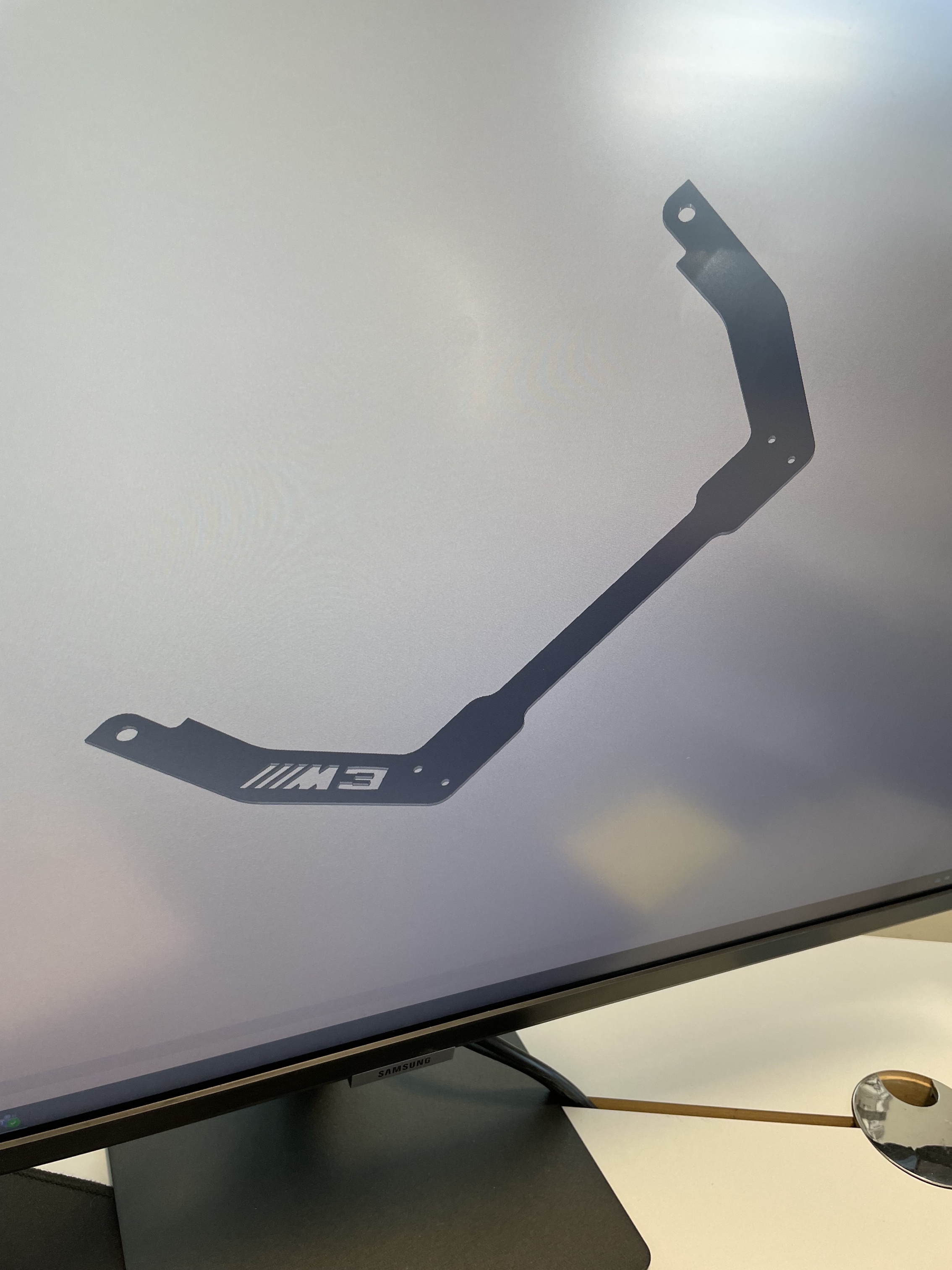

I think the actual issue is the trunk mounts. I had them made by sendcutsend so it s plate with a bend in it. I think that allowed for too much lateral flex (vs a machined one) so the whole thing rocked side to side more than it otherwise would have. Probably fatigue failure over time.
Jesus, thank god you weren't in the car on track...that could of sucked for you or another person behind you. Glad its minor damage!

Yeah that could’ve gone real bad, on the highway too. 6’ long chunk of aluminum flying around would’ve been a bad day for anyone on the receiving end. I was shocked that there was no apparent contact with the back of the car, either. Just the wing itself.
