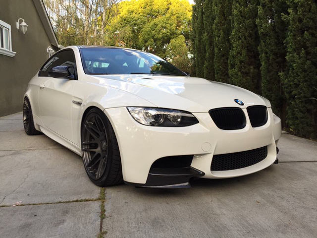

19x10+25 deep concave with 265/35
19x11+33 super deep concave with 305/30
I went with the two different concaves because I didn't like the super deep all the way around
Thanks! :-) Are you lowered and do you sit pretty flush? I don't suppose you have any pics?
I personally think it's the perfect fitment I'm on Stock ZCP suspension
Thanks for pics... I agree, that does indeed look pretty much perfect! :-)

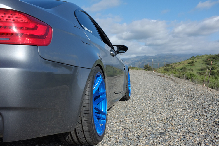

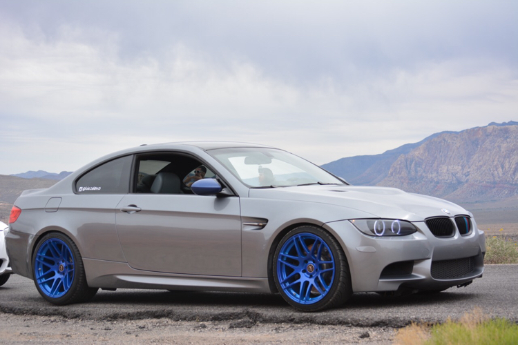

I'm running pretty much exactly the set up you're talking about- SDC F14s all around, 19x9.5 ET 18 with 265/30 and 19x11 ET 25 with 295/30 PSS, on KW sleeve. I wanted to do 275/30 on the front, but they were on backorder when I was looking. A couple points:
-the front offset is just about perfect to be flush, and I have no rubbing issues. But with a 265/30 on a 9.5, it doesn't give me a ton of rim protection (I scratched one of my fronts recently :mad0260:) Again, I'd have preferred 275s.
-my rears do rub on large bumps occasionally (I'm pretty far down on the sleeves, less than a finger width gap). If I had to do it again, I'd go with something more like an ET 29.
These are the best pics I have right now to show the side profile.
