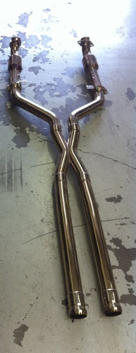

, at 0:58 and 1:09 :thumsup:) seem to have a unique sound that really puts out that high-pitch exotic scream. After comparing them to other X-Pipe designs, I think (correct me if I'm wrong here) this may have something to do with where the crossover is located (closer to the engine than in most other X-Pipes, compare below - left picture is OEM, right is Riss Racing).

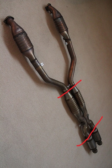

So, question: would it be feasible to cut the stock X-Pipe (gut the secondaries while I'm at it, thanks erics02wrx) just before the secondary cats and just before the resonators (see below), reverse it, and weld it back up? Aside from the X, the pipes seem parallel, so they should line up with minimal or no bending. I realize the mounts will have to be moved, but that shouldn't be a big issue.
The secondary cats would then be gutted (test pipes as well, in the foreseeable future), the resonators would still be in play, and the crossover would be closer to the engine, a la the Riss racing piece.
Worst-case scenario, it doesn't work or sounds like sh*t...all I've lost is the stock X-Pipe. Should be easy to reverse, or I'll just buy an aftermarket X-Pipe at that point (probably AA). But I'm wondering if this could be another cheap and easy mod along the lines of the OEM exhaust mod. Just wanting to experiment a little bit here!
Has anyone tried this? Any thoughts?
some do have a crossover closer to the primary cats, and i don't think its by accident. i'd be curious what the sound difference is with the oem pipe reversed.
another thing that i've found to be interesting, is how the left side of the xpipe is sort of bent and squished from the factory. i'm not 100% sure, but i would speculate it is just sound tuning.
