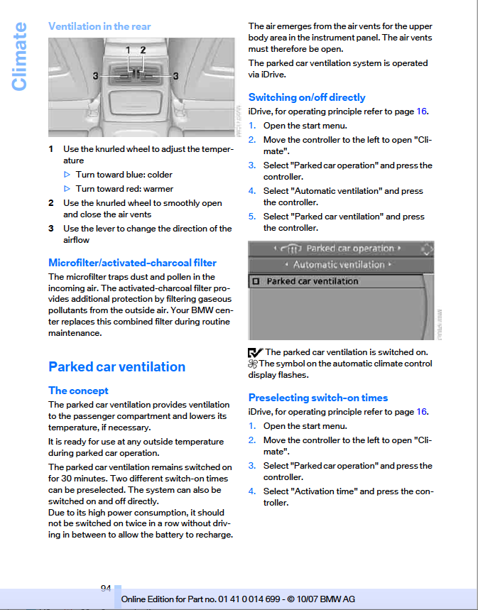

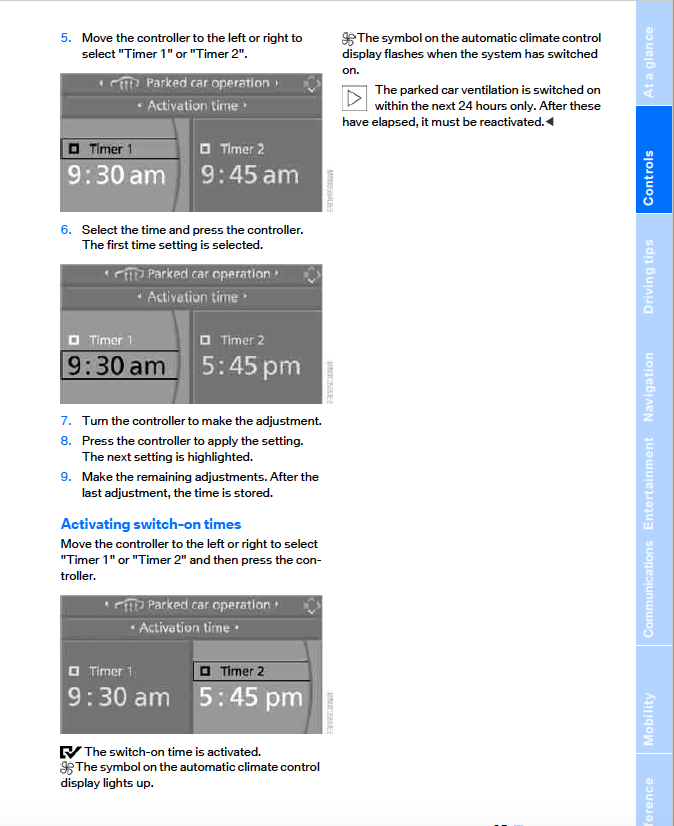

Assimilator1 wrote
DrFerry's user avatarDrFerry Just spotted this in your earlier post "parked car reverse fan ventilation", what on earth is that? lol (I don't want to spend ages finding it in Technipedia! ;)).
In the southern United States (and even sometimes in the northern states haha) interior cabin temperatures can sky rocket due to high ambient temperatures (90F to 100F) when the car is parked with windows closed for long periods (such as all day when you're at work). This is made even worse with a black roof and not leaving the windows down slightly (due to the risk of afternoon summer thunderstorms). In order to reduce interior cabin temperatures the fan can be run backwards to ventilate extremely hot air from the cabin (using the timers found in iDrive) 30 minutes prior to one's anticipated departure. Here's some more information on the subject from the manual. Hope this helps and avoids mining the Technipedia.
I have used the Parked Car Ventilation - actually many times, and it works as advertised, surprisingly well too :thumsup:. You do have to set it up each time, in other words, each time it runs, and then you start the car it clears the start time. But it was a fun 'easter-egg' function I found on the car 2 or 3 years after buying it.
Try it out, the cabin temperature will be much lower if you have left car in the hot sun all-day :happyanim:
I just read through the pic again of the manual you provided, it doesn't mention the fan being reversed for this, are you sure about that?
I would've thought the fan would run in the normal direction, and the air expelled in the normal fashion.
What is the route the hot interior “air is expelled in the normal fashion” you refer to when the windows and doors are closed?
Although I don't know exactly where they are in e9xs, with cars in general their are hidden vents in the boot, these are usually behind the rear bumper and have thin rubber flaps over them (so they blow open with air through put, but at rest provide waterproof cover). They'll be various gaps or louvres to allow air through the trim panels.
This is how you do get ventilation even with the windows closed, but as you've probably noticed, you tend to get better air flow with even just 1 window opened a little.

No, I'm not a 100% sure. It was an assumption on my part regarding how the system operates. Having used the function many times I can attest to its effectiveness during hot South Carolina summers. I will set mine to run when parked and see if I can determine where or how the hot cabin air is exiting the vehicle, or if more external and lower temperature ambient air is simply being blown in. When I think of the word 'ventilation' - which BMW used to describe the function ('parked car ventilation') - it implies to me venting of hot cabin air from inside to outside. When perhaps the function simply turns on the blower fan. I found a couple of other sources discussing the function but no real answer to your question.
