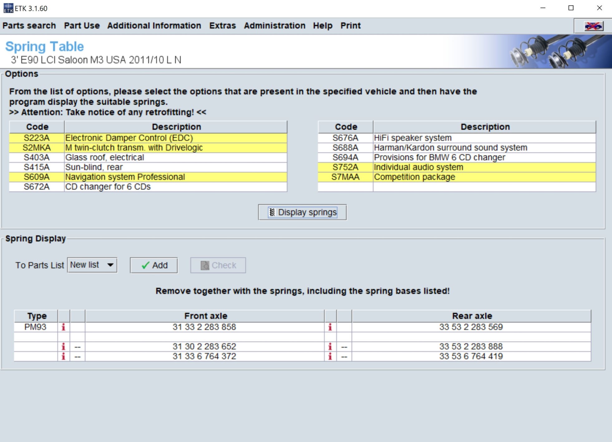

The following data is from ETK 02.2018 Database from BMW parts catalogue. I checked spring tables for a 2011 E90 Sedan with 05/2010 production data and a 01/2011 E92 production date. ZCP implies EDC as EDC was part of ZCP in USA.
Image hosted on: i.imgur.com
Spring Part Numbers Front / Rear
E90: 31332283563 / 33532283569 (6MT ,slicktop, ZCP, Nav or No Nav)
E90: 31332283564 / 33532283569 (6MT ,sunroof, ZCP, Nav or No Nav)
E90: 31332283564 / 33532283859 (6MT , every option ticked off)
E90: 31332283858 / 33532283569 (DCT ,slicktop, ZCP, Nav or No Nav)
E90: 31332283858 / 33532283859 (DCT ,sunroof, ZCP, Nav or No Nav)
E90: 31332283858 / 33532283859 (DCT ,every option ticked off)
E92: 31332283563 / 33532283569 (6MT, CF top, ZCP, Nav or No Nav)
E92: 31332283564 / 33532283569 (6MT, sunroof, ZCP, Nav or No Nav)
E92: 31332283564 / 33532283859 (6MT, every option ticked off)
E92: 31332283564 / 33532283569 (DCT, CF top, ZCP, Nav or No Nav)
E92: 31332283858 / 33532283859 (DCT ,sunroof, ZCP, Nav or No Nav)
E92: 31332283858 / 33532283859 (DCT, every option ticked off)
##Part number to X markings
Front
31332283563 : X6
31332283564 : X7 (not confirmed yet)
31332283858 : X8 Thanks chutak's user avatarchutak
Rears
33532283569 : X5
33532283859 : X6 chutak's user avatarchutak
