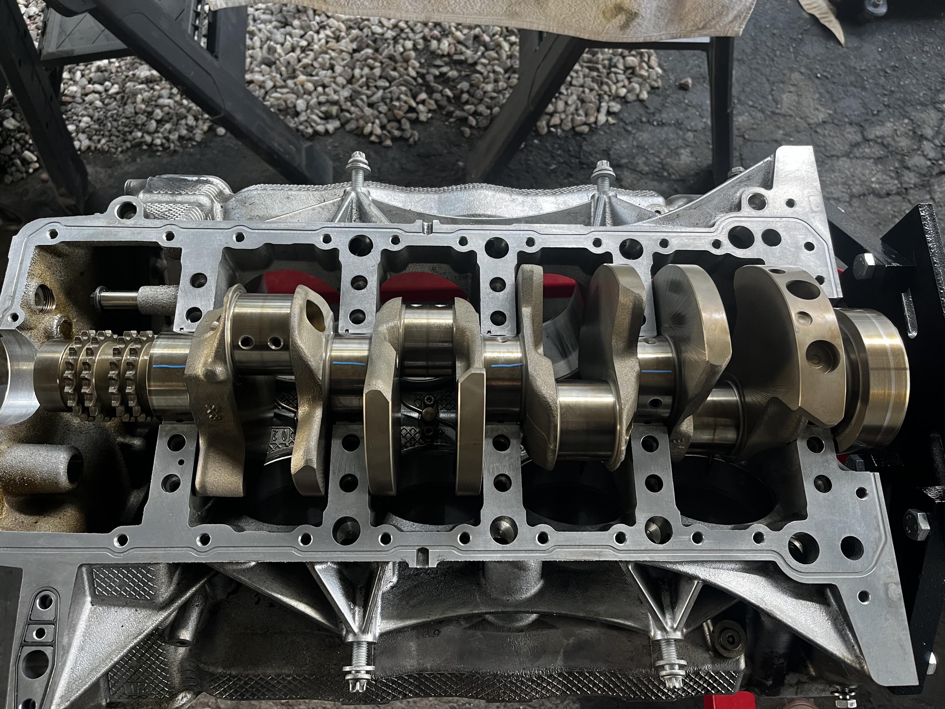

jvictormp wroteI'd love to, but a video would be 15h long and so hard to edit. I prefer to take my car to deansbimmer for a main bearing service when it gets to 150kSYT_Shadow
You're the one who made it possible for us to change RBs at home.
Now we need you to enlighten us with a video tutorial of dean's procedure and possibly with engine in car.
Let's make these engines last forever!
Main bearings aren't something I'm worried about
deansbimmer wroteAre you able to give us a little more info on each of those engines we see? (so I can add them to our blown engines list).It has been around 6 years after my original post. We continue to see a relatively steady number of main bearing failures, however still much lower than rod bearing failures. The below image of S65 blocks are from 2024 failures so far. We get engines in from all over as an S65 specialist. What we see in quantity is not typical of every shop.
Due to a recent video from an Australian company breathing new hysteria into the main bearing concern, I want to touch again on my opinion regarding main bearing replacements.
Main bearings are a relatively low risk. As these engines are ageing and accruing significant mileages across the sample pool, we will see more continue to fail simply as a matter of time.
Most of these cars are well past 100k miles now. As my original post demonstrates, a proper main bearing replacement service is quite intensive, and very costly if performed to this degree of quality. To consider this amount of disassembly and NOT carry out a full rebuild seems financially foolish.
Since we see mains fail at a low % and usually past 100k miles where the rest of the engine is tired also, we recommend to not worry about main bearings until you're ready to consider an engine rebuild.

Just found this, and as someone who now does this full time, I can say this is the most accurate and comprehensive thread on the topic I have seen! Spectacular job.
--Peter
PS: I should note that the No. 1 main bearing problem does seem to be relatively widespread. There are lots of theories, and I have mine, but there is really only one solution: more clearance on the No. 1 main bearing than the others. Most other BMW engines, such as the S62, show between .0005" and .001" additional clearance on the first main bearing not because of the chain, but because of the expansion of the crankshaft caused by the torquing of the harmonic balancer bolts. BMW specs maximum clearance of .002". On main number 1, I have gone as high as .003" and used .0025" on the remainder.
--Peter
Partee Racing LLC wroteHmm, I guess this is a description issue (as I assume you know your stuff.....
--Peter
), but I don't understand what you mean by "caused by the torquing of the harmonic balancer bolts", and I'm talking as a (UK) mechanic of many years.By harmonic balancer do you actually mean the vibration damper as seen here?
By torquing, that normally means the force required to tighten a bolt etc to the correct force (at least in the UK). Presumably it's not that because either they'd work lose (they don't as far as I've heard), or nothing would happen to the bolts, for if their was a tightening force applied to them by changes in engine speed, it wouldn't be enough to keep tightening the bolts.
So by torquing, do you mean twisting them along their length? (although again, I can't see how. Surely that could only happen if their was insufficient clamping force? In which case, surely they'd work lose?).
Anyway, I'm puzzled
, I look forwards to your explanation
Sorry for being obtuse! All I mean is that when the balancer (harmonic balancer=vibration damper) bolts are installed, the No. 1 main bore expands, decreasing the bearing clearance. So if clearance is measured before the balancer is installed, you need about .0005" more clearance than if measured after the balancer is installed. If you are starting out with inadequate clearance by traditional engine building standards, as is the case with the S65, the situation is exacerbated.

I got a question. Althogh it’s pretty clear from some videos of the upper no.1 main bearing is wearing faster due to the up-load of the front of the crank due to the dual chains pulling on it from the tension. That part seems to be very plausible from the wear. But increasing the tolerance to allow more oil flow may help with lubrication but does that not also allow slight more bounce or flexing of the shaft? I’m sure minute difference but the front of the crank shaft is putting unequal about of pressure as it spins in the no.1 bearing area.
Has anytime that rebult and replaced the no.1 bearing with larger clearance seen any engine failures later? In other words; does this remedy fix the problem? Almost seems impossible to get 200K + miles with out major overhaul, etc.
I don’t think of increasing clearance as allowing more flex of the crank. I look at it as reducing the likelihood of the crank from grabbing the bearing. Perhaps I’m incorrect in my understanding of how much the crank can flex.
spammysammich wroteInteresting observation. I wish some automotive engineers could way in on this crank issue.I don’t think of increasing clearance as allowing more flex of the crank. I look at it as reducing the likelihood of the crank from grabbing the bearing. Perhaps I’m incorrect in my understanding of how much the crank can flex.
I'm not an AE (just a car mechanic/tech).
But I would've thought that increasing No1 mains clearance would at best make no difference to bearing wear due to the chains tension, to at worst increasing wear (very slightly) as the oil film between the pressure/loaded side of the crank and bearing will be very slightly shorter and so (slightly) higher pressure/load on the oil film.
Would be interesting to hear what
deansbimmer and other engine builders thoughts are on this.
Another point that most people seem to miss, twin timing chains used to be quite common in BMW engines (& others I'm sure), before they started penny pinching.
I don't recall their being problems with their no1 mains? Unless I just haven't stumbled across it?
2 examples of BM engines with twin chains are the S62 (e39 M5) & M57 (3 ltr I6 diesel).
