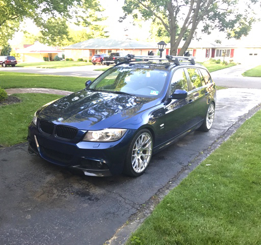

I had hunted for a manual M sport for about 6 months. Anyone who's been in this boat knows it's extremely frustrating, as there in short supply and high demand. I stumbled above an ad for a Deep Sea Blue 2012 with 31k miles. Had every option besides adaptive cruise and front PDC. It wasn't an M sport and an automatic but literally half the cost of anything else I was seeing out there. I started crunching numbers and it would be far less to convert the car to M Sport than try and actually find one in the specs I wanted. I had a PPI done and the car was in great shape. Garage kept it's entire life, second owner. Seller accepted my offer Ans the shop who did the PPI agreed to start the M sport conversion for me before I flew out to pick the car up.

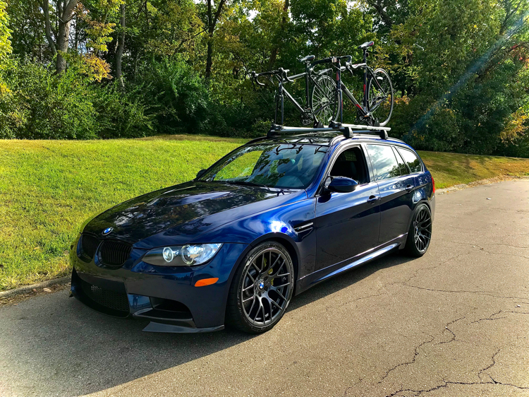

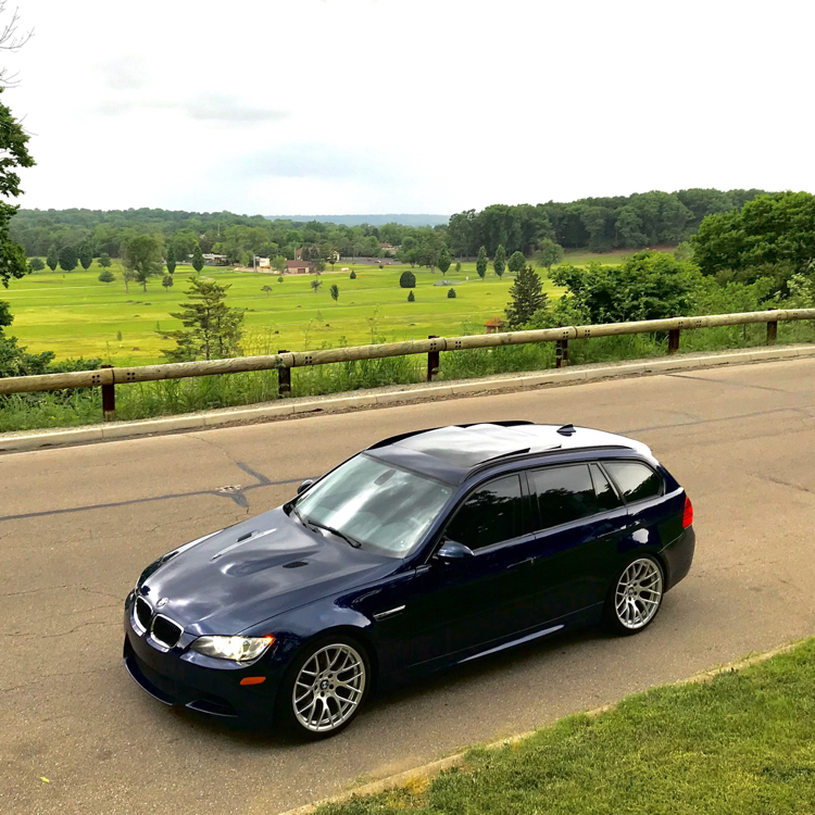

This was the car pre purchase and then after first round of upgrades

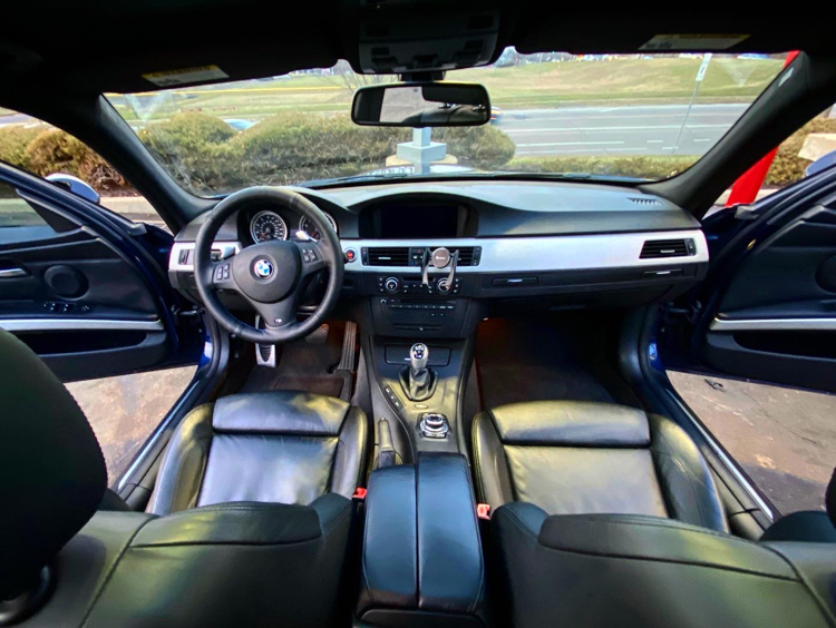

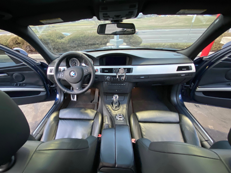

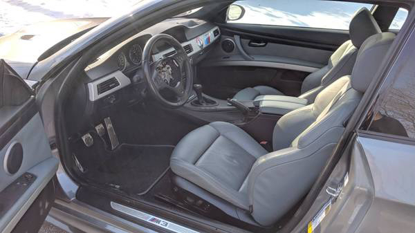

Interior:
Interior is super easy to plug n play on your own, many deals can be had if your patient, observant and timely.
M parts for interior are as followed

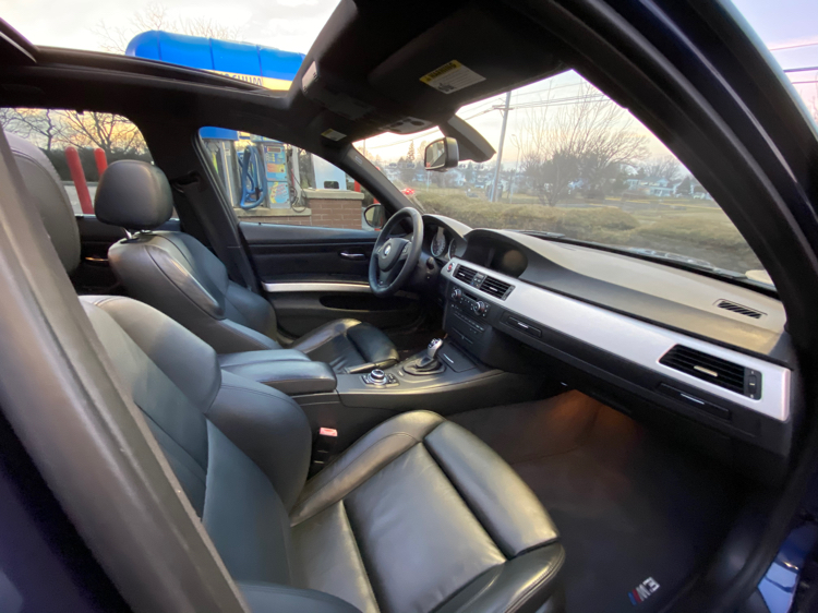

Front seats - Direct PnP swap

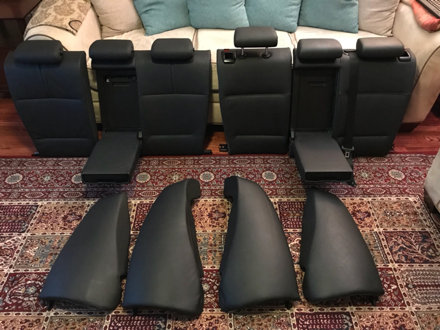

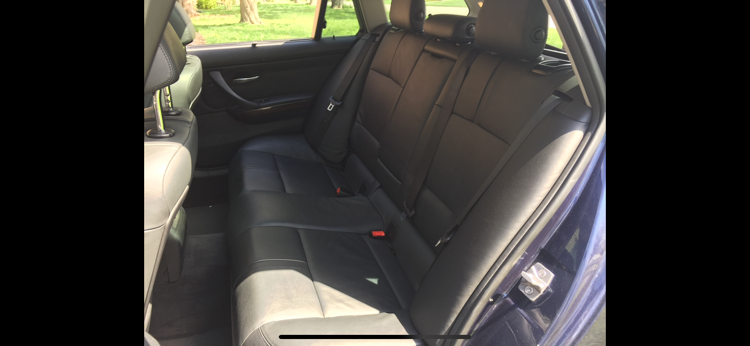

Rear seats
Bottom seat direct PnP
Rear upper seat needs to be reskinned with M3 Novillo leather on the frame of the e91. The latch mechanism is in a different spot. Leather needs cut here. The side bolster are shorter in the e91. Both of these cuts have coverings on them. I had an upholstery shop do everything for 200.

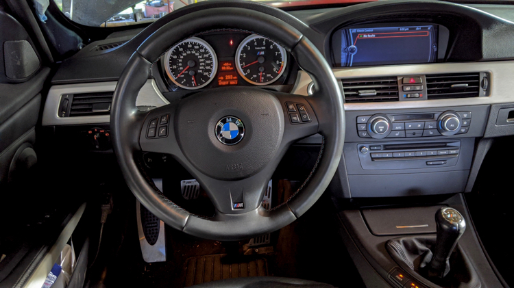

Door cards - PnP. I did have to switch the rear shades from the e91 to e90 cards.
Steering wheel - PnP but without the proper wiring harness the M button is radio source.
Arm rest - PnP
Door sills
Dead pedal is the same as M sport
ABCD pillars - AB are e90 M3, CD are M Sport e91 pillars.
Center console trim - PnP but needs manual shifter or DCT shifter modified to work with steptronics shifter. A lot of work for a short term need lol

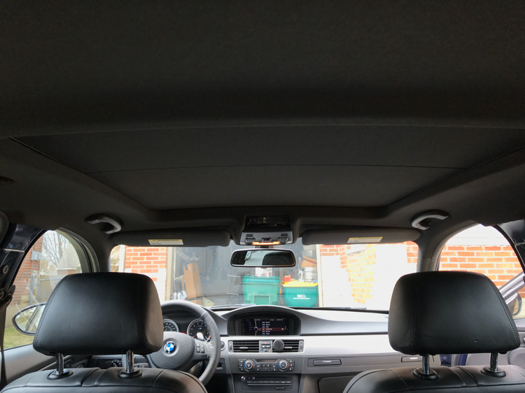

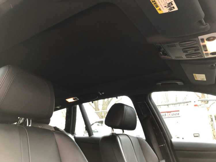

headliner was reupholstered at the same shop who did my rear seat. Cost was 80 only providing the headliner out of the vehicle. Sunshades come out from the top after removing moonroof glass.
Headliner Hardware e60 M5 hardware has all the brackets for the e91 besides rear cargo roof covers.
Sunvisors - PnP
Odometer - can work with N52 if coded and virginized. I swapped out the manual cluster with my donor we can discuss later.

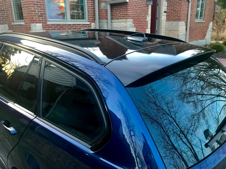

Black moon roof unit had to be e84 as it shares same pano moon roof and alarm module that's located I side the unit
Black tailgate trim and rear boot trim sourced e91 M sport bits from Europe.

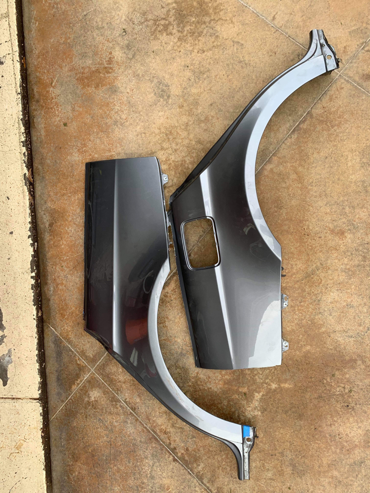

Pretty much the only thing that directly bolts up is the hood and side mirrors. Front clip has to be changed over including
Headlights
Rebar
Core support
Fenders
There are dozens of brackets that need to be changed.

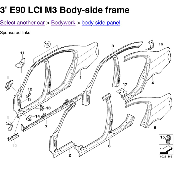

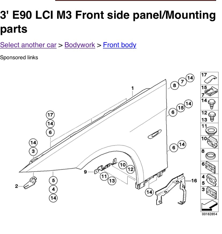

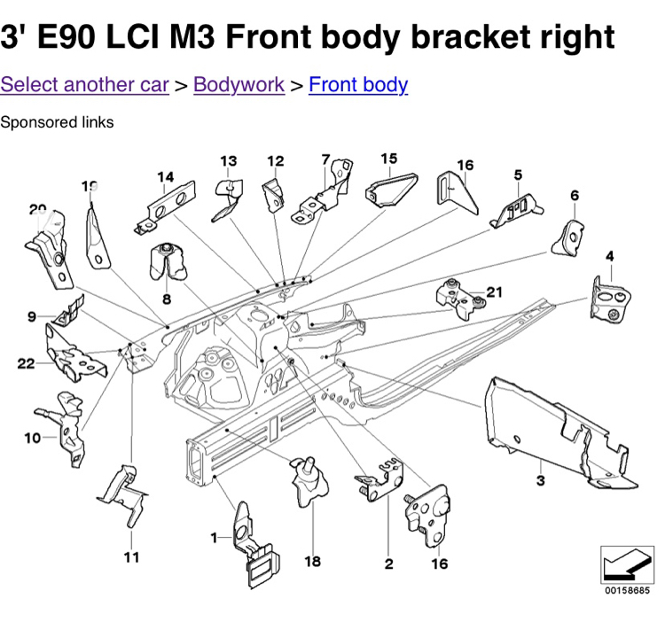

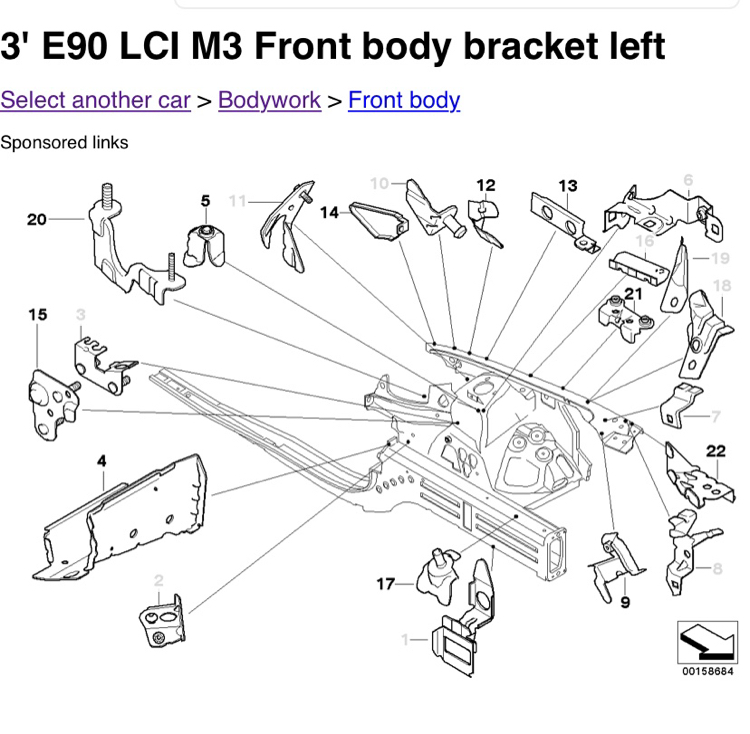

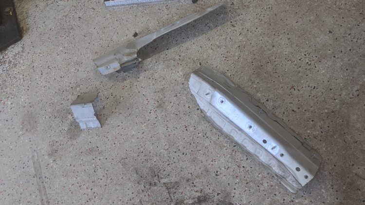

In the charts below you can see the following charts. These are the body brackets you need to weld in.
Body side frame: 11, 12, 13
Front body bracket left and right: 22
Front side panel mounting parts: 9,16
All other bracket and bolts ment to secure rad support, core support, rebar, fender, Headlights, horn bracket for low and HI, all need to be used as well.

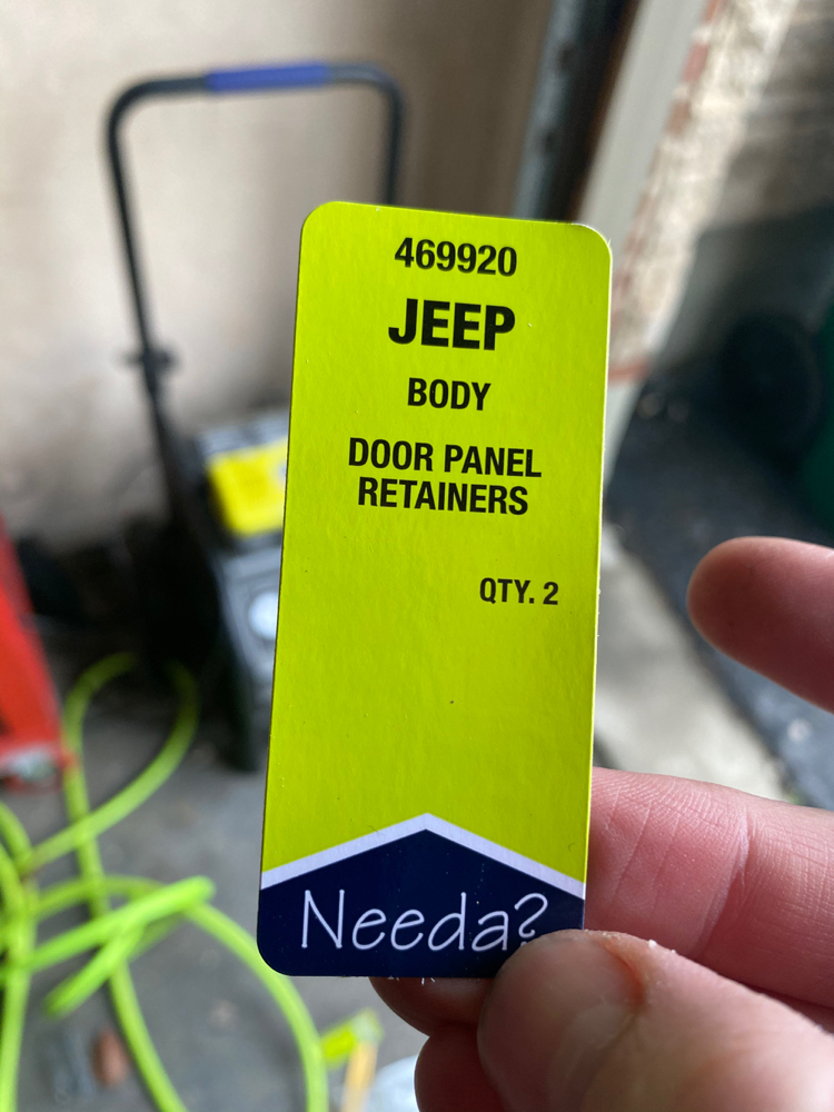

Side skirts, these are well don't match up. I found that Jeep body panel retainers secure to the side skirts and fit in the body holes to secure them to the chassis. Then the normal push retainers can be used form the bottom.

Fender lines will fit right up to front bumper.

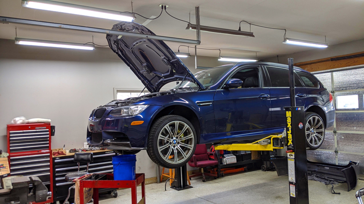

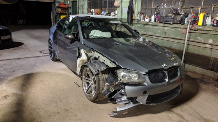

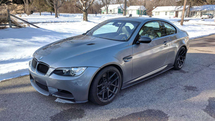

Donor car:
2008 e92 Manual
I had been actively looking for donor for over a year. Right when I was about to completely give up, this one popped up 3 miles from my house on copart. No mileage and listed as non running. I pulled immaculate service records and Carfax and see single owner, last logged 76k miles about 7 months prior. One accident that didn't seem so bad. Front passenger side was damaged, nothing major but body was twisted up in the roofline. I think because it was listed as non running, I got the steal I did. Turned out blown BST cable, all fluids, belts intact and fired right up with 78k miles showing. What luck!

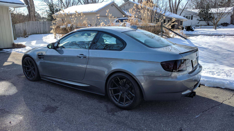

I just did the same thing to an E82. Lovely project! Contemplated an E91 until I settled on a 1M Conversion.

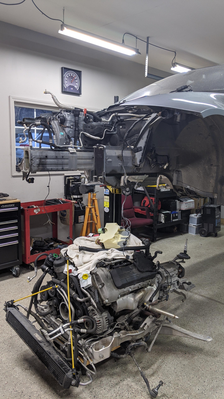

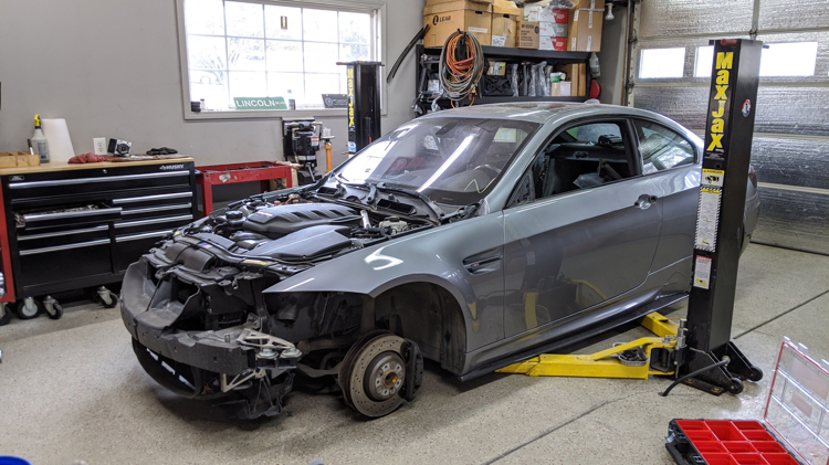

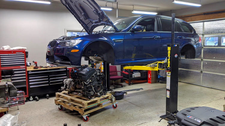

Donor tear down
SOOO FRIGGIN EPIC! Can't wait to do a video on this! :)

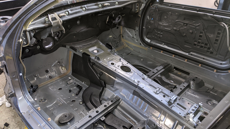

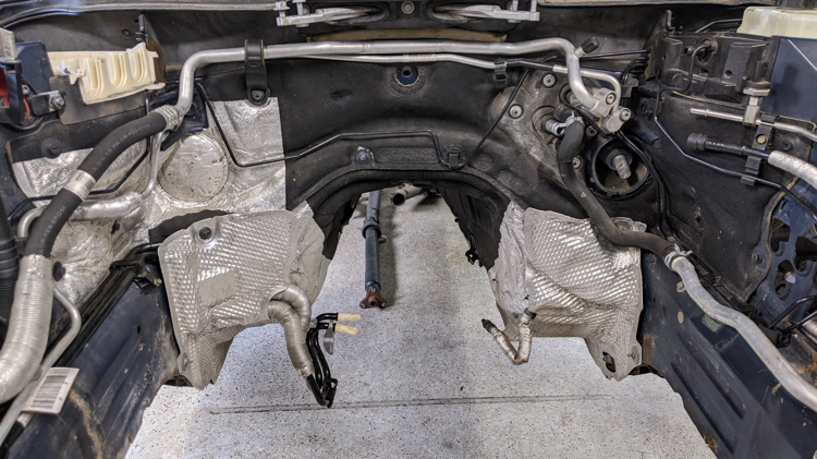

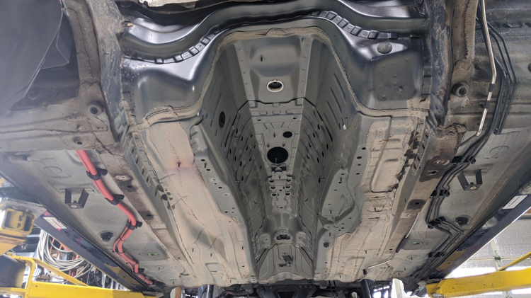

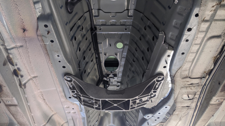

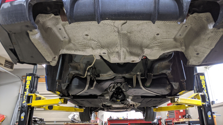

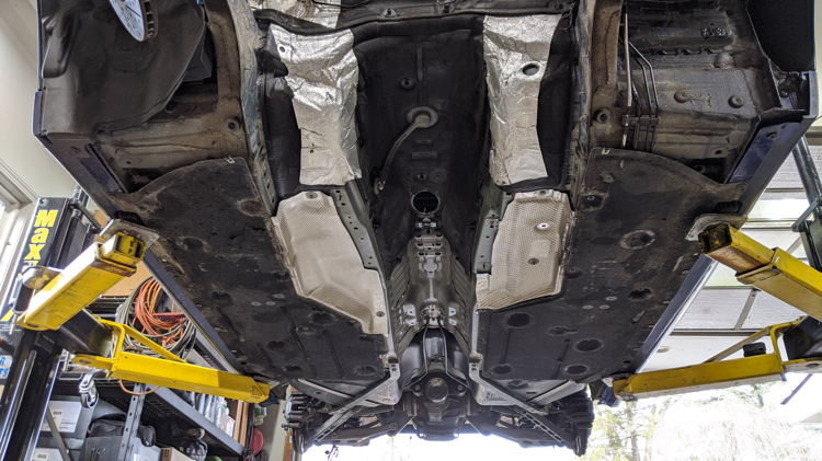

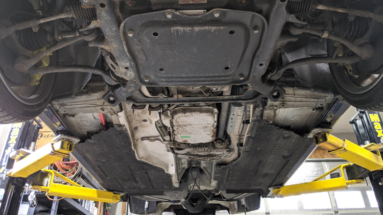

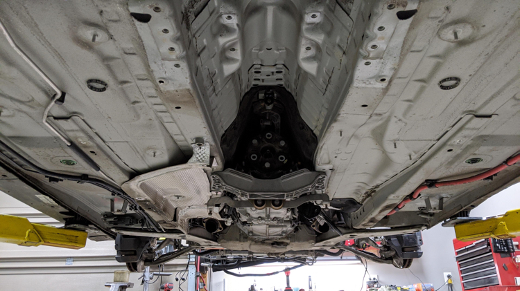

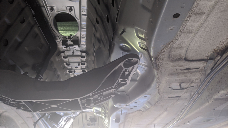

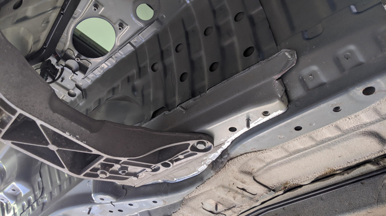

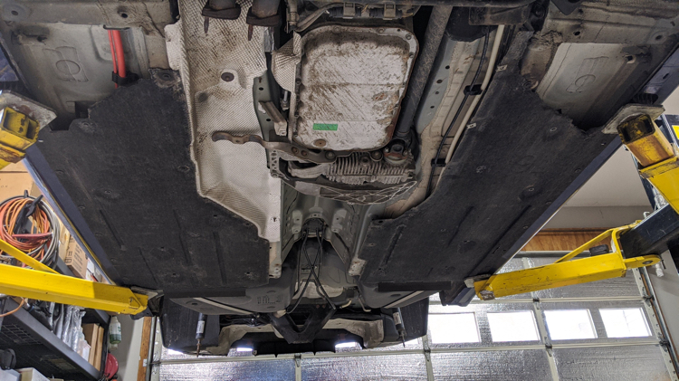

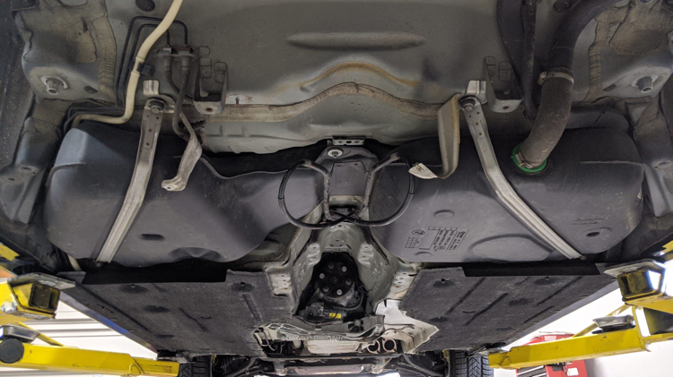

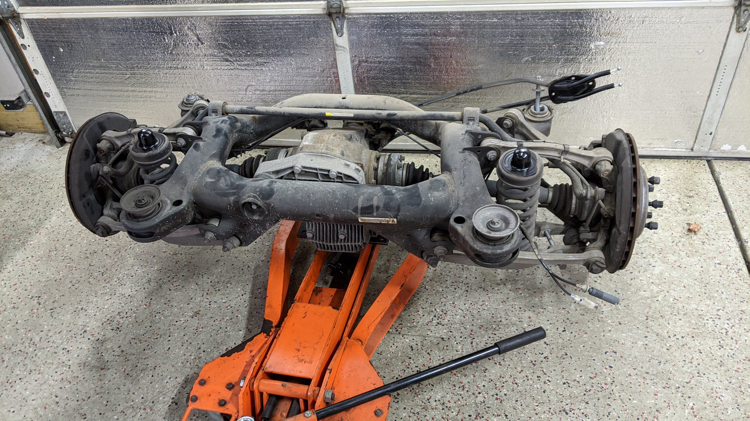

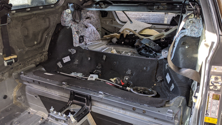

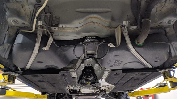

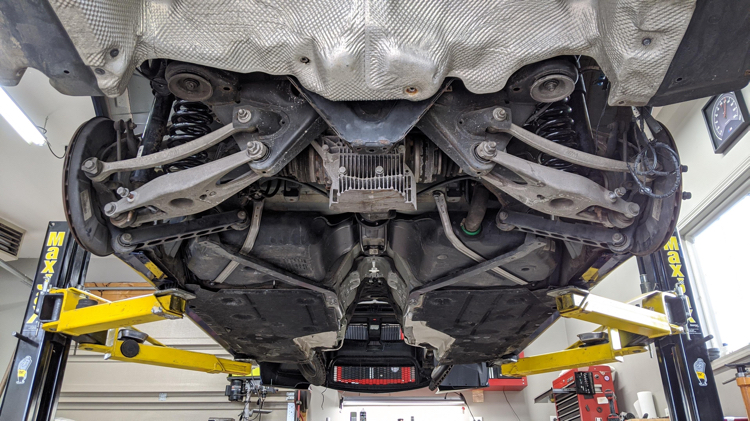

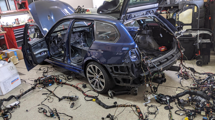

Wagon tear down

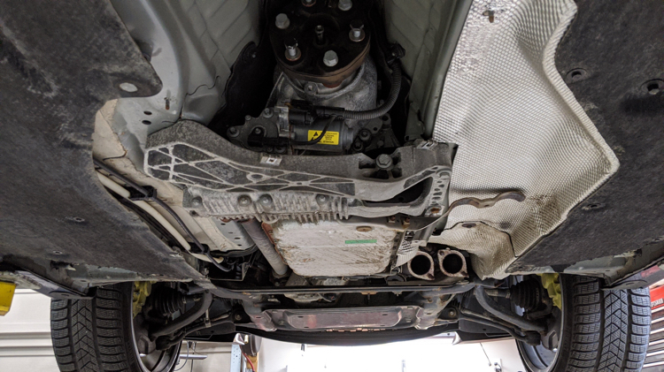

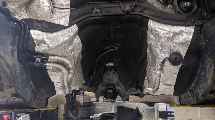

Wagon tear down front and rear sub frames

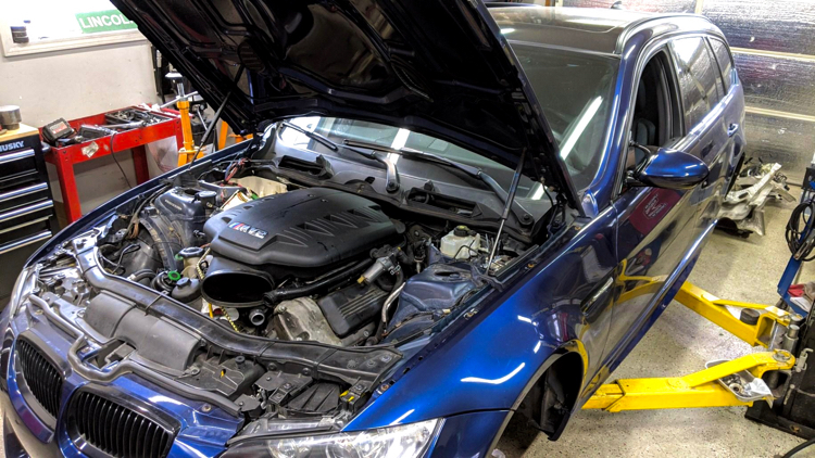

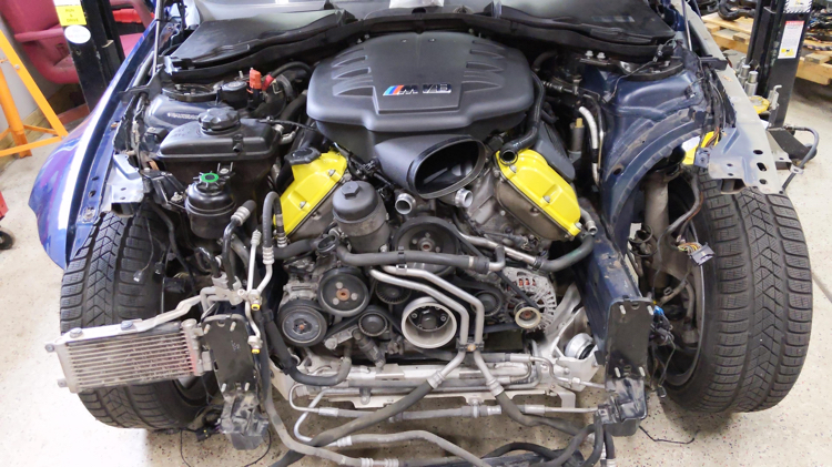

M subframe fitting
More M fitting

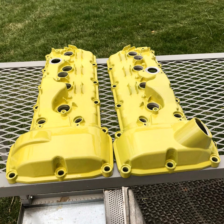

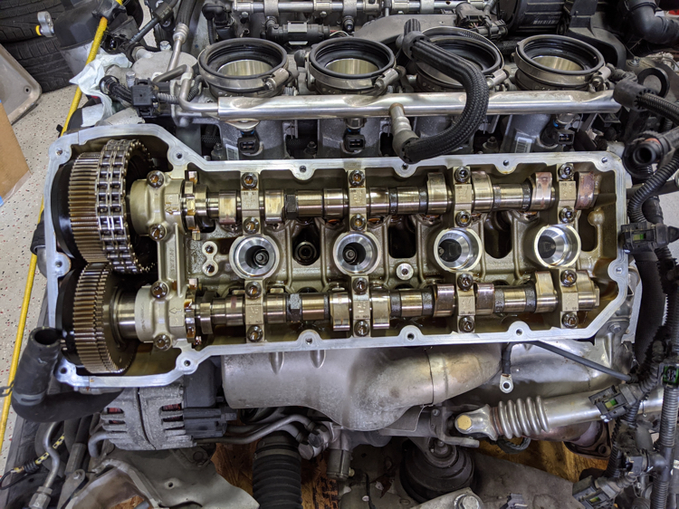

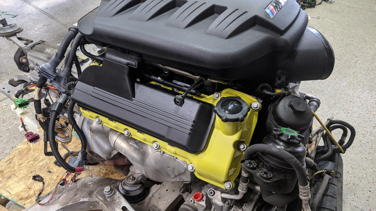

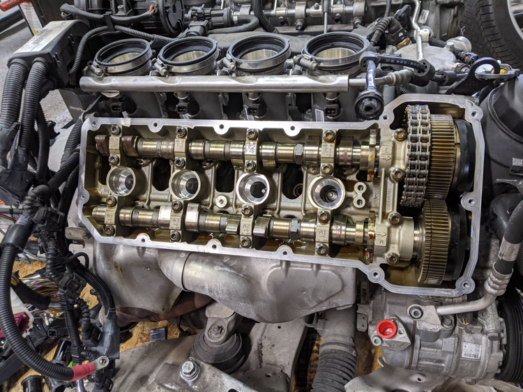

New valve cover and gaskets

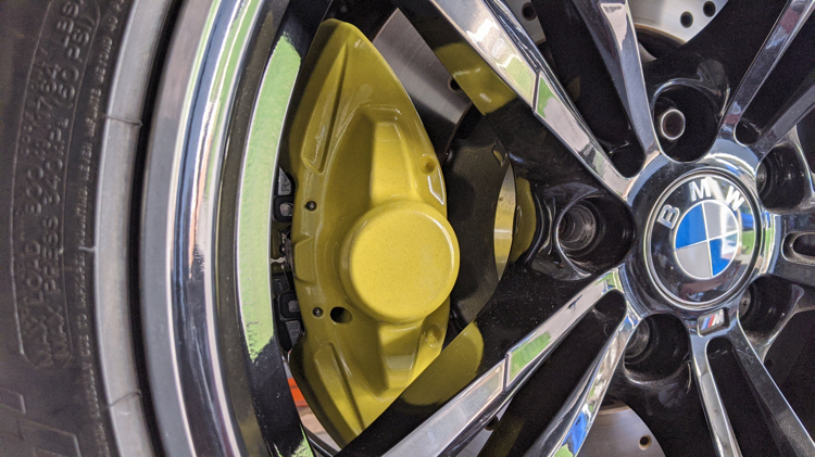

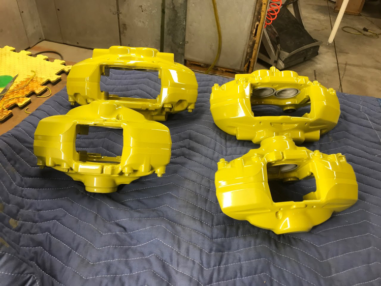

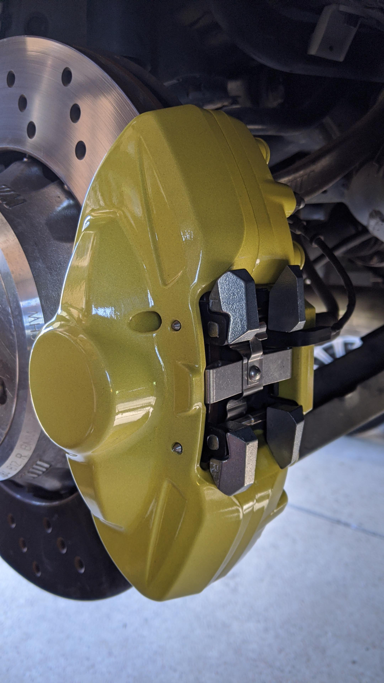

New M4 brakes powder coated Phoenix Yellow to match Valve covers (//M stickers added later)

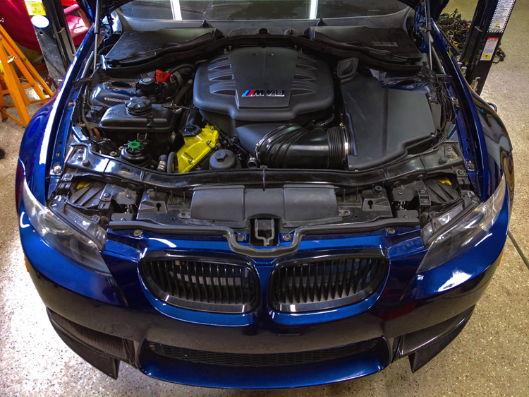

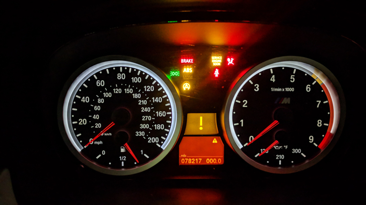

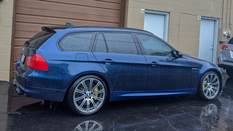

First fire up and test drive, no CELs tracked perfectly straight and no issues.

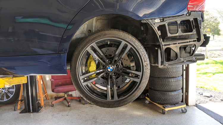

Car is currently getting rear quarters, bumper and paint! Will post more with those updates as I get them

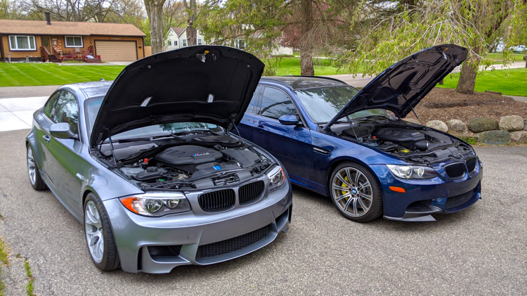

Those are amazing! Here's a side by side you'll love!
