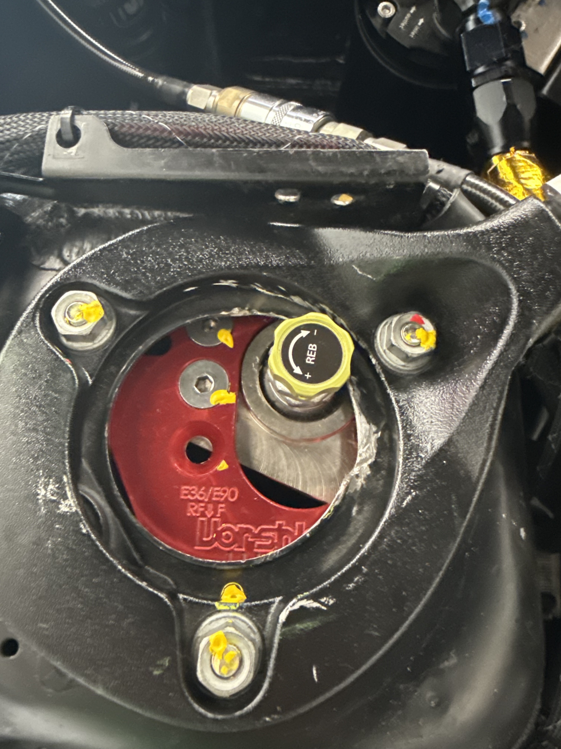

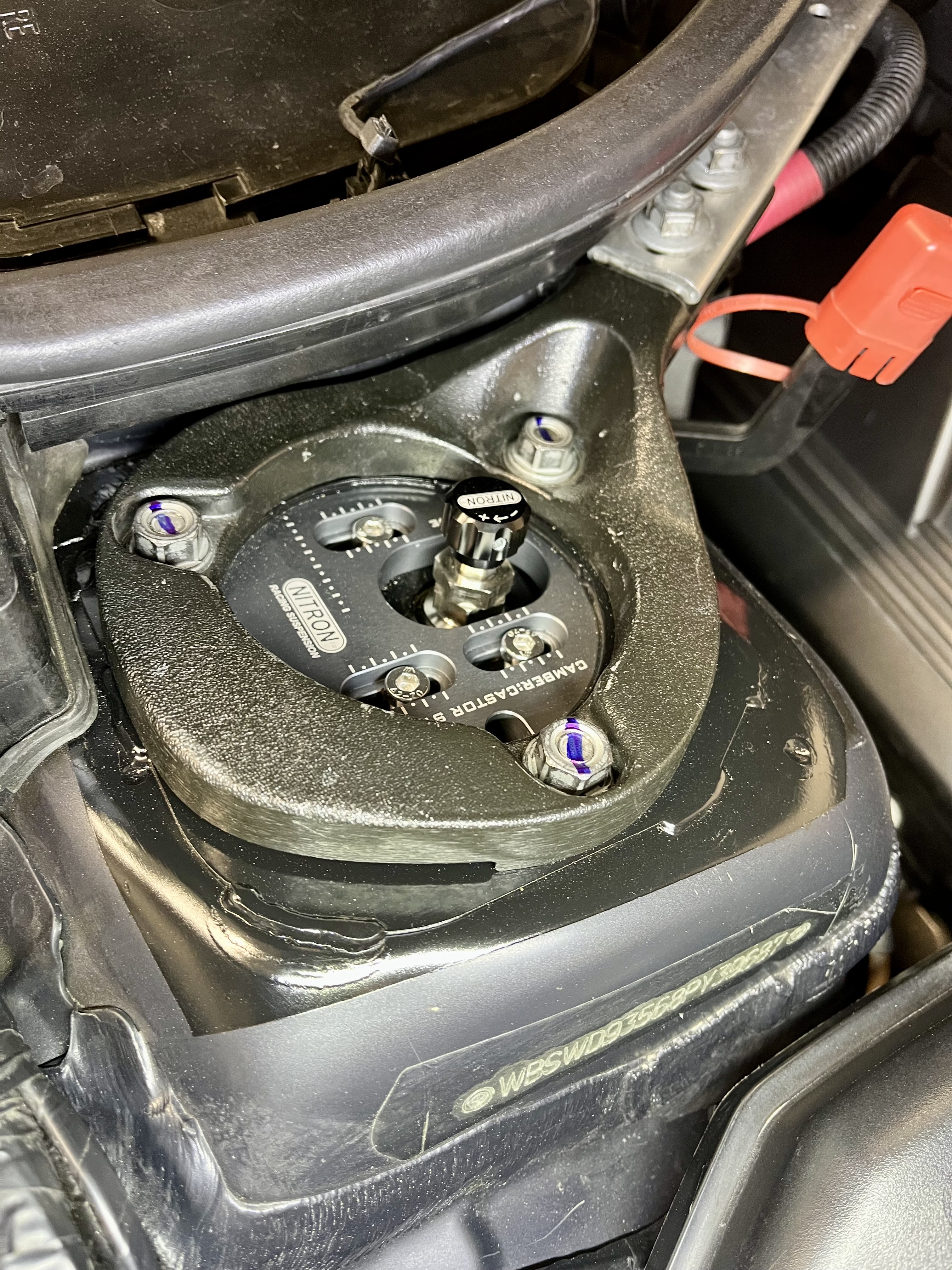

I’m running 3.6-3.8, but my spring rate is a bit lower than most. But these make it safer to run -4+ degree. Without it you can hyper extend the lower control arms as these fix the roll center, the control arms are at a much better neutral position intended by bmw. Also there is a limition on the strut tower. Most camber plates allow the shock shaft to hit or bind with the tower. I developed a enlarged strut tower and reinforcement plate.
Working well.
Thanks for the info. What spring rate are you running? I'll need to double check mine, it's either 800 or 740, I think 800 though.

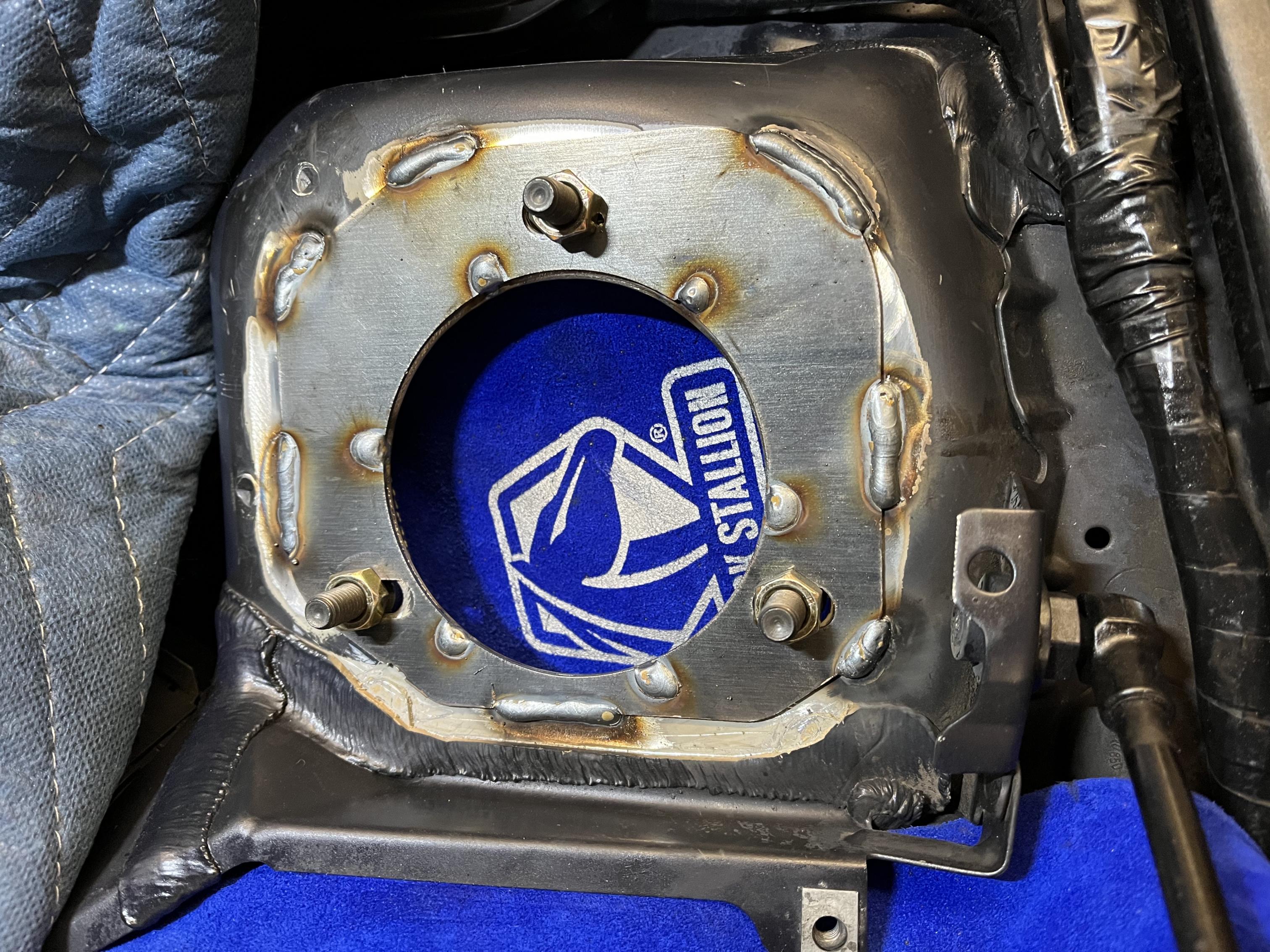

Is that a custom reinforcement plate you had added on, and slotted the holes? I normally slot the strut tower holes, which I'll need to do on mine still.
tlrid3r's user avatartlrid3r

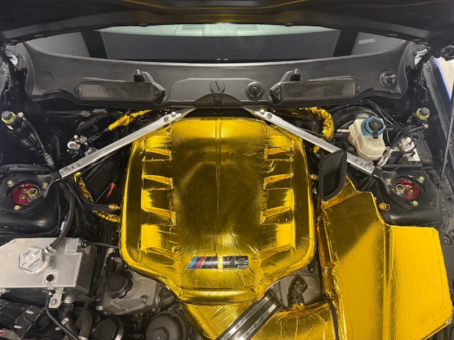

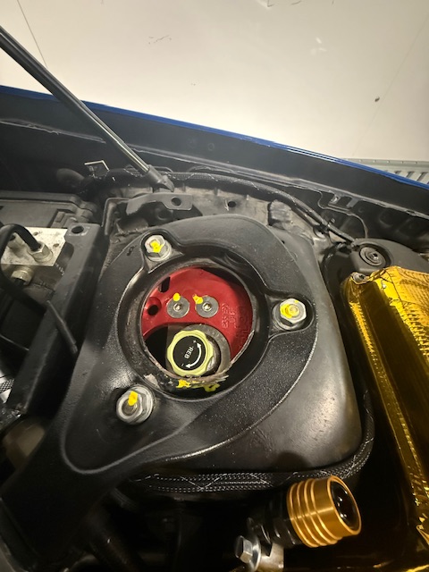

Appears you have the camber plates installed “sideways”. Caster adjustment being used for camber?
Nice job on the cutout. Probably worth reinforcing, no?
They are correct. It matches the instructions and I still doubted so I spoke directly with nitron to confirm.
These camber plates are awesome they allow to adjust camber without changing caster.
It was reinforced you can see. But glad it was done so clean you can barely notice But here is a better picture.

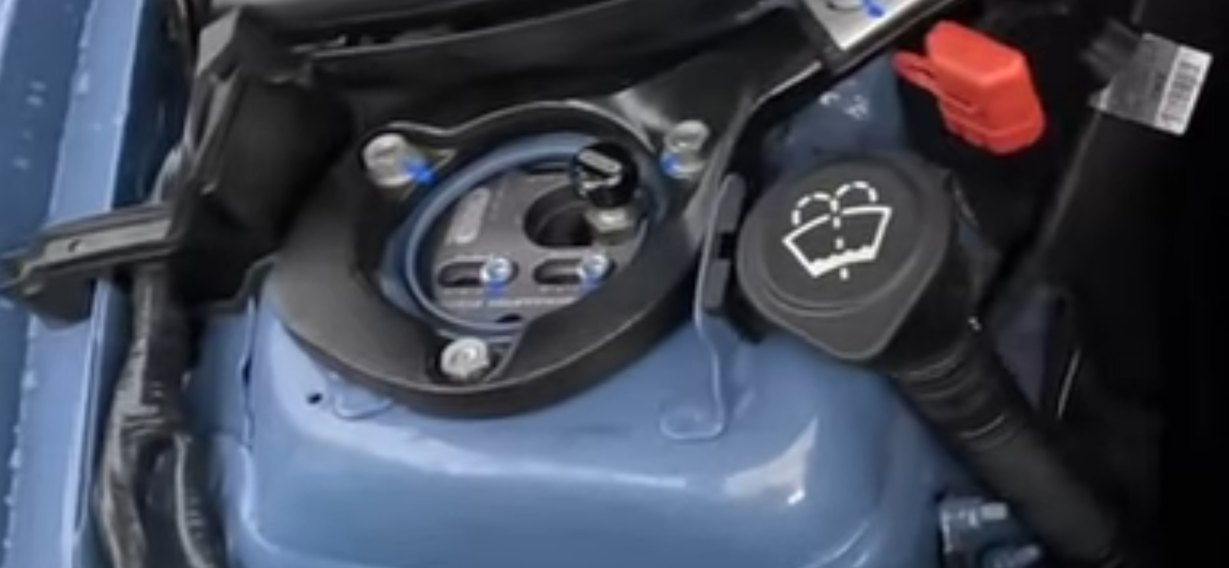

You can also see others user install per instructions.
Video reference ass well
Weird that Nitron would do it the inverse of everyone else. The reinforcement looks nice indeed.

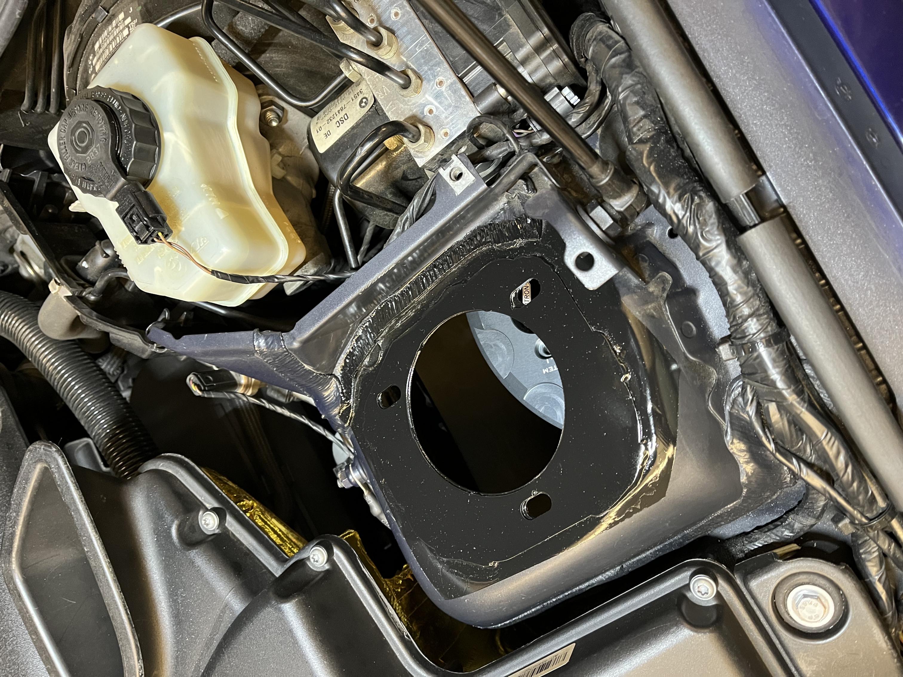

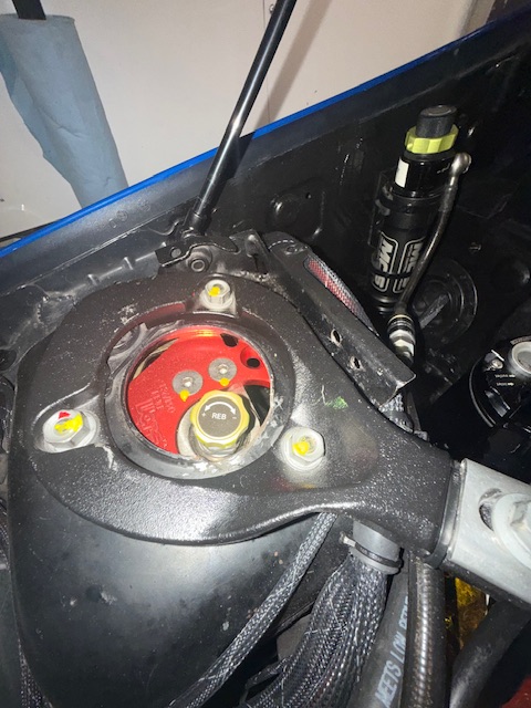

There is a new part coming down the pipeline for the MCS dampers. I got ahold of them and installed. If I want I can now get -4.1-4.4 with the Strom knuckles. I’ve tested them on track with more camber and there is a significant improvement with the car / lap times. Here is how much I had to cut the shock tower. Nothing out of the ordinary.
