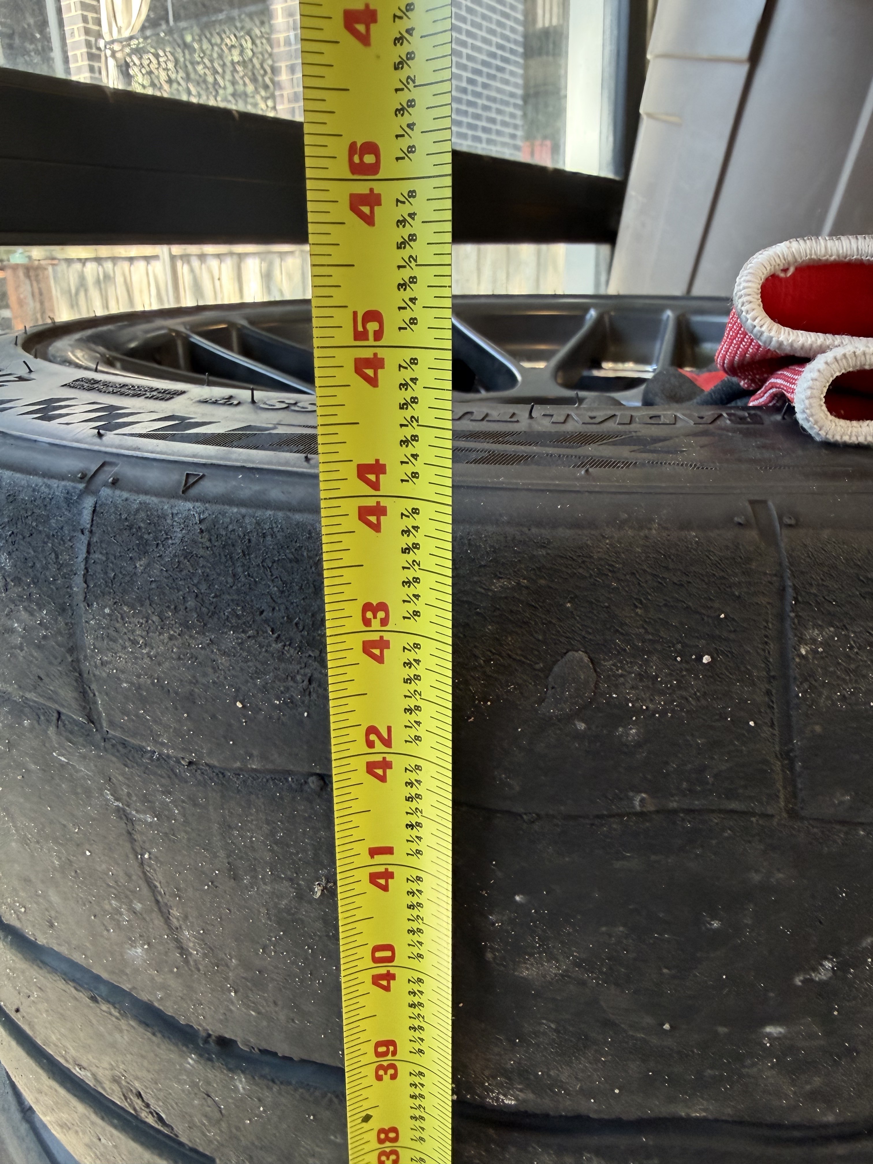

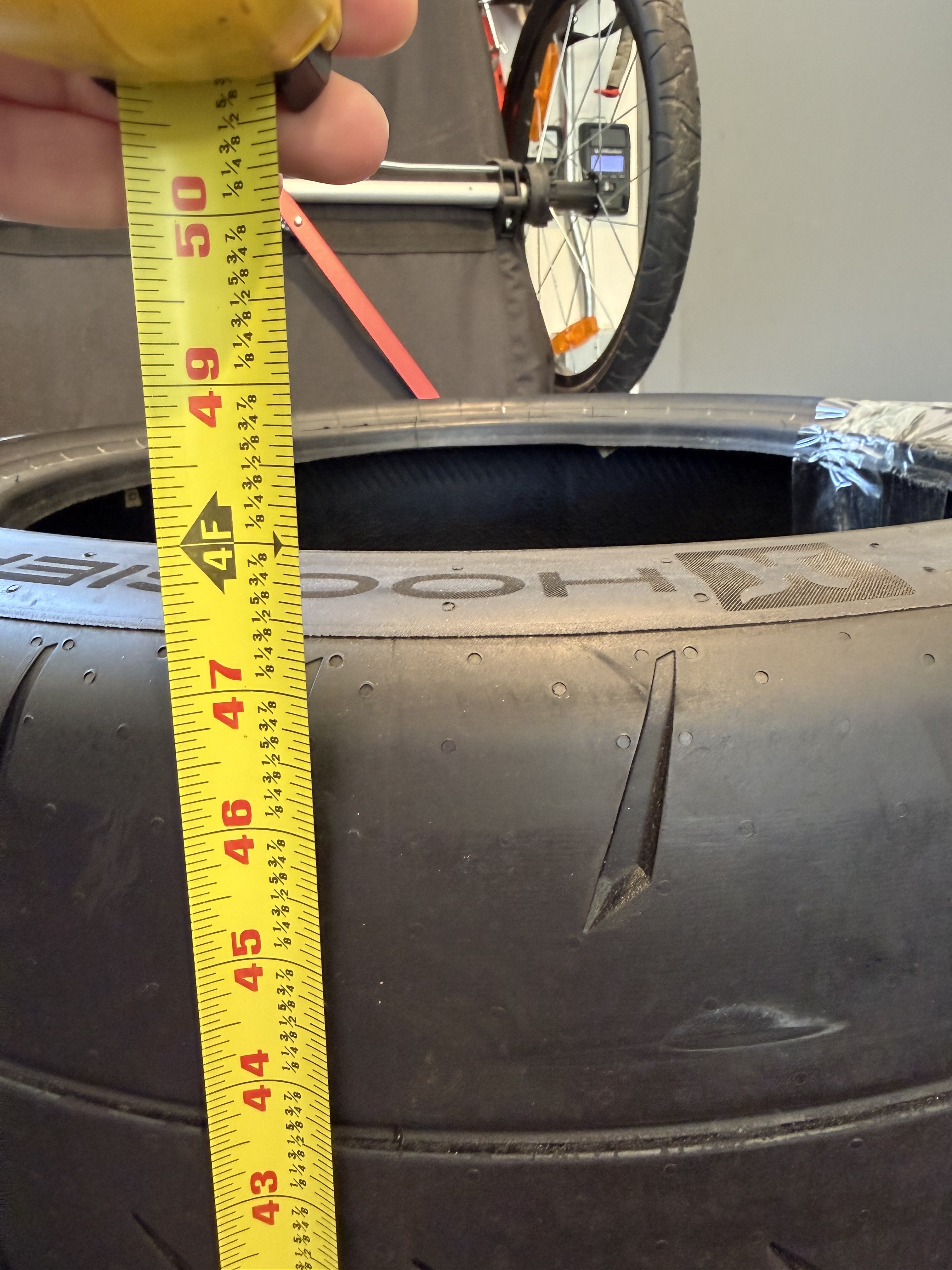

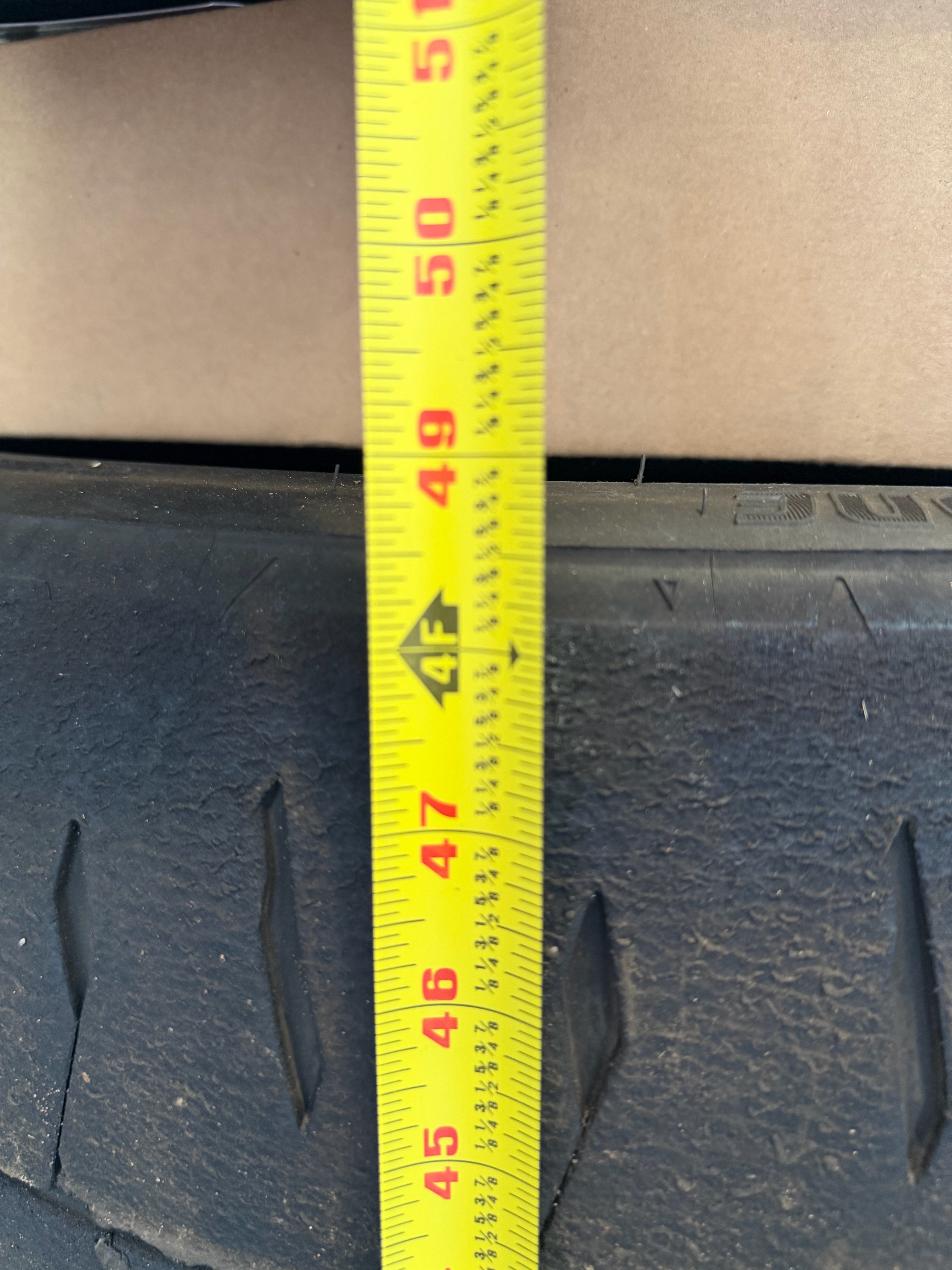

Just for fun, a visual comparison of 275 v730s, vs 285 re71rs, vs 295 htap. The v730s aren’t surprising but look at how wide the Bridgestones run
