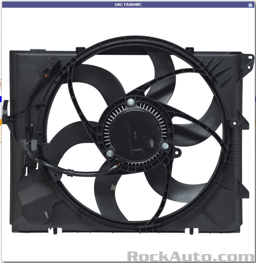

FYI, I found that partsgeek has a UAC part for $306 and ordered it, hopefully it's actually good quality. Will let you know

ok this was an odyssey.
The UAC part from partsgeek did not fit the M3 at all (best I can figure it is meant for a Z4).

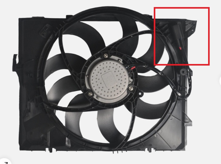

Looks like ebay has an option available now, it correctly lists it as 850w instead of previously, the others were listing the N5x 600w fan incorrectly.
https://ebay.us/shuFcI
Looking at the pictures, although upside down, it looks like the plug is on the correct side, as all non-m fans have the plug on the driver side. So I think this one has a chance of fitting if the pictures are correct.
For $135 might be worth the risk if someone wants to try.
Here is the ebay picture rotated to better tell.
You can tell the UAC part that RockAuto has listed as fitting the M3 is the wrong part because the connector is on the driver side like all non-m, and it's also listed as 600w
