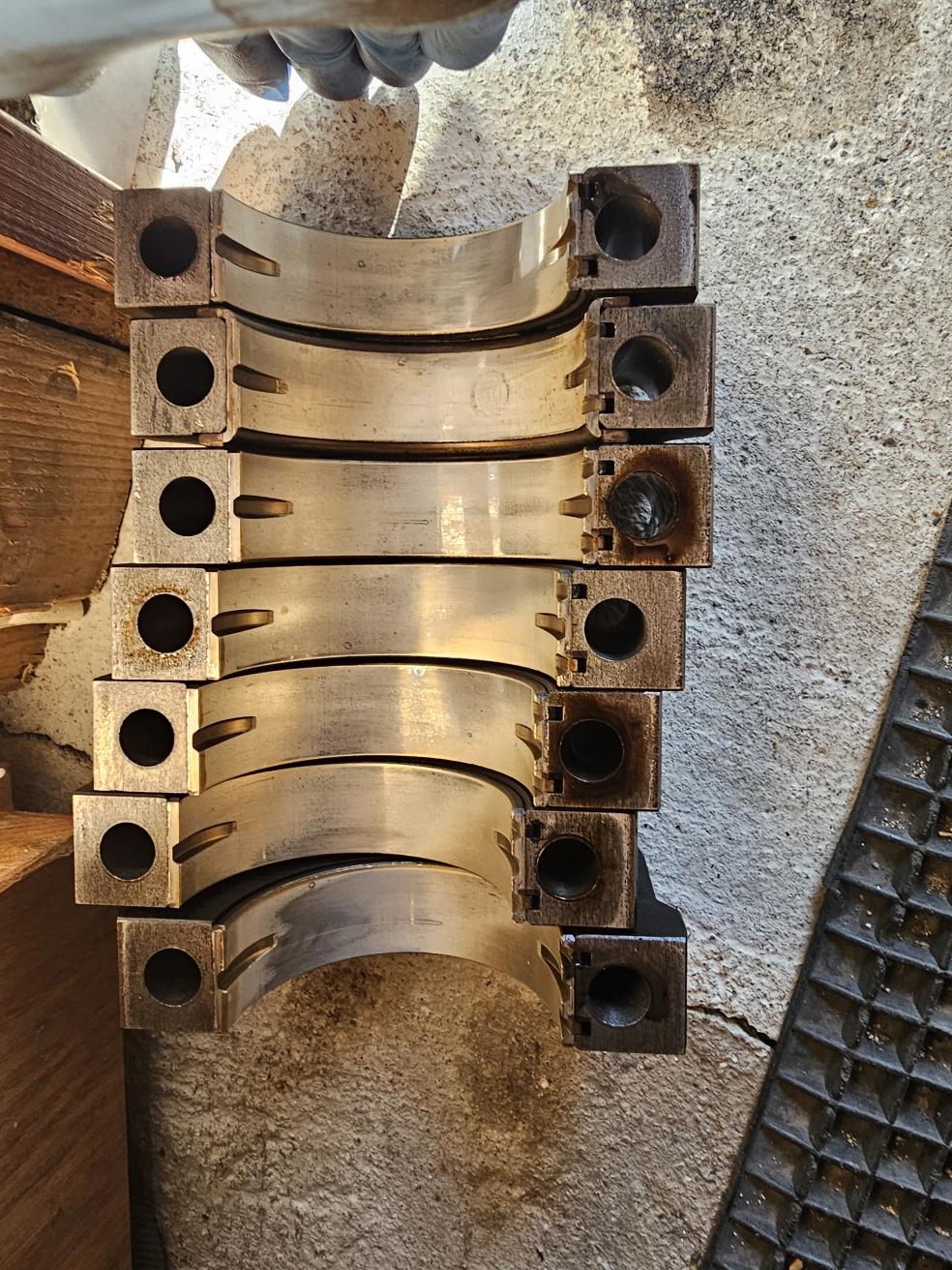

Trying to get this project going this summer. I took out the main bearings from upcoming engine. They look fine apart of two that has some more wear. So new one in order.

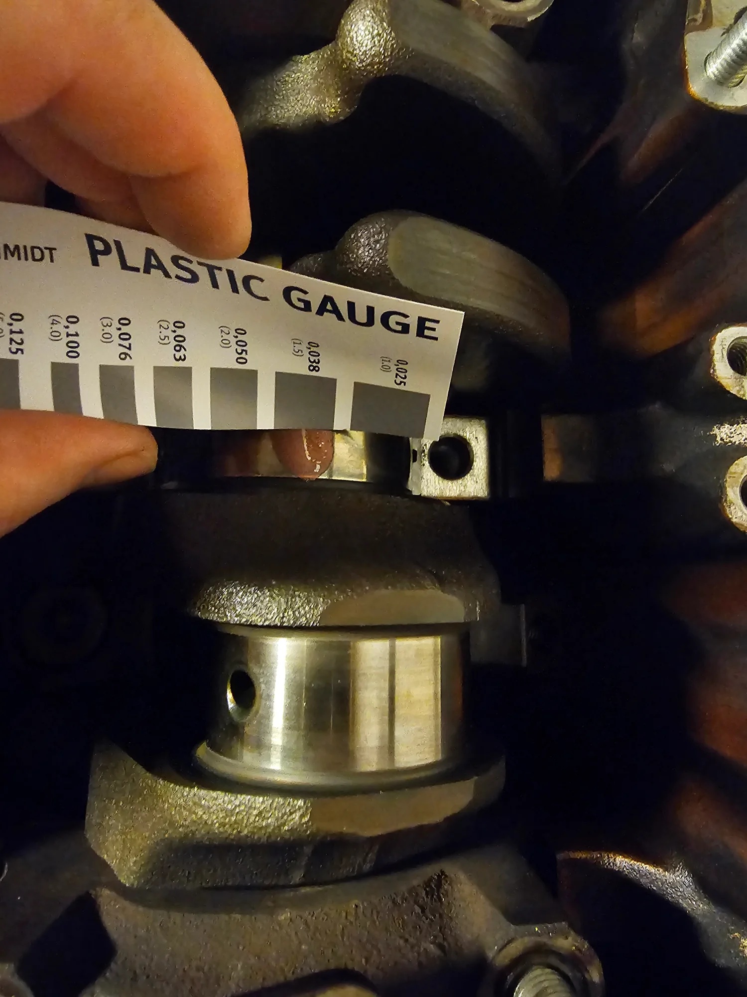

Took out the crank, cleaned everything and put new bearings in. Now I'm waiting for my electric torque wrench to arrive so I can start measuring bearing clearances.

Upper main bearings looked like new, but these are things "while you are in there"

Measured main bearing clearence and all showed the same so all good.
I installed new main bearings with assembly grease. Gotta measure axial play and if it that is with in spec, I can install rod bearings too. I measured them also and all looked good.
