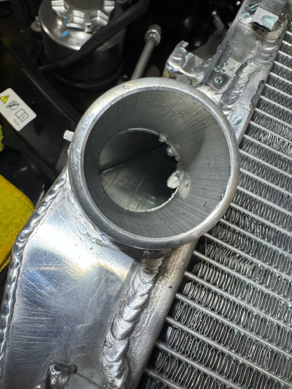

after doing research on cooling system upgrades, it appears DO88 mentioned a lot in this forum, so I bought they're radiator and oil cooler. Upon installing the radiator I notice there's excessive welds on the inside of the lower neck. Other than that the fitment was good, and no issues so far on both the oil cooler and radiator.
It probably have no effect on the performance, but I was just expecting the quality to be higher than CSF, since it's made in Sweden. I have CSF radiator on my E46 M3 and the welds seemed nicer.

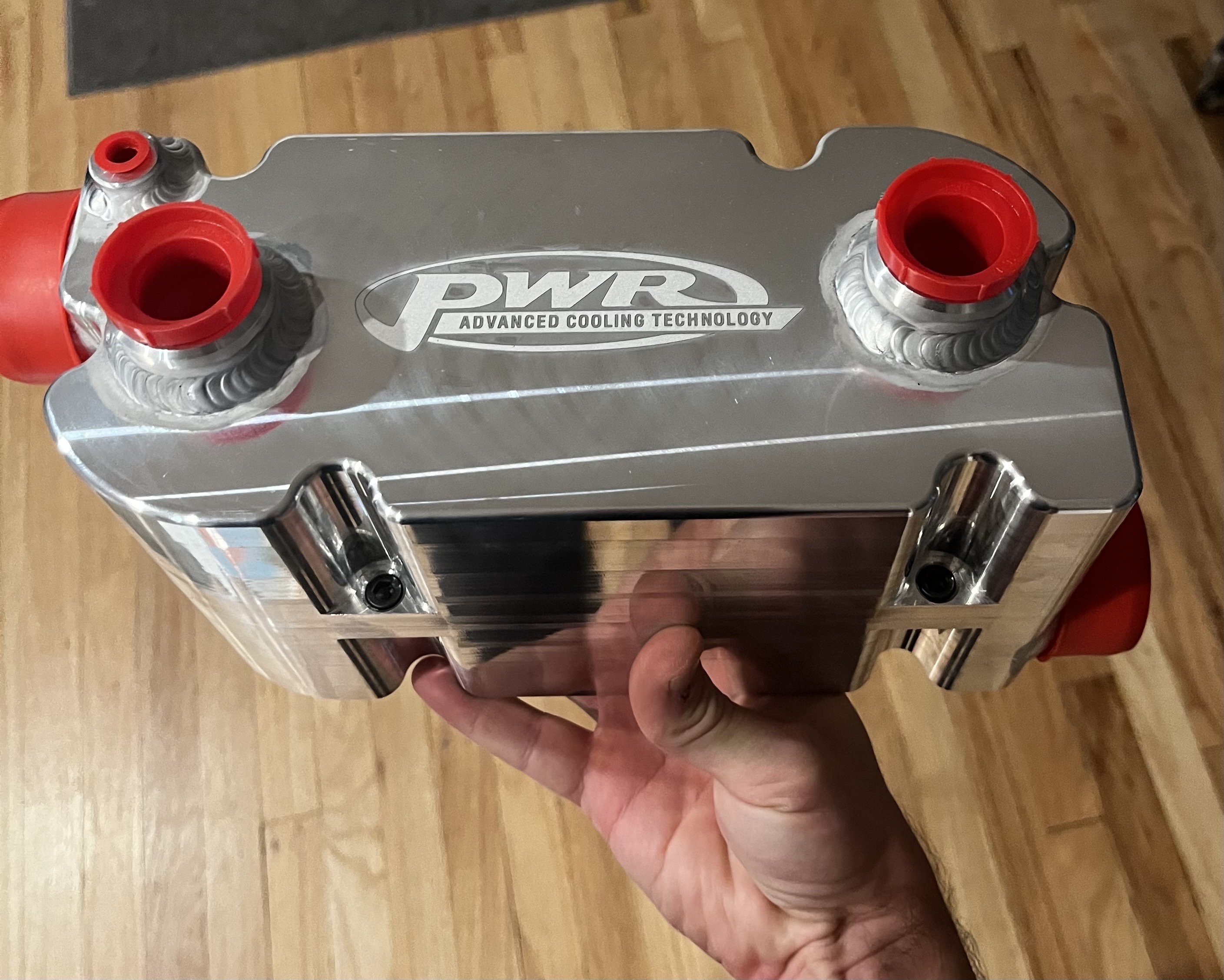

As for PWR, Ive got a PWR rad waiting to go in the car (with some other custom cooling goodies from them) but they’re not plug and play. They don’t have pass through space for the ac lines (not a big deal if you don’t have it) or the power steering cooler hard lines. They also don’t have mounting provisions for the PS cooler or ac condenser either. It’s on my list to get it in still but not an easy thing to do and keep all factory mountings.

PWR is very far from plug and play. They don’t have provisions for the PS cooler it ac condenser. You either need to redo all of the lines or notch the cooler itself and find a way to bolt the other coolers in the stack to it.
