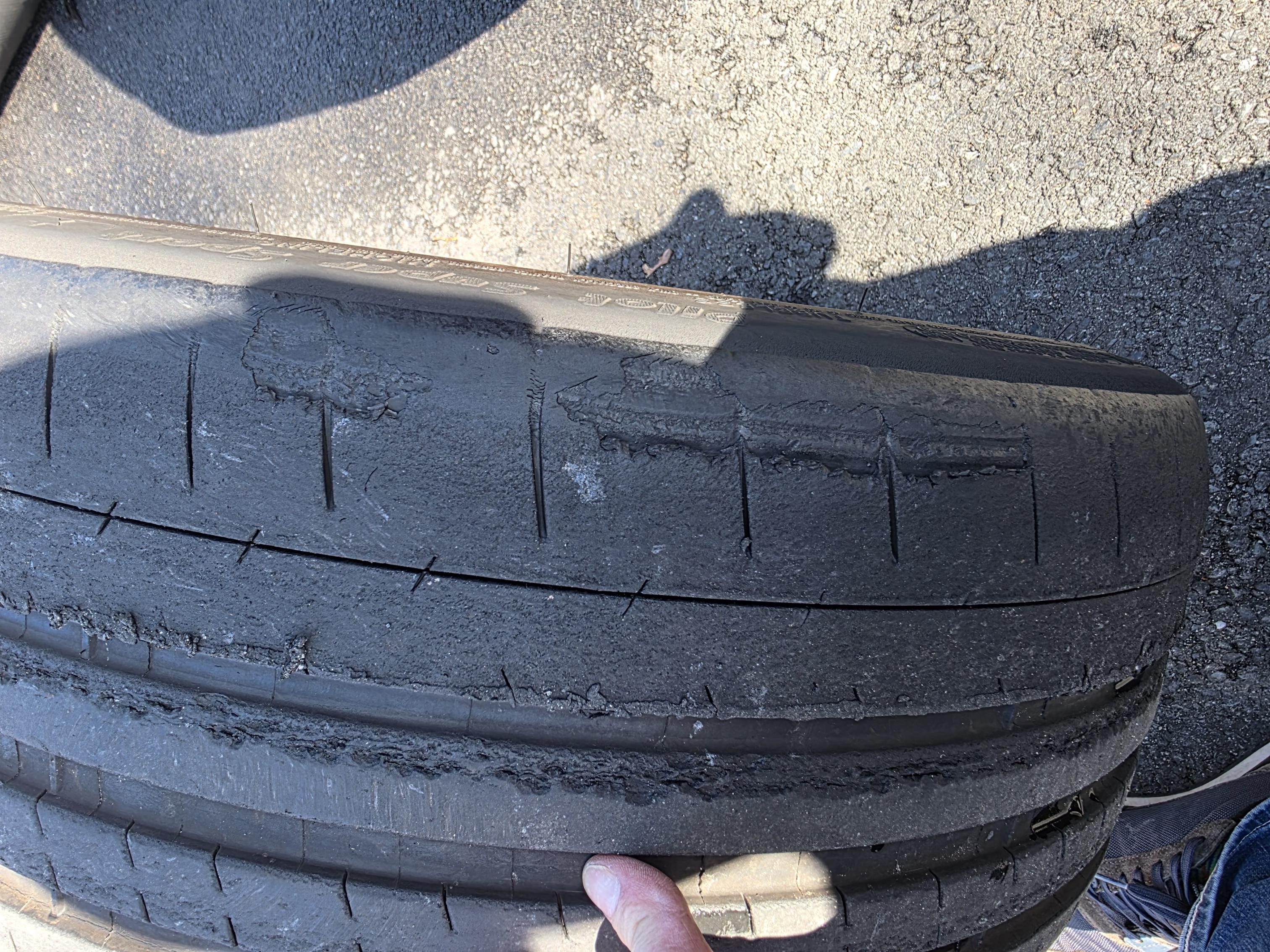

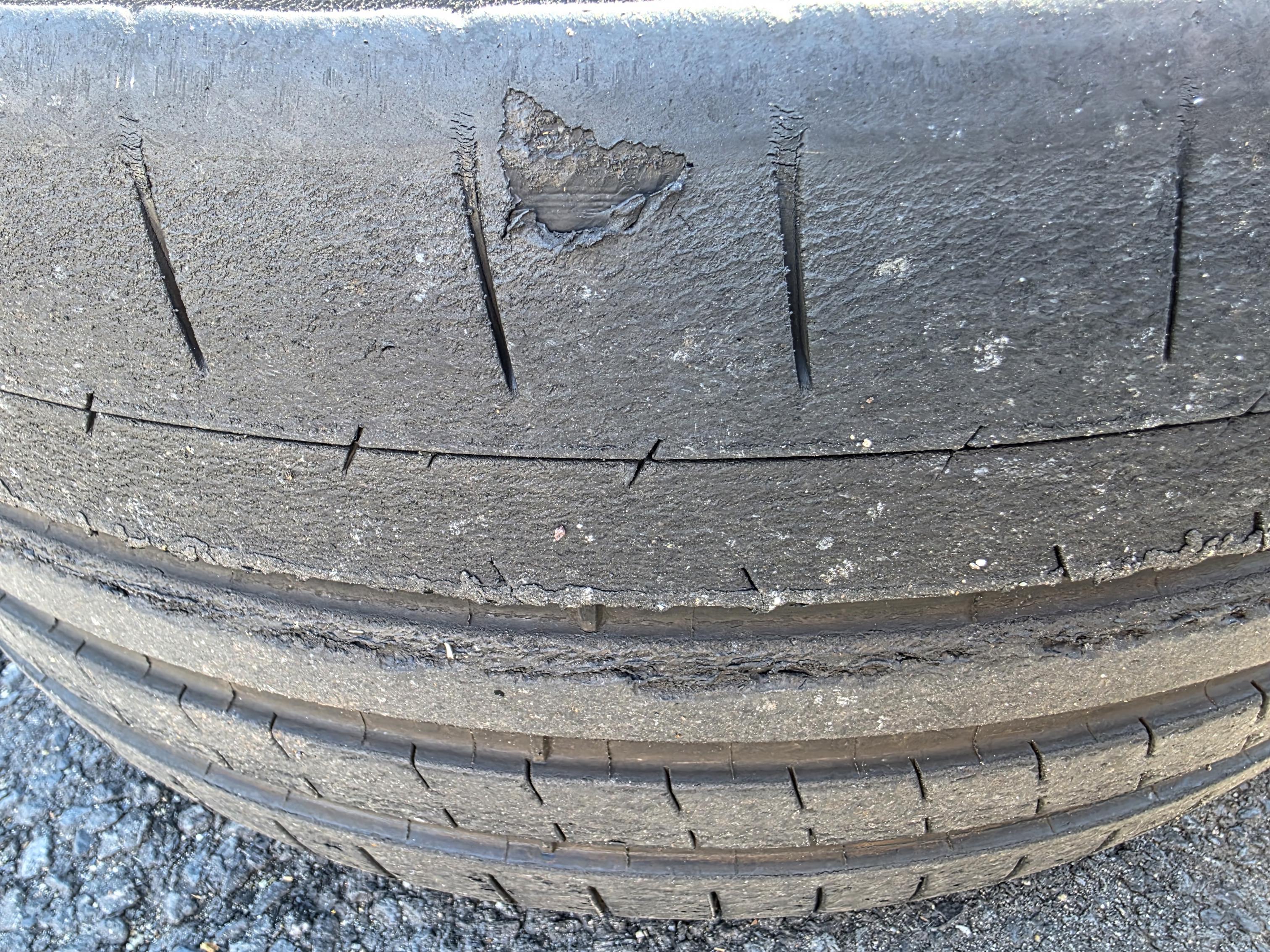

I ran 3 hours on the Thompson Speedway track yesterday, and my front left tire... got destroyed really. What is the best, easiest to install camber plate you guys recommend?

These are Michelin Pilot Supersports. Rears and right side look ok, no holes in them from overheating :)
I guess I can do 2 more track days with this if I swap it on the other side, no?
Just kidding :)
What were your hot pressures?
Tried to keep under 40, so about 37 - 38. But again, this track is VERY heavy on front left tire, a few right hander hairpins, first one coming down from the straight where I hit 122mph...
My left brake pad (inner) got completely shaved, when I got home is was metal to metal . It was less than half worn when I started, but DS2500s do wear quickly on track, that was me being a fool.
I have the pins removed to get max camber, so it's at -1.5 or so. I bought Dinan camber plates and I hope they do give you an extra 0.7, so with 2.5 I should be fine I guess...

Higher pressures will be better, as you will want the sidewall to be as stiff as it can be. I dont think i would go with a "stickier" tire, as its just going to force the tire to roll over more. Are you using the factory springs? If not, I would go with the Swift specR. They're a little bit stiffer, and might help keeping the car from rolling as much (in a right turn, the body roll will pull the outside tire from the bottom, decreasing camber.) Not sure if a bigger sway bar will help, as that might make the front end skate in tighter turns.

On this track If I go over 40 things get ugly.. understeer
Land and rear swinging like crazy I am mostly drifting :)

LOL - are you blaming the tires for over heating. :lol:?
I am not where did I say that? It's my fault... I did drive almost 100 % that day... to be expected.

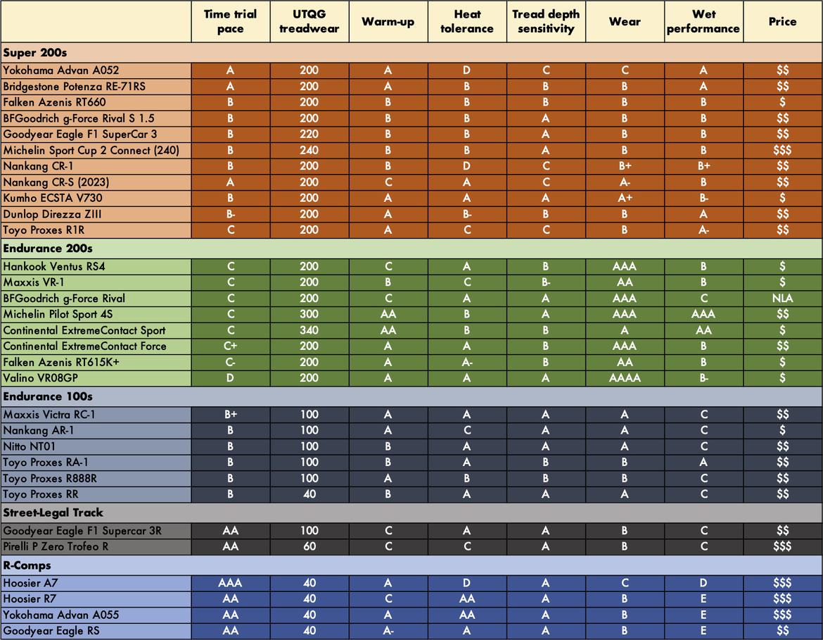

Here's a chart from Grass Roots Motorsports showing their test data for streetable track tires. To avoid tread compound delamination (chunking and tearing) due to the tread compound over heating on track, use at least -3.0 degrees of front camber, less steer angle when the front tires are at their limit (i.e. avoid temptation to dial in even more steer angle), avoid hot tread compound temps over 200F (come into the pits hot and measure temp data), use a pyrometer to dial in tread temperatures with <= 10F temp spread between inner and outer shoulders. For streetable (DOT legal) track tires, maintain a hot temperature ceiling of <=40psi on a car weighing less than ~4000lbs. Start with cooler cold temps if the ceiling is being exceeded.
Edit: See all of the "care and feeding" files attached and Michelin Motorsports .pdf tire catalog link: https://adzktgbqdq.cloudimg.io/https://dgaddcosprod.blob.core.windows.net/cxf-multisite/clsq28vx9001a11mh1x0t9t5w/attachments/h52isnn0t41k7capy44kxuxf-michelin-motorsport-db-2025-a4-en-us-250206-digital-board-compressed.pdf

Check out the GRM tire guide occasionally. DrFerry's image is a good rundown of the options but I believe they have updated it since and they do so every few months.
