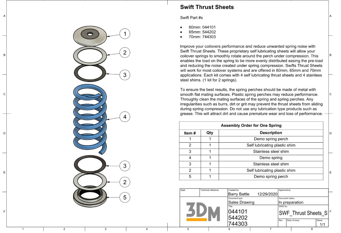

Anyone running Swift Thrust Sheets with Ohlins R&T? Any difference before and after? Wondering if any downsides. Don't want to introduce noise in attempts to prevent it...
They're supposed to be used on either end of the spring, but talking with Barry at 3DM seems you can take a hybrid approach with them at the bottom of the front spring and the top of the rear.
There is no downside. A coil spring wants to twist as it is compressed so thrust sheets release the torsional DOF and allow the spring to twist.
The front upper strut mounts and camber plates have a thrust bearing that releases the torsional DOF so technically only thrust sheets are needed at the bottom (it doesn’t hurt anything to add thrust sheets at the top. As for the rear, thrust sheets should be used at the bottom and the top. Below is a drawing from 3DM showing thrust sheets are used at the bottom (items # 2 and 3) and the top (items # 2 and 3).

Think of the end caps as being generic place holders. Regardless of whether it’s a front strut, front coilover (e.g. na1 NSX, ap1/ap2 s2000), divorced rear spring or a coilover rear spring, the spring still rotates as it is compressed and, therefore, the torsional DOF needs to be released to eliminate stick-slip (or bind-slip). I’ve been using thrust sheets on rear divorced spring setups and front struts for 16 years, and Torrington roller bearings before that. Torrington bearings are a maintenance nightmare because it is not sealed so debris gets into the roller bearings. Thrust sheets don’t have maintenance issues.
I have the sheets on top and bottom of my Ohlins R&T springs, both front and rear. They are cheap and Barry at 3DM told me it would be good when I set up the Ohlins about 3 years ago.
It's been a few thousand miles and several track days and I don't have noise or other weird issues.

I assume you're running linear springs instead of what comes in the kit. That's good to know, should hopefully be no different if running on one end only.
I used thrust sheets on my fronts to try to get rid of a noise I had but they didn't help. Didn't really hurt either. Turns out the noise was from tie rods.

You should be fine with either thrust sheet approach. You can always install one more pair of thrust sheets per rear divorced spring if you find the spring binding. Also, to eliminate the concern of the steel sheet sitting on a rubber isolator, you could place an additional thin steel ring shim on top of the rubber isolator before installing the thrust steel sheet so it rides on another piece of steel, not rubber.

Adding them won’t hurt anything but will it address your issue? I’m not sure. Based on your description, it seems your binding issue shows up after a short drive of at least 15 min. What happens if you stop after only a 5 or 10 min drive? Is there no thumping and/or binding feeling as you are sawing the steering wheel to the left and right? Spring binding typically doesn’t have a time component to it - it’s either always there or it’s not there and that’s why I’m not sure thrust sheets will address your issue. However, I personally always recommend to everyone that they should be running Swift thrust sheets because they help the spring to rotate freely as the spring is compressed/extended and they are maintenance free unlike Torrington roller bearings.

Adding thrust sheets is a relatively inexpensive option (labor is where the cost is unless you can do the work yourself) and one I would definitely try before starting over with a new setup.
