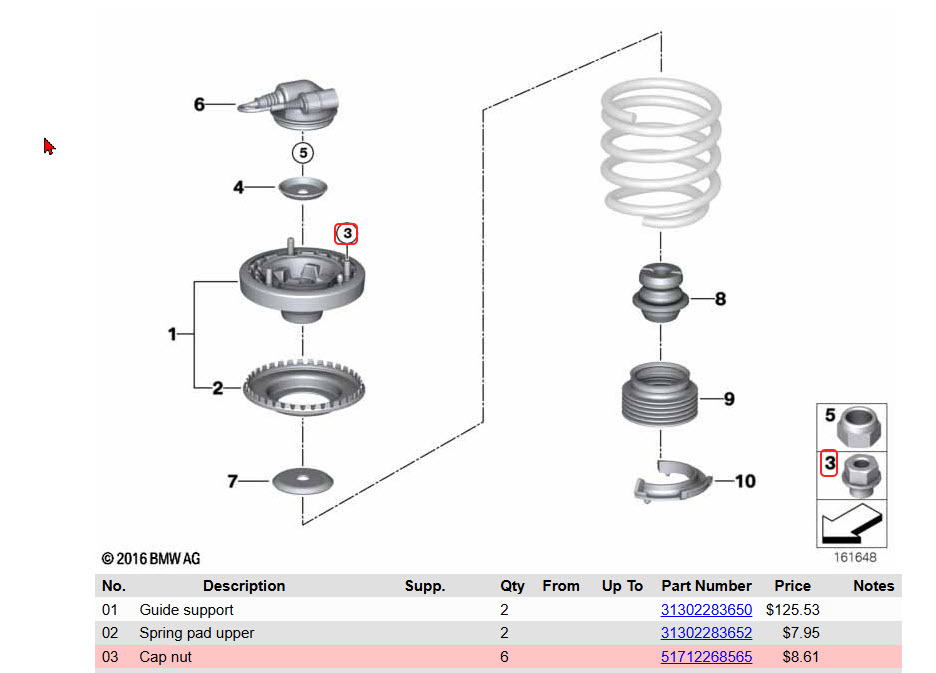

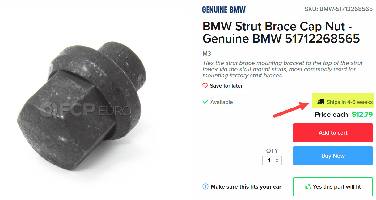

I'm wondering if the 3 nuts used to secure each front upper strut mount to the shock tower can be re-used or if they need to be replaced.
I'm asking as these nuts seem to be backordered or have a 4-6 week lead time so I'm guessing people just re-use them.
