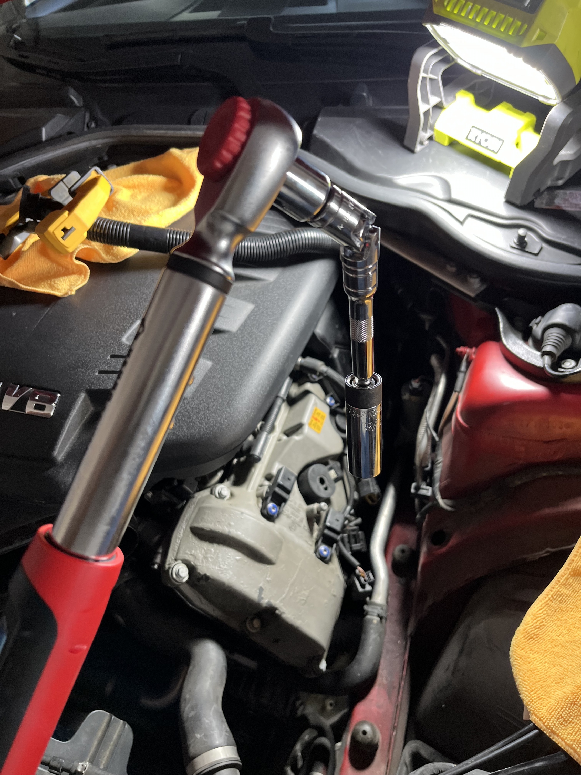

- You don’t need a puller for the ignition coils. A dull screw driver on the opposite side of the electrical plug will work fine. Pull up with your fingers gasping the ignition coil plug location and lever your screwdriver on the other side so the coil more or less is getting pulled straight out.
- You do need elbows and a flexible spark plug socket. I preferred magnetic to my grippy spark plug 5/8” one.

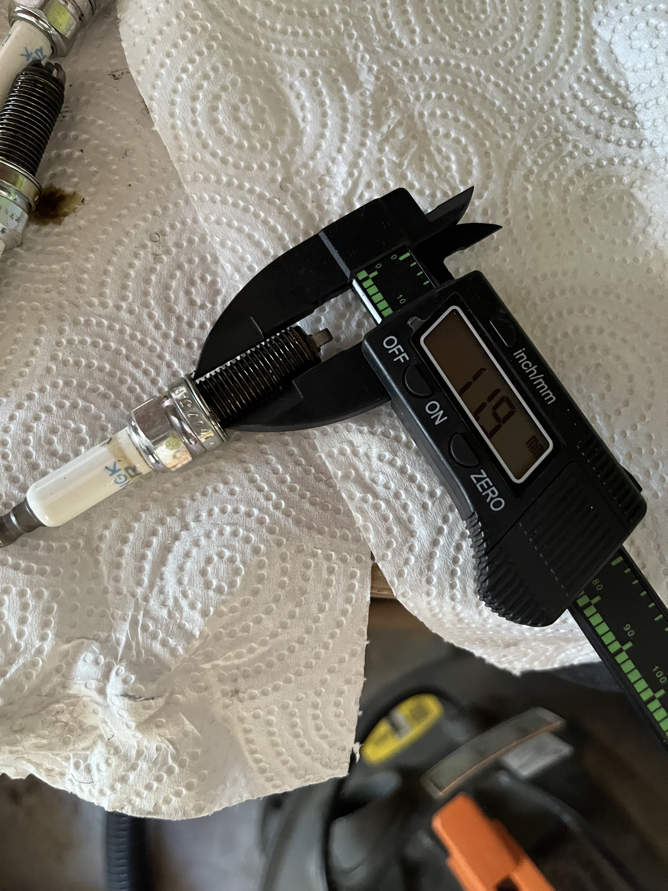

- ISTA says 23 Nm for torque if the threads are M12. Mine are, I measured. (30Nm is for M14 threads) Tolerance for either is +/- 3Nm.
You’ll need to take off the air box and loosen the coolant expansion tank. Otherwise you can reach everything with a little creativity. This also gave me a chance to see my engine mounts are shot. Woohoo…
I hope the pictures of my elbows and measurement help!
