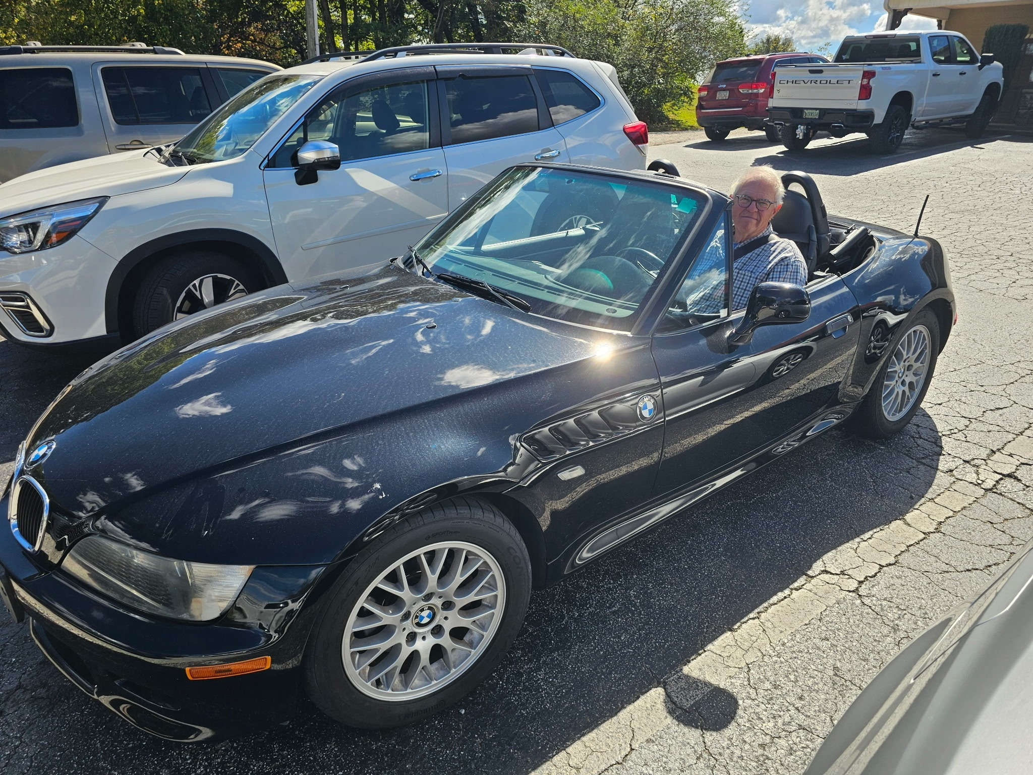

Just acquired my first BMW, a classic Z with under 50k miles. I have driven Miatas for years and there is no comparison between the two. Thus is truly a driving machine. My only concern with it is the gearbox- the Miatas were always so smooth to shift, but this Z seems to kind of grind in every gear, and I can hear a slight clanking noise in the lower gears. I took it by a transmission shop and they said “probably nothing to worry about,” but it bothers me. What do you think?
Having said all that, as much as I love it, I think I have outgrown my fascination with tiny roadsters and it may be time to move on. I have had a 64 Corvette, two MG Midgets, a ‘63 Pontiac Tempest V-8 convertible (ok, not a roadster but close,) a 2001 Boxster, 3 Miatas, and now this little jewel, and have enjoyed them all. But I’m about to turn 80, and just getting in and out of it is a chore. So I’m looking for a good home for it. Here are the details:
Located near Atlanta
2.5 engine
49,000 miles
Black on black on black
5-speed
Very, very nice, inside and out, except for two almost imperceptible hail dents in the hood - perfect top - almost perfect rear window
Custom BMW floormats
Kenwood radio installed, original radio included
Four almost new tires
Need to get no less than $10,500
If interested please respond here
