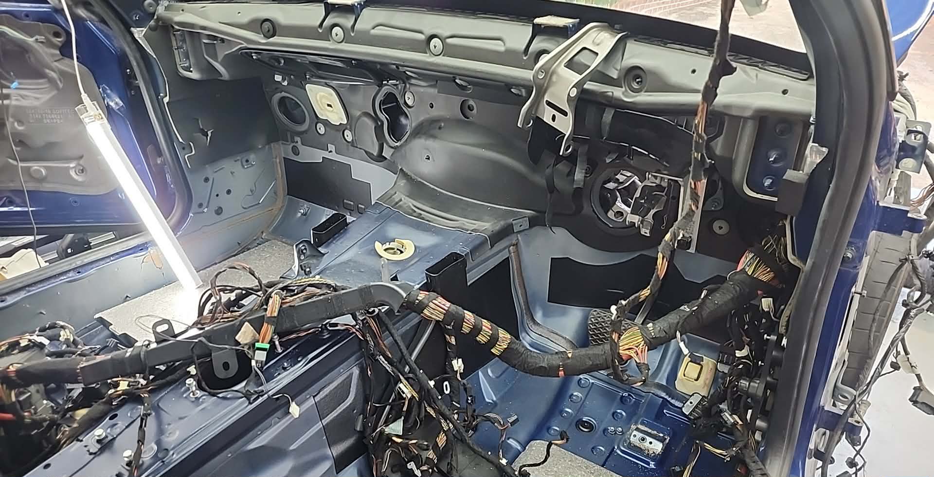

Hi Guy's.
Hope someone in this group can help.

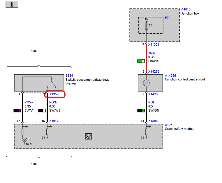

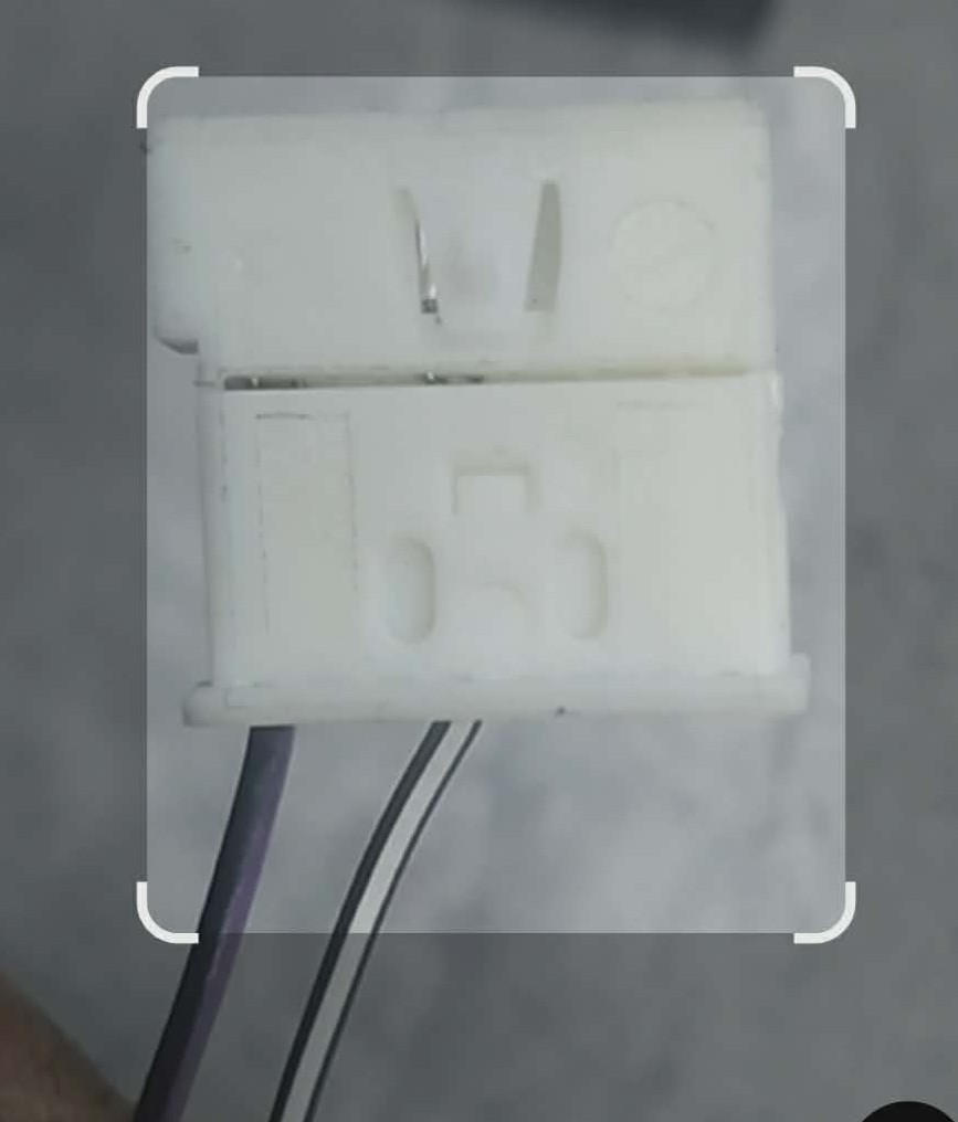

I'm currently swapping a wiring harness E92 M3 and I have Labeled this connection wrong. it's on the Passenger side & together with the glove box wires.
It's for passenger side airbag cutoff switch. May not exist in your car but I think they all have the wiring for whatever reason.
Great find!

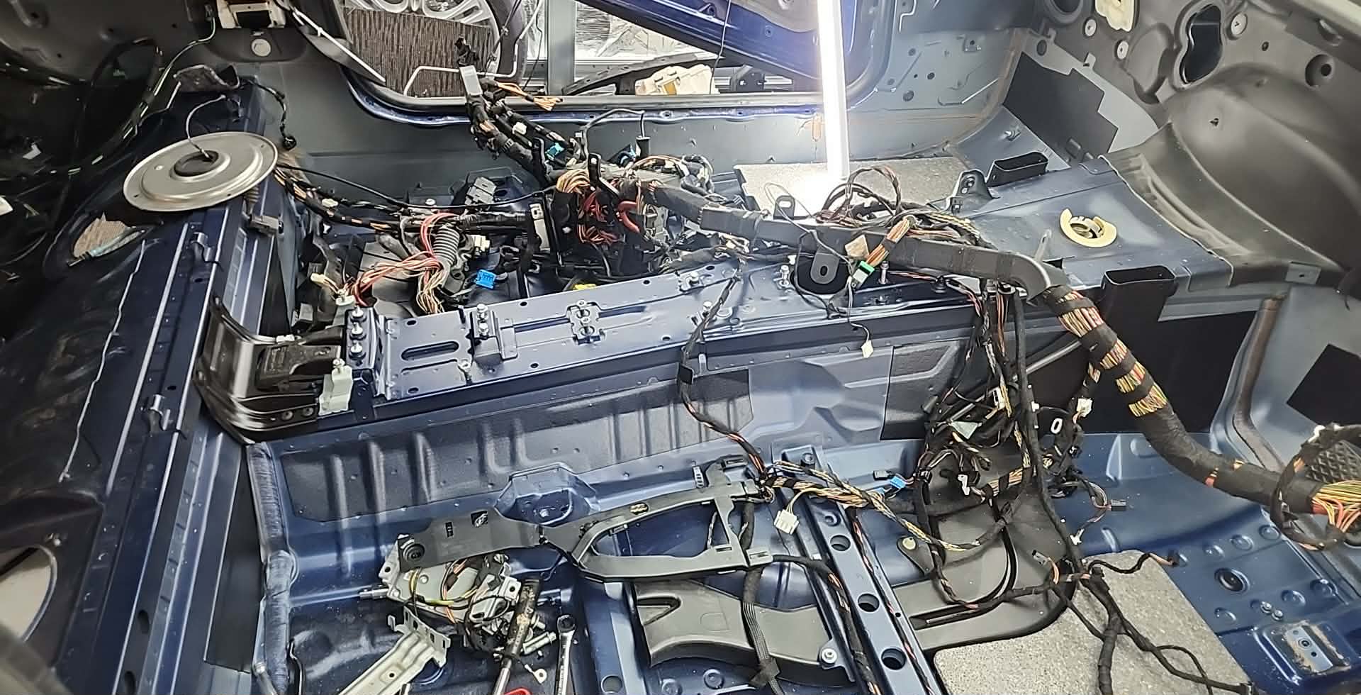

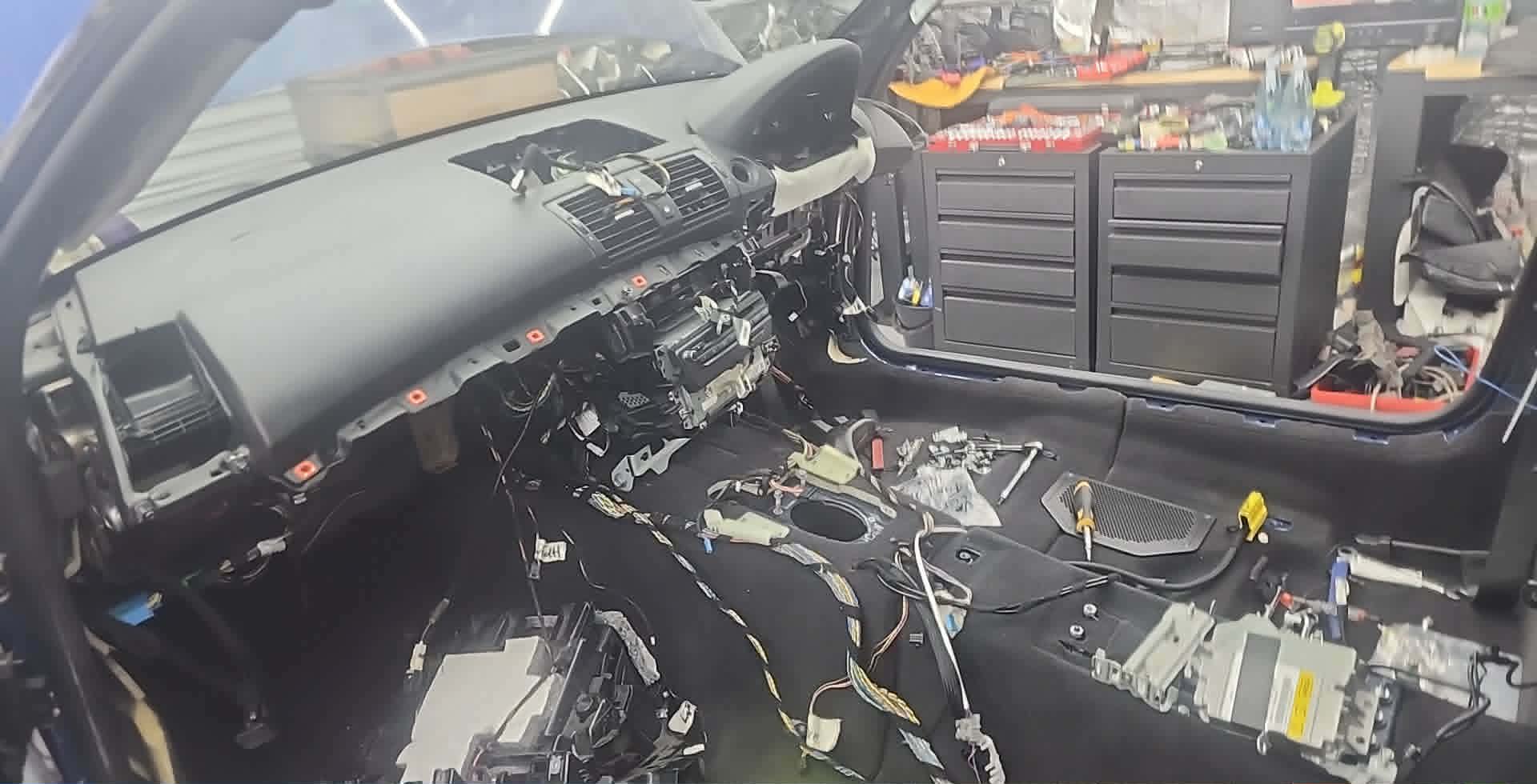

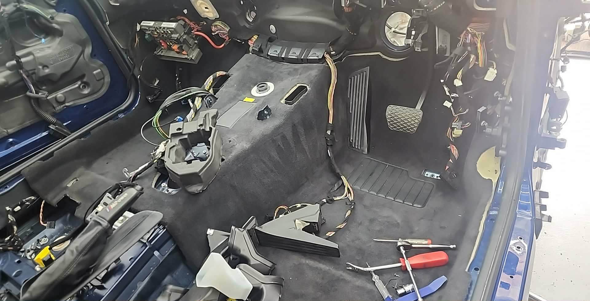

Why may i ask are you swapping wiring harnesses? I have a unique issue on my vehicle that i may need to do the same and wondering the best route
I would bet it would have something to do with an S65 in an E82 Coupe. Same reason I know so much about the E9x/E82 wiring harness.

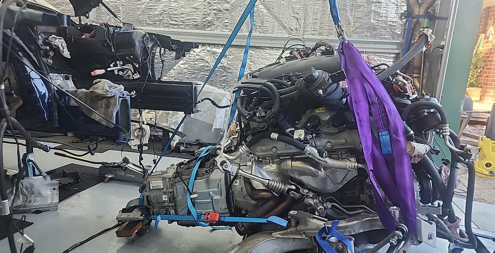

As amg6975 has Mentioned. I'm doing a Harroped S65 Swap into a E82. I Purchased a complete E92m3 and swapping everything I can. which includes the whole Harness.
Here are some Pictures of the Progress
