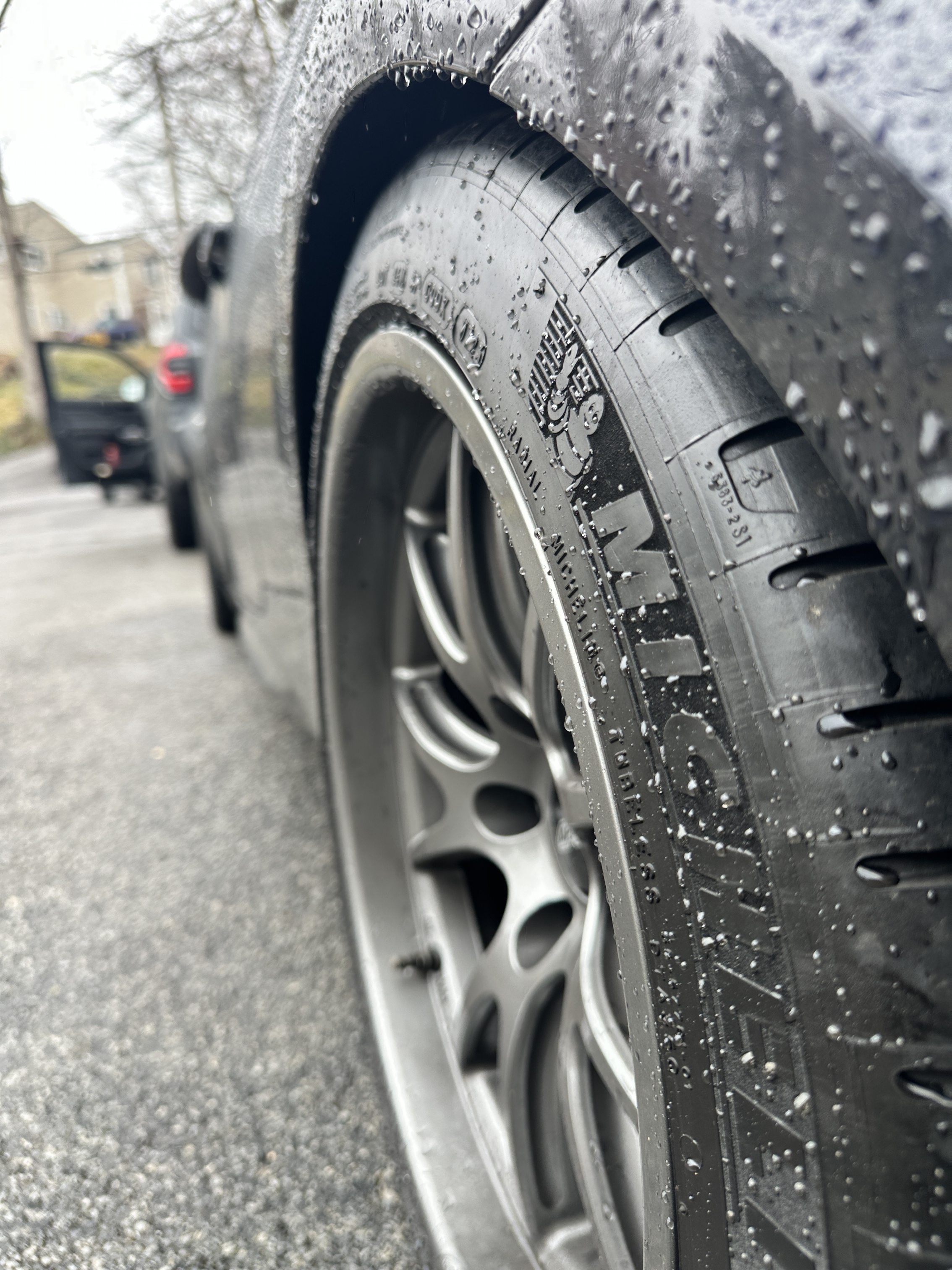

I recently re-purchased my 2011 e93 and I’m looking to purchase a set of summer tires. There is still room in the front to fill the wheel well (see attached pics) and I wouldn’t mind a larger overall wheel / tire look in the process. That front pic is a pirelli but the Michelin had the same gap

1. In the Front run 275/35 vs 265/35
2. Pick a tire that is more sq shouldered (but I love the PS4s)
Neither of those two get me a bigger wheel/ tire combo look … would
Also like thoughts on bumping to 40 from 35 on the sidewall spec

I have 9.5"/10.5" 265/285 as well. I don't think there's a better choice. You could go with a tire like cup 2 that has a fatter sidewall which will fill out a tiny bit more. More expensive. stickier at 240tw versus 300tw, but not bad. Fewer miles out of them as well.

That's too tall. Slows the car a little (less leverage), might confuse dsc system. Will look a little funny.

Stock 245/40-18 and 265/40-18 sizes are fine in 40 series but as you increase width, you have to decrease diameter/sidewall height.

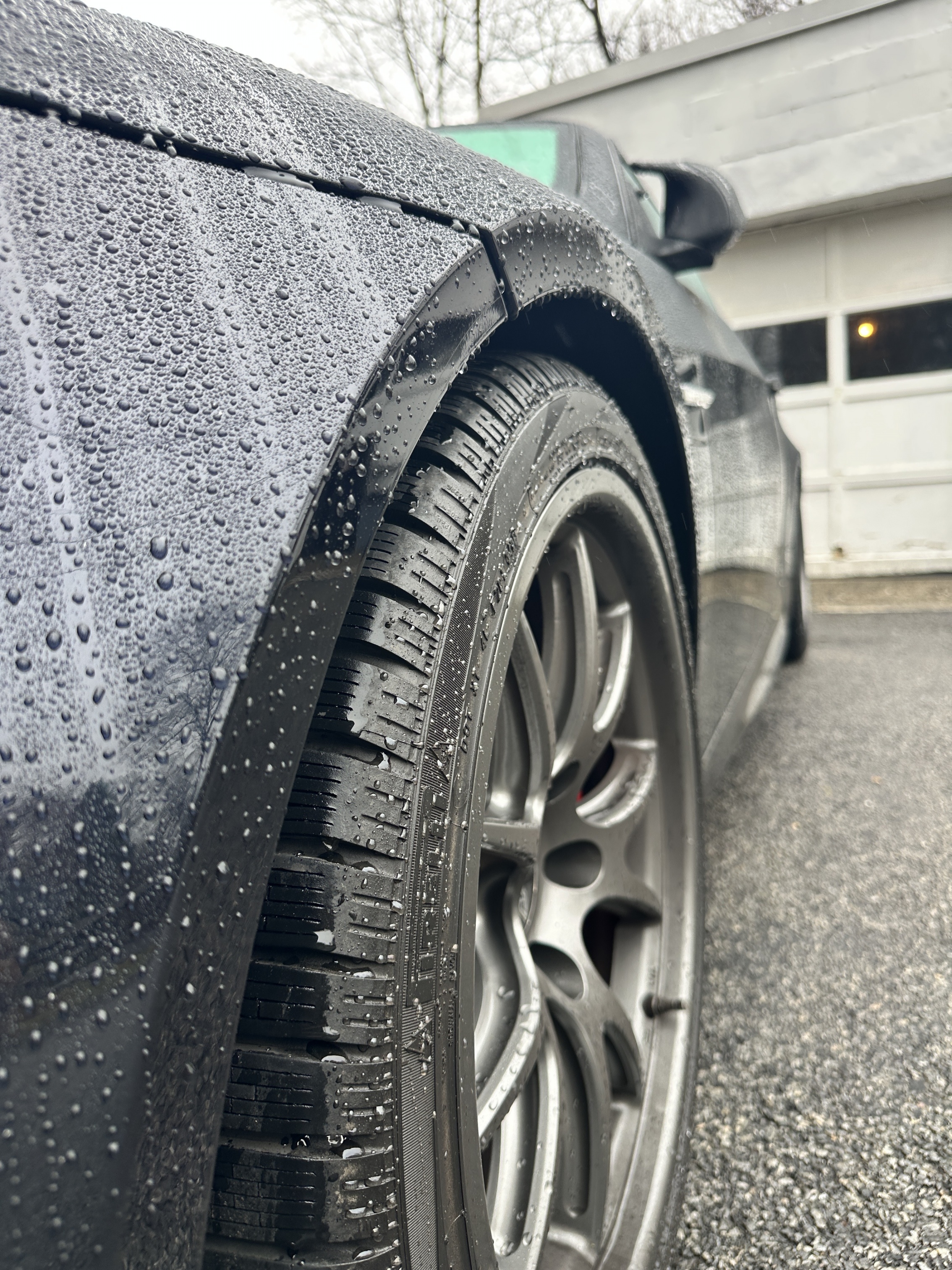

The second picture is a winter tire, correct?
I would go with a 275/35 front and 285/35 rear setup over the 265/35 and 285/35 setup. The 275/285 is close to a square setup so it’ll remove a little more understeer from the handling balance which is always an improvement. I wouldn’t look for a more square shoulder tire for street use. A square shoulder makes a tire have an abrupt breakaway characteristic when driven at the limit while a rounded shoulder is more forgiving and starts to squeal louder the closer you get to the limit.

To answer youre question you are Correct, winter tire on the front pic. She came back with her shoes miss matched 😂
