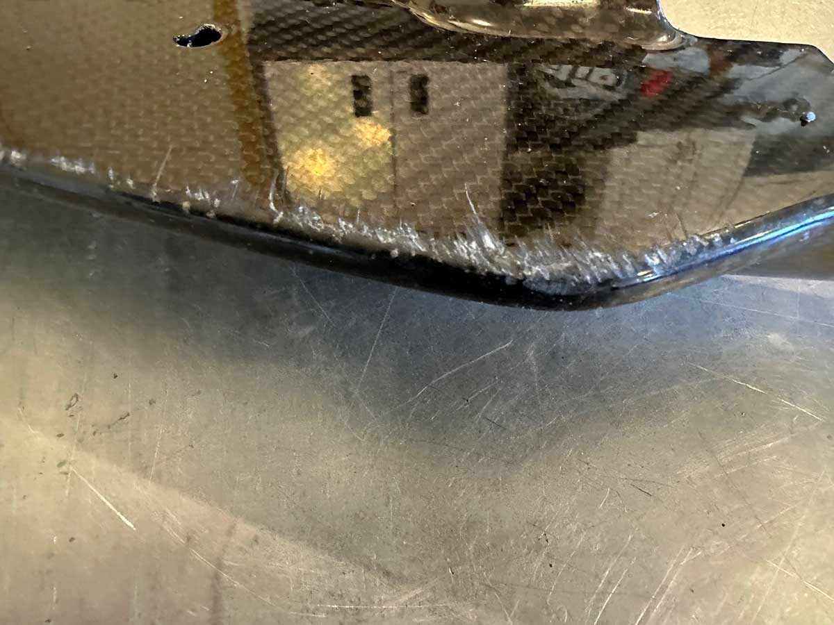

I rebuilt my CS spoiler due to damage. I did the carbon fiber repair but not the PPF but it cam out as good as knew so it's possable
Before
After
Looks great. Did you strip off the clear coat with sand paper and then spray with clear coat?

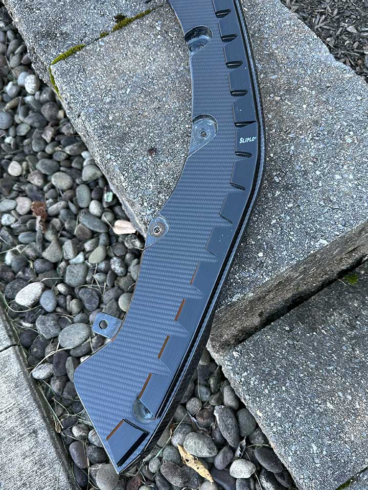

How are you finding the Sliplo, is it effecting in protecting the lip?

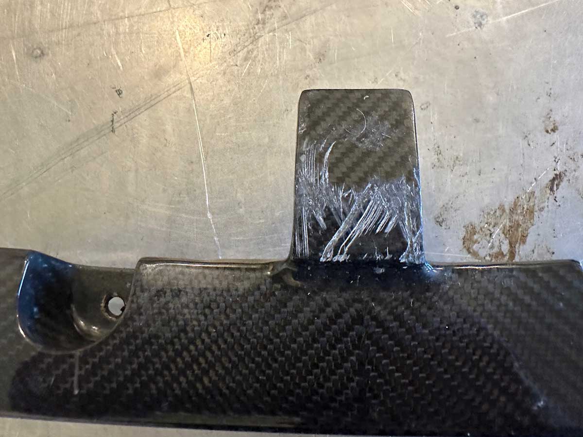

I only posted one before picture but the damage was extensive. I just roughed the surface and I did my repairs with sanding and resin. I recreated the Carbon Fiber look with paint and tooth picks on badly damaged sections.
Here is one trick I learned. A hex drill bit will remove the stone chip damage and leave good edges. Fill dimple with resin, sand.
I didn't finish with resin top coat as it's too complicated a shape. I used sandpaper from 400 working to 3000. I compounded and polished before taking it to the PPF installer
The Sliplo's are holding up great but they do remove a little of the already limited ground clearance.
Hopefully the PPF keeps it more protected going forward. You did such an amazing job it would be annoying to have to do it again but sounds like a fun project.
I'll keep that trick in mind, when getting my windshield repaired the guy does the same thing, drill and then fill.
What resin did you use?
400 to 3000, is 400 too coarse or is it a good starting point? I watched some videos of cf repair and was concerned that 400 would take off too much but I am a complete newbie when it comes to this stuff so I don't know anything.
Hilarious profile photo btw
I don't want to do it again. :sigh: I wanted to keep the car OEM or I would just have ordered a $1200.00 knock off. The culprit is trailering the car, it is hell on spoilers and I'm done with that.
I didn't figure out the drill and fill until I was under the gun to keep my appointment with the PPF installer. For stone chips, you can't beat it. The white that shows is damaged resin not the carbon fiber. Get rid of the white and fill and then do standard paint correction technique.
As for Sand paper, like paint correction anything you do you have to fix. :sigh: If you can get the surface repaired with 600 then that what I would start with.
My damage was 400 level damage :sigh:
I used standard over the counter resin and hardener.

I think the best we can do is PPF the lip, stick on Slip Lo underneath and hit the bumps and ramps at an angle.
I noticed you also only stick one row of the Slip Lo on your bumper. Do you think it would make a difference attaching multiple rows to basically cover up the whole bottom of the lip like how they have it in the marketing photos. Obviously they want you to do that to well more product but I can see putting some on the rear of the lip helping
No if it going to hit the row I have the second row won't help IMO.

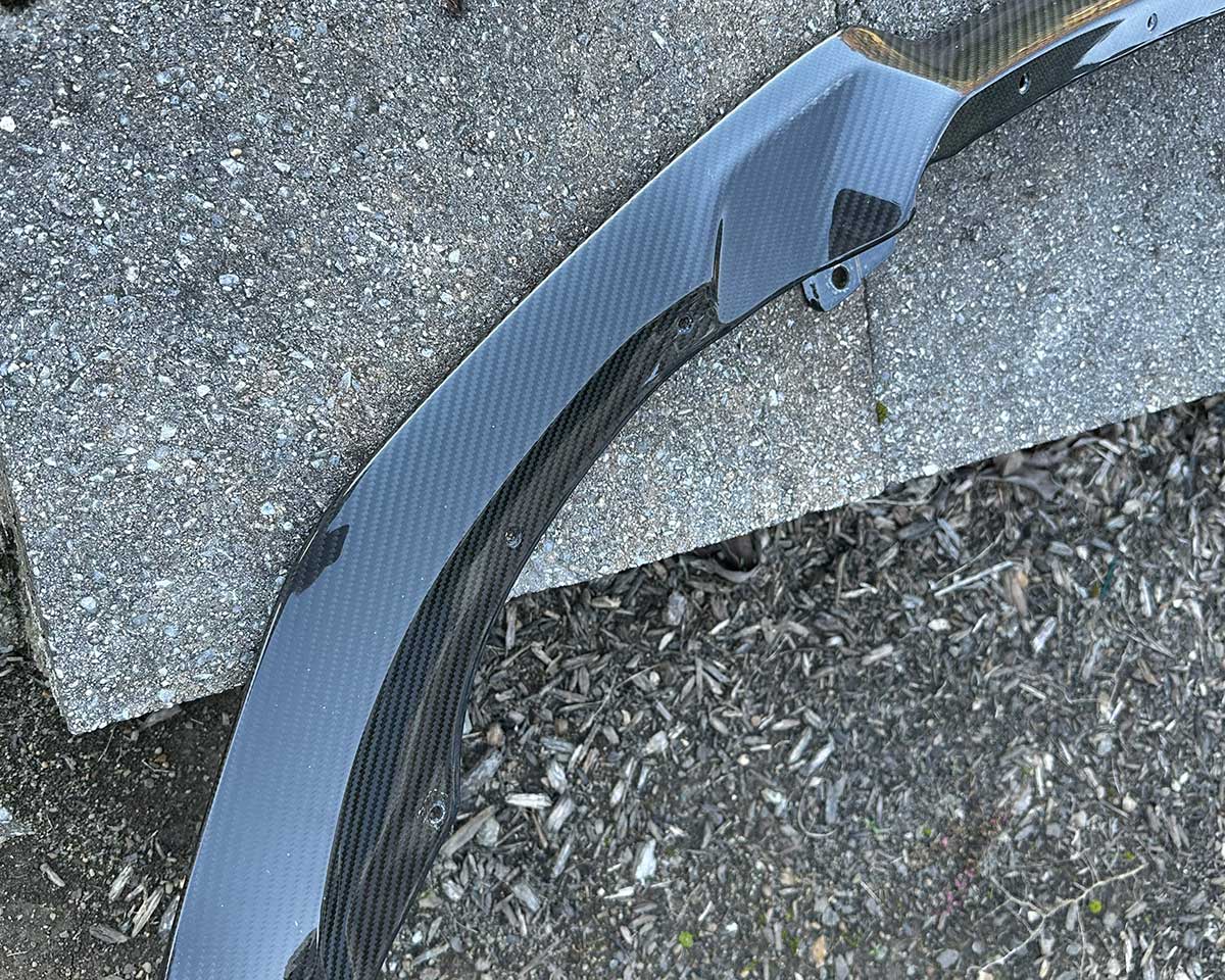

I installed the Autotecknic CS lip last night after work, and it turned out great.
Initially, when I bought the lip and held it against the bumper while holding it flush against the center, there was a massive vertical gap — about 2 inches — between the tips of the lip and the sides of the bumper. I was so frustrated about paying the Autotecknic markup that I thought I should have just bought an Alibaba part, since at the time it felt like the fitment would have been the same.
After installing the OEM brackets (L, R, and Center), the lip sits flush against the car and I didn't bother adding the extra screws to my bumper. The lip lines up almost perfectly. Without the L, R, and Center brackets, the fitment would have turned out horribly.
When I got the lip, I had my PPF guy PPF it using a CS Lip cutout. I asked him to extend the edges so the PPF wraps around about 1cm underneath the lip. I let it cure for a few days, then applied Sliplo along the entire bottom edge of the lip. Gave it a few more days before installing. I installed Sliplo over the PPF.
One thing to note: my PPF installer noticed a few flaws in the Autotecknic lip — the front leading edge is very slightly wavy and not a completely smooth line. When you run your hand over the edge you can very slightly feel it however visually its hard to spot unless you look at the lip from certain angles.
