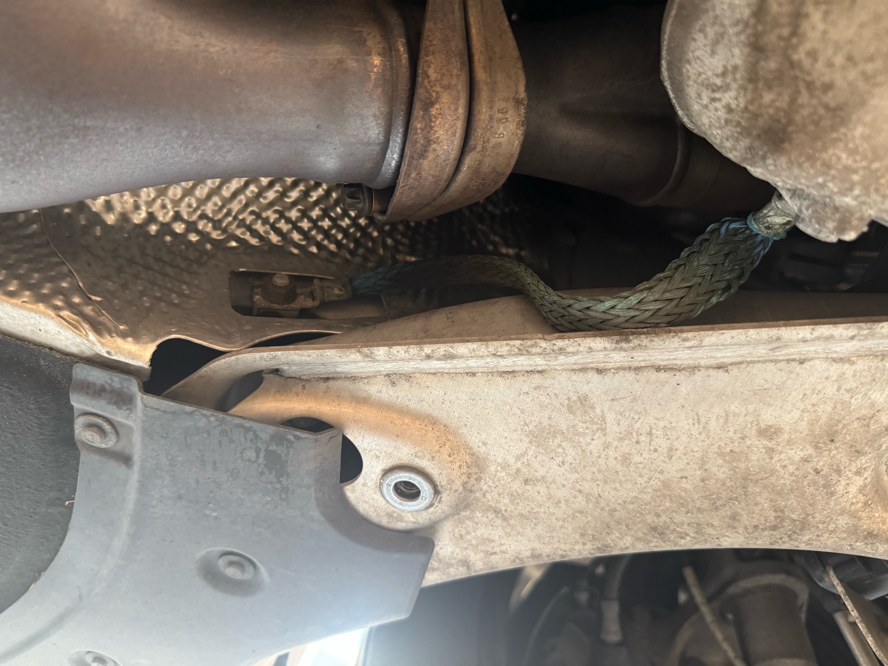

I suspect ground strap. How do I even go about fixing something like this? There are more than one ground strap correct? My exhaust one non existent but I hear those aren't important.
I'm thinking maybe the main one near the collector under drivers side? Or maybe whatever other one there is?

The ground strap nearest the driver’s side header is easily accessible once the belly pan is removed. I replaced mine after a persistent slow start-up despite a new battery, and it was indeed the solution.
There's two additional ground straps on the rear exhaust. I would say these are important as the redundancy is crucial for any compromised connection.

Thanks i will try to replace all of em
Taking them all off and cleaning the ring terminals with a wire brush might help substantially as well.

Not sure what to do now. Maybe i need to ground the exhaust too, not really sure.
Yeah look at the rear muffler section of your exhaust. There's supposed to be two ground straps. Confirm they're there and not crusty.
Look at #10.
Look at #10.

Not: ideally the ground band you want to replace is the interference suppression band that is inside the engine bay if static is the concern, but replacing all the grounds is good practice since they are cheap and easy to do.
I believe its the cable from the hood to the chassis, driver side.
Ya true. There's also a ground strap on the hood. Also on some boot lids.

Thanks I ended up trying this but it didn't do much. I don't have the problem really anymore unless I have my little bluetooth to aux thing plugged in to charge it, and even then it's not as bad as it used to be. I still think it's probably a grounding problem with the exhaust.
My hood grounding strap was in perfect condition.
