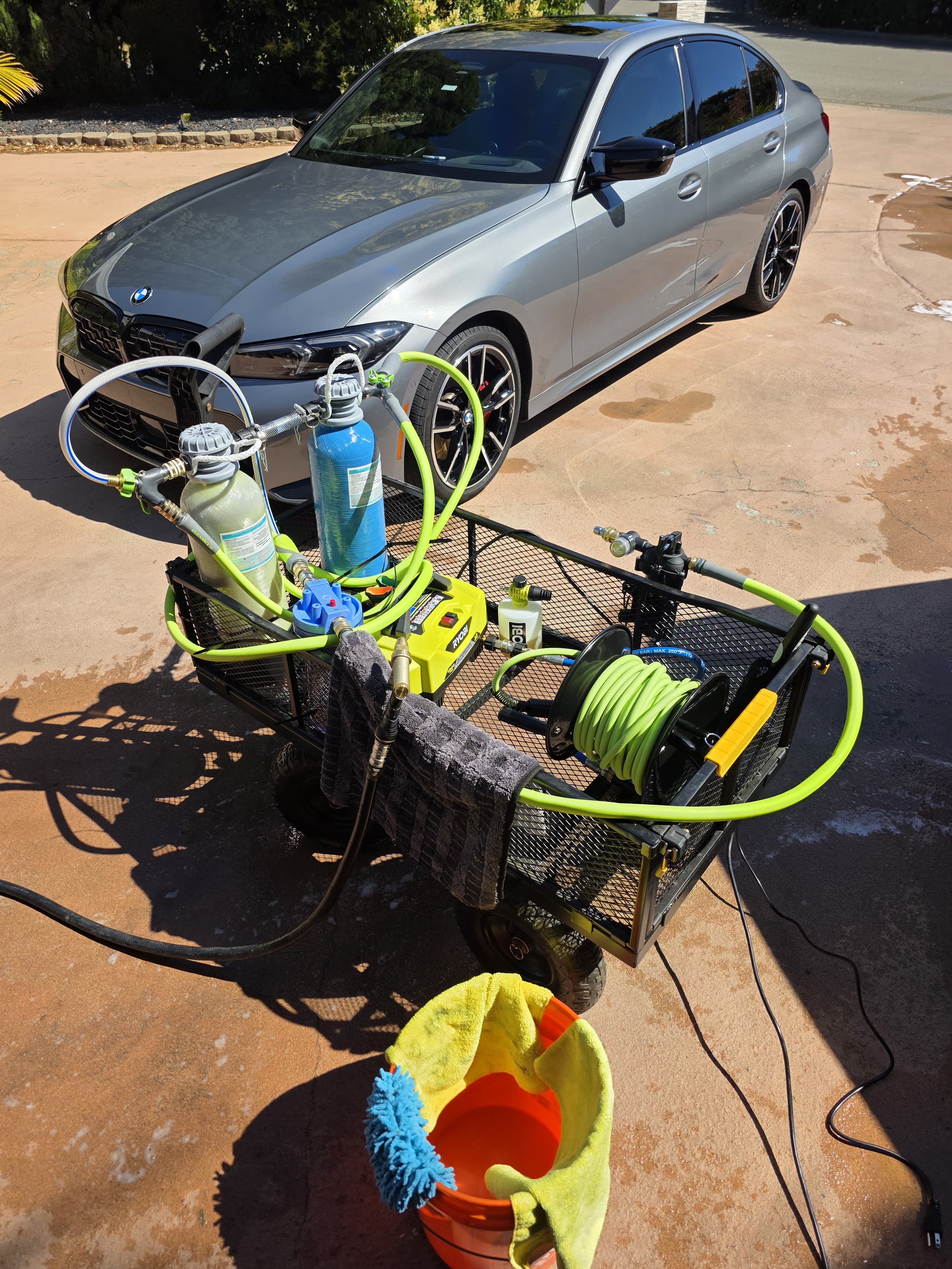

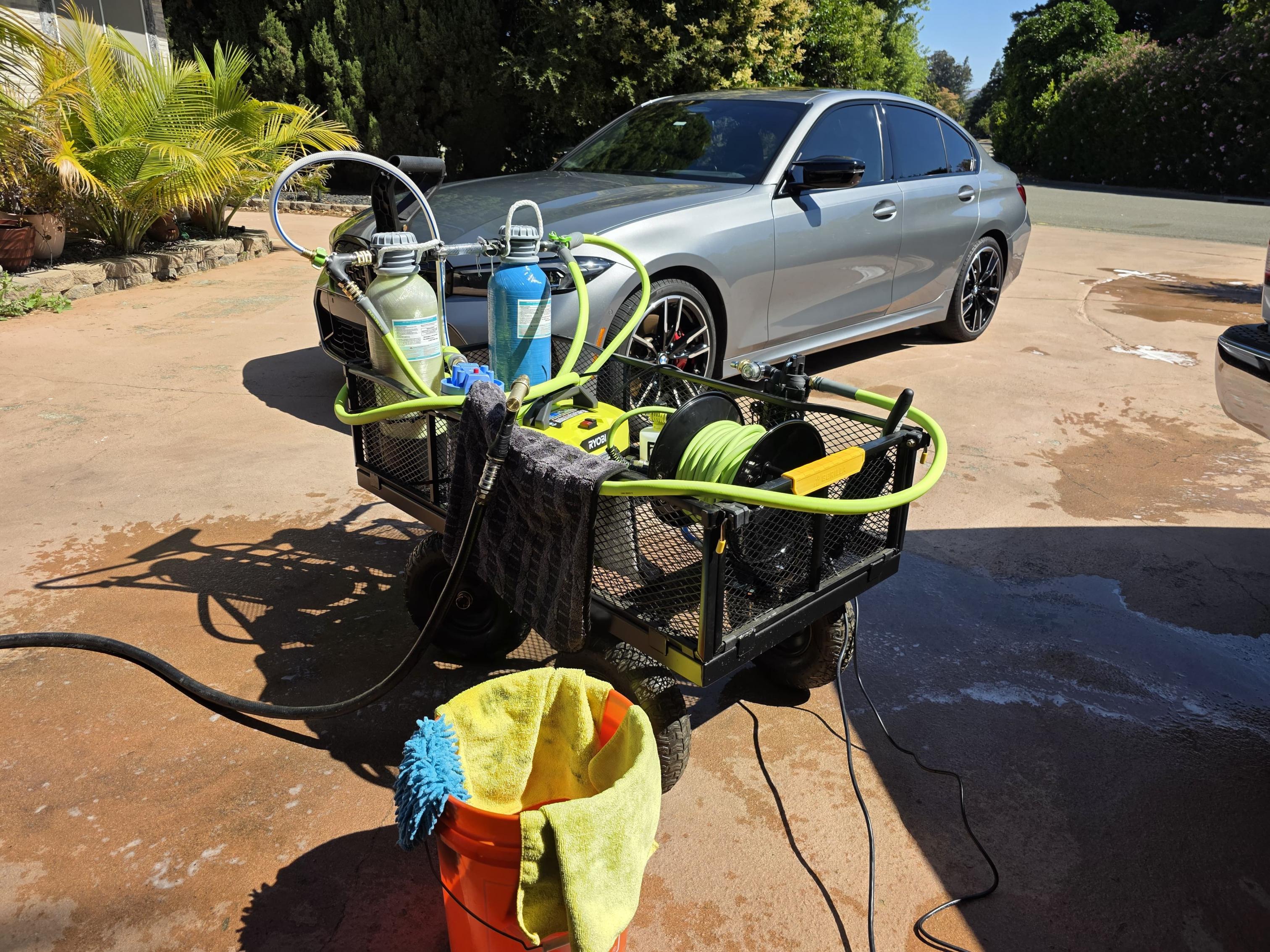

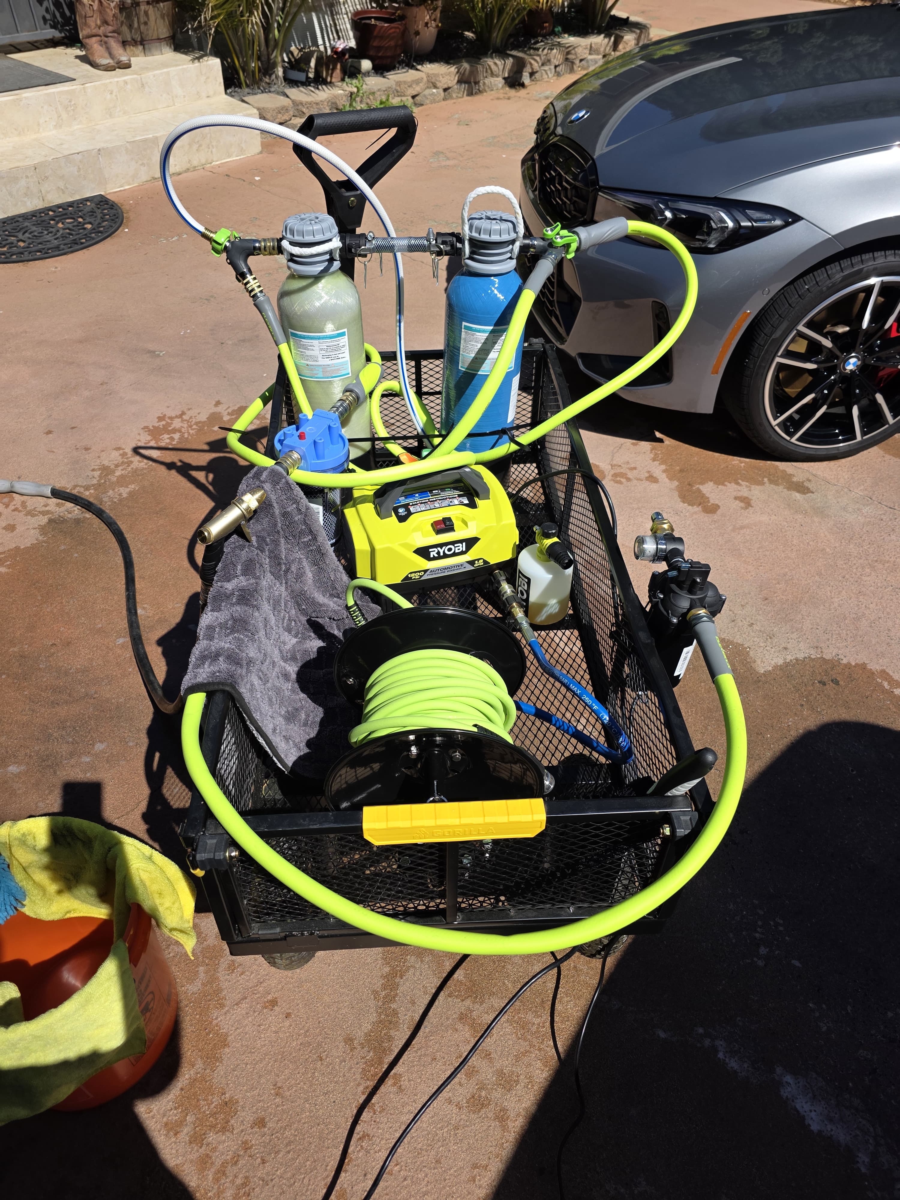

For anyone interested, here's the package I landed on (I tidied up the hoses after snapping pics) - Having it semi-permanently installed on a garden cart allows me to roll the whole setup around, from garage to driveway, to backyard, so I can do cars, windows, and solar panels. Ended up spending more than I'd anticipated on jumper hoses and garden/pressure quick connects, but it's pretty awesome to be able to instantly pop any nozzle or the wash setup on any hose around the house.
Once I got all the connections wrapped up in Hercules Megatape, there were no leaks - not at the pressure booster pump, either of the filters, bypasses, or any connections. It took about 5 hours, total, to get everything hooked up and arranged in a way that's minimally difficult to move, adjust, or hookup/disconnect... I'm pretty stoked with it how it all turned out, now.
I'll be tweaking it over the next few washes, so that I have everything needed for routine washes all loaded into it, at the ready, as soon as things are plugged in: roll the cart out, pop off the nozzle from the hose, plug hose into the booster pump, and plug in the booster/pressure washer to an outlet and it's ready to de-funk!
