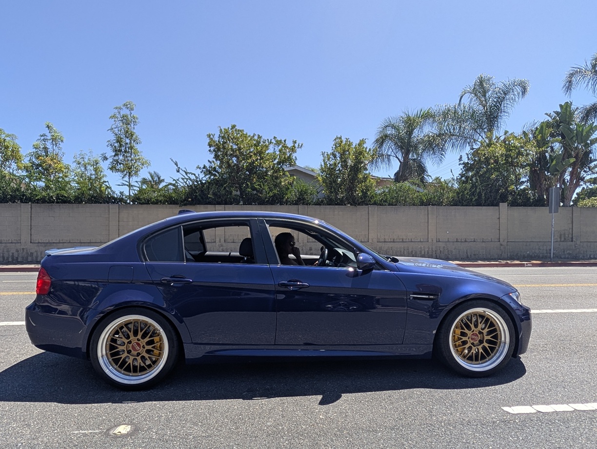

This is my 35th BMW and 12th M car. I always had a thing for s65 in a 4 door form and I recently found one in IB. I wanted a slick top and a manual in IB, but I got a DCT with a sunroof. Can't complain.
I did a ton of stuff in the first month and looking for recommendations on what else I should be considering.
Engine & Valve Train
Replace aluminum valve cover set
Replace valve cover gasket kit
Upgrade VANOS covers to billet chromoly units
Replace spark plug tubes
Replace all 8 spark plugs
Fuel System
Replace all 8 fuel injectors
Replace fuel injector hold-down clips
Replace fuel tank breather/purge valve
Throttle System
Replace both throttle actuator units
This was the primary issue causing the engine malfunction and DSC fault.
Cooling System
Replace water pump
Replace thermostat
Replace coolant temperature sensor
Replace coolant expansion tank with level sensor
Replace upper radiator hose
Replace lower radiator hose
Replace expansion tank hoses and associated O-rings
CSF Radiator
Engine Mounts
Replace both engine motor mounts
Belt Drive & Charging System
Replace drive belts
Replace belt tensioners
Replace idler pulley assemblies
Replace accessory pulleys
alternator
Oil Leak Service
Replace oil filter housing gasket
Replace front crankshaft seal
Replace oil filter
Replace harmonic balancer mounting bolts
DCT Transmission Service
Replace DCT transmission fluid
Replace DCT suction filter
Replace DCT side suction filter
Replace transmission fill plug
Replace DCT oil pan
Replace oil pan bolts
Replace DCT suction jet pump
BMW M3 GTS DCT Flash/Tune
Mods:
Ohlins R/T Coilovers
Macht Schnell Mid pipe with PLM HFC
Valvetronic Catback
BBS LM's with 295/265 Tires
Brembo BBK
She feels very strong, but I am pretty sure there is something I missed. Suggestions or recommendations are welcome.
Looks great! The Ohlins R/T are a great setup, if the mileage is up there, may want to look at other suspension components and bushings for upgrade/replacement. RB's done already? Looks like you knocked just about everything else out though, that's a long list!

Oh yes, RB's were done by the previous owner.
Suspension components are next on the list. Is FCP a good source?
What a restoration. Love the look, the LM’s and how you went about the work.
The car looks stunning, the work done is impressive. This one clearly ended up in the very right hands mate!
