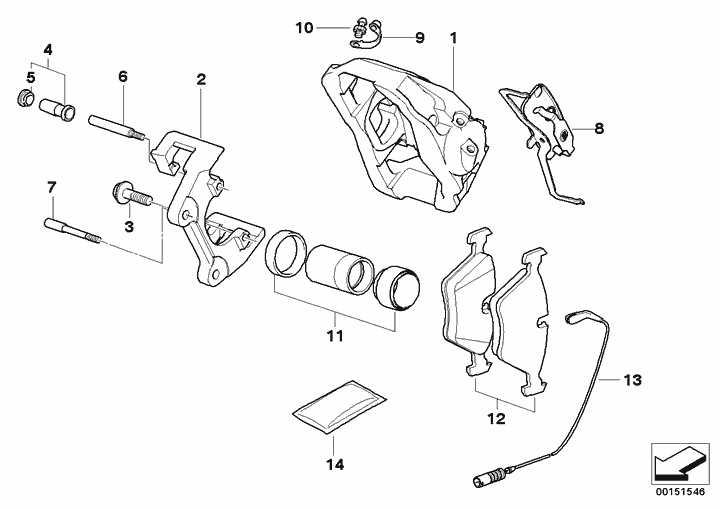

Here is the schematic for the front caliper assembly. What you will be doing is to unbolt the caliper housing (#1) so that you can remove and replace the pads. The caliper housing is bolted onto the carrier (#2) by two retaining bolts (#6 and #7).

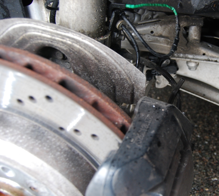

STEP 1: Remove the pad wear sensor. It is clipped onto one of the brake pads. Just pull on it and it will come out. The chances are the tensioner clip will remain in the pad. Make sure to get it. They are not sold separately, and if you lose it, you'll need to buy a new sensor. Also, you can release the fluid line from the suspension to give yourself some more room.

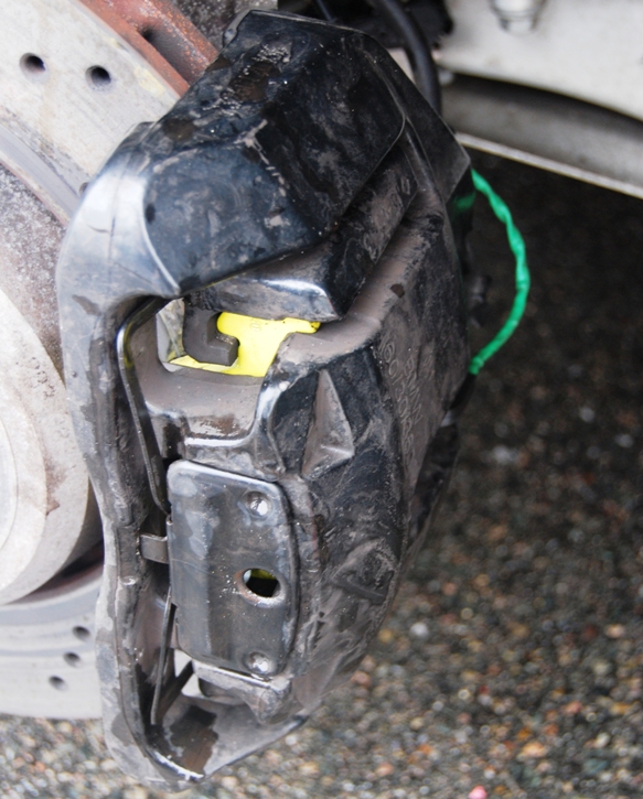

STEP 2: Remove the large anti-rattle spring (#8). I use a couple of sturdy screw drivers to deflect and snap it out of place. Do not use your fingers; you'll get hurt. Also, there is a good chance the thing might come flying out, so don't be staring at it. Wear goggles if you are concerned.

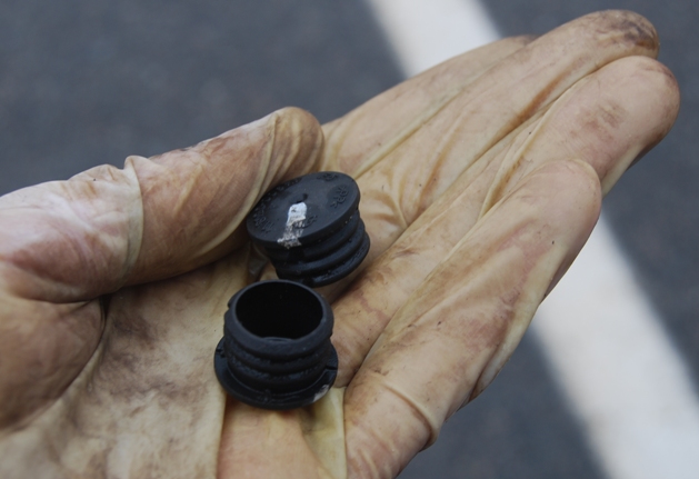

STEP 3: Remove the 2 plastic caps (#5) that are protecting the retaining bolts. You should be able to do this with your fingers. If you can't, use a screwdriver. The caps look like this:

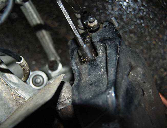

STEP 4: Now you have access to the retaining bolts. Insert the 7 mm allen wrench as seen in the pic below, and unbolt them.
A more detailed view on the wrench inserted in to the retaining bolt:

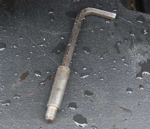

This is what the retaining bolt looks like if you were to slide it out of the caliper housing. You don't need to do that. You just need to unthread it.

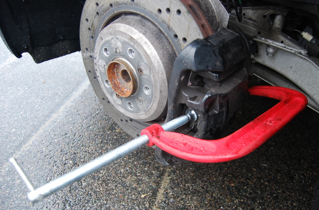

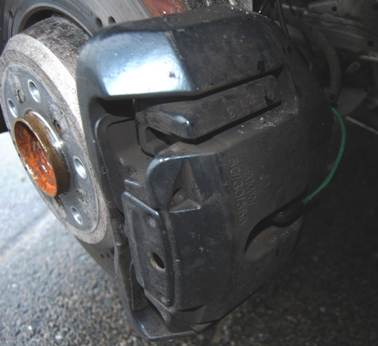

STEP 5: You now need to push the brake piston back. You can do this while the caliper is still on the rotor, or if you have a piston retractor tool, you can do it after you remove the caliper housing. I'll show you how to do it with a c-clamp while the caliper is still on the rotor. Place one end of the c-clamp onto the pad itself and the other end on the back of the caliper housing. Be careful not to place it on the bleeder valve or the fluid line or anything else that can be damaged. Find a spot on the cast housing itself as show in the pic. Slowly contract the c-clamp. You will see the caliper housing move away from the rotor and toward you as the piston goes back in. This should not require too much effort. If it does, you are doing something wrong. When the piston goes all the way back in, you'll feel a distinct change in resistance, so stop. Also, keep an eye on the brake fluid level in your reservoir. As you push the piston back, it will rise slightly and should not be allowed to overflow.

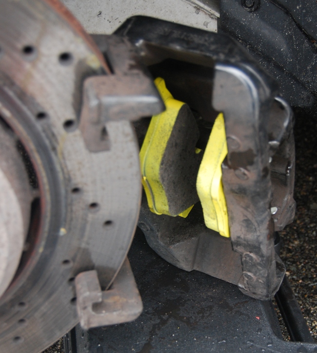

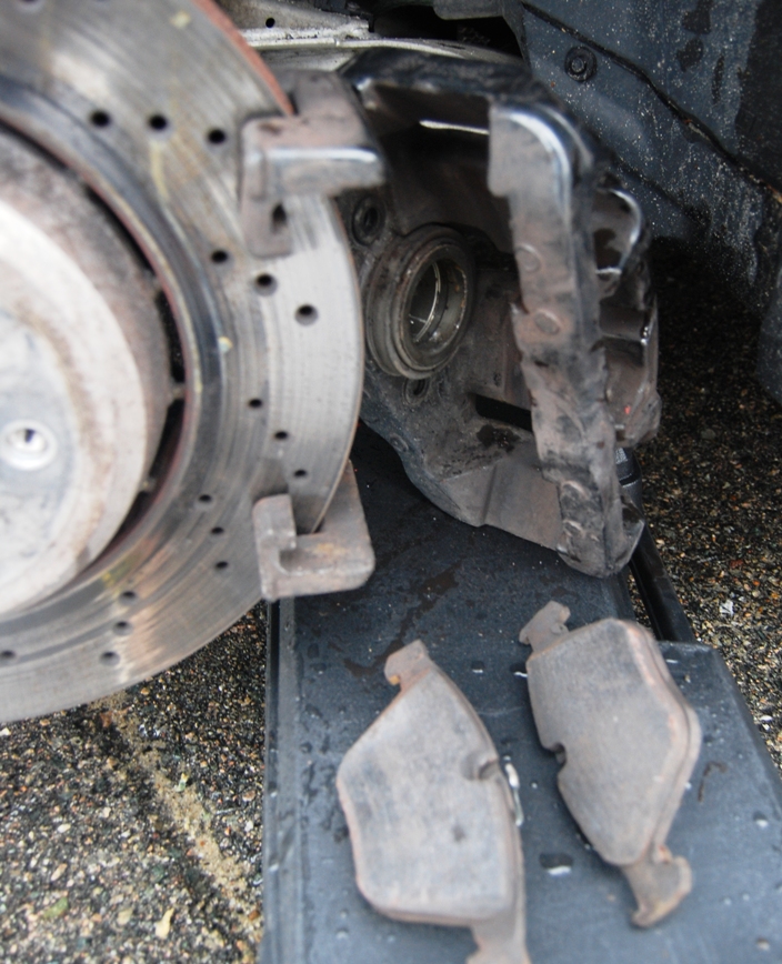

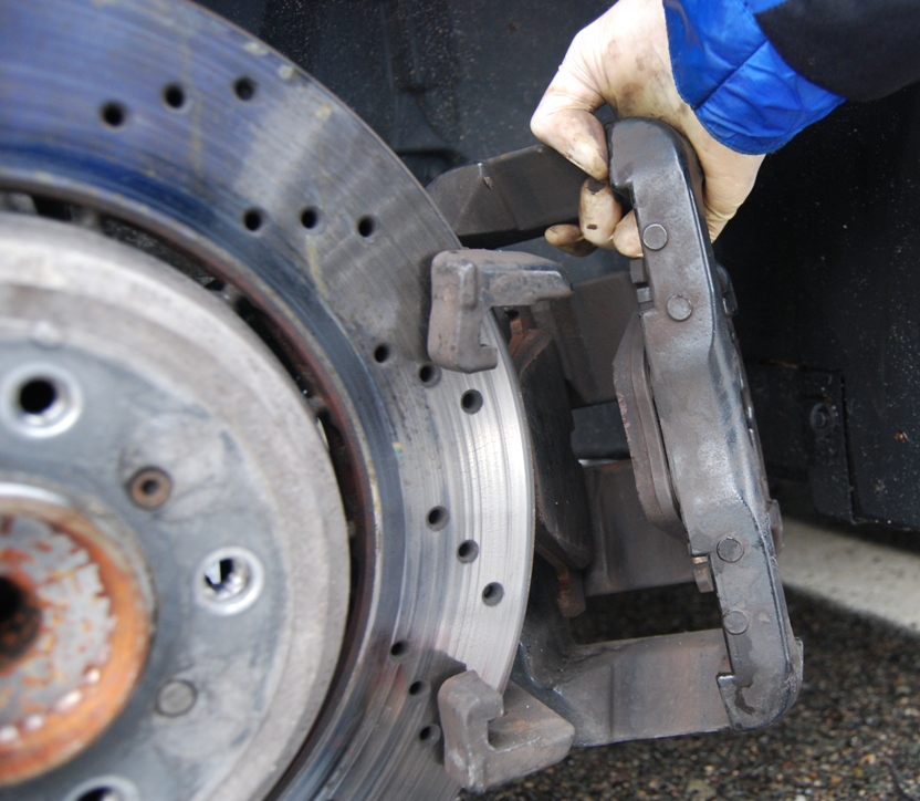

STEP 6: Grab the caliper housing and move it away from the rotor and the carrier. Be careful with the fluid line. Don't yank on it. Do not try to rest the caliper housing on the ground; you will stretch on the fluid line. You need to put something under it to support it as seen in the picture below. I was using my jack container.
STEP 7: Remove the pads. They are held in the caliper and the piston by tensioner springs at this point and will come out when you pull on them. Here you can see the caliper housing with the piston pushed almost all the way back.
STEP 8: Clip the replacement pads into the piston and the caliper housing.

The easiest way to get the front anti-rattle clip out is with a giant pair of water-pump pliers. Cover the jaws with tape to avoid scratching the paint and just stick one jaw through the hole and the other jaw on top of the caliper body. Squeeze gently and the clip just slips out.
BMW recommends an anti-squeal compound (#14 in the diagram) for re-assembly. They say to put a thin (really thin) layer on anywhere there's metal-to-metal contact in the caliper assembly. Bostik Never-Seez is on their recommended list. It works great for stock pads, but RS-19's will squeal regardless of what you do.

Take a minute to observe the clips when you remove the wheels. How they are compressed will become obvious. You just need to apply force to further compress them and they will pop out. I use a couple of relatively big screw drivers to bend them around. Some prying might be necessary.

The rattle clip was indeed a piece of cake to remove: Just slide a screw driver under the large flat piece of the clip in the middle and pull away (from the center of the wheel) to dislodge the middle tab from the caliper holding feature.

- The M3 has a brake wear sensor on both sides in the front. That was a surprised to me. The E46 had it on one side only.
- The Carbotech pads do not have a recess in the pad material for the brake wear sensor. I wrapped the sensor cable about the brake line.

Second, my Carbotech's also had excess material in the space where the wear sensor goes. Just had to zip tie the sensor out of the way.
