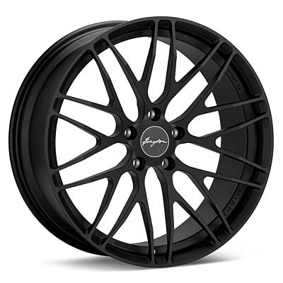

Tire Rack has these:
Breyton Spirit RS
Question 1 Can these weight figures be correct?
Question 2 Does anyone have these on there M3?
20x8.5
Offset: 29mm
Backspacing: 5.87"
Bolt Pattern: 5-120
Rec. Tire Size:245/30-20
Weight: 16.8lbs.
Breyton Spirit RS
20x8.5
Offset: 29mm
Backspacing: 5.87"
Bolt Pattern: 5-120
Weight: 16.8lbs.
Highly doubt 20's weigh 17lbs
